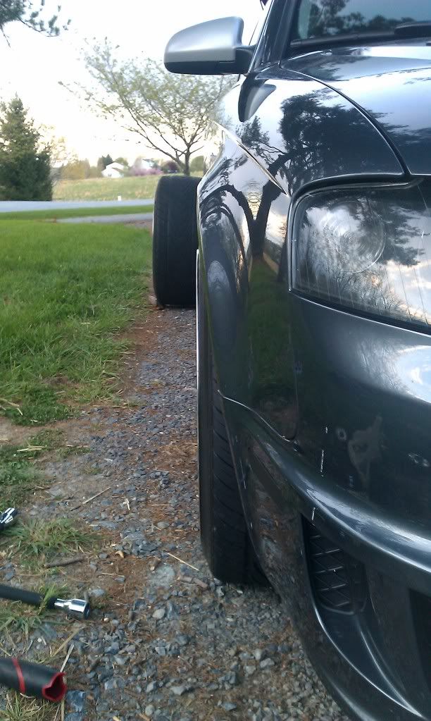

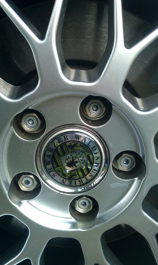

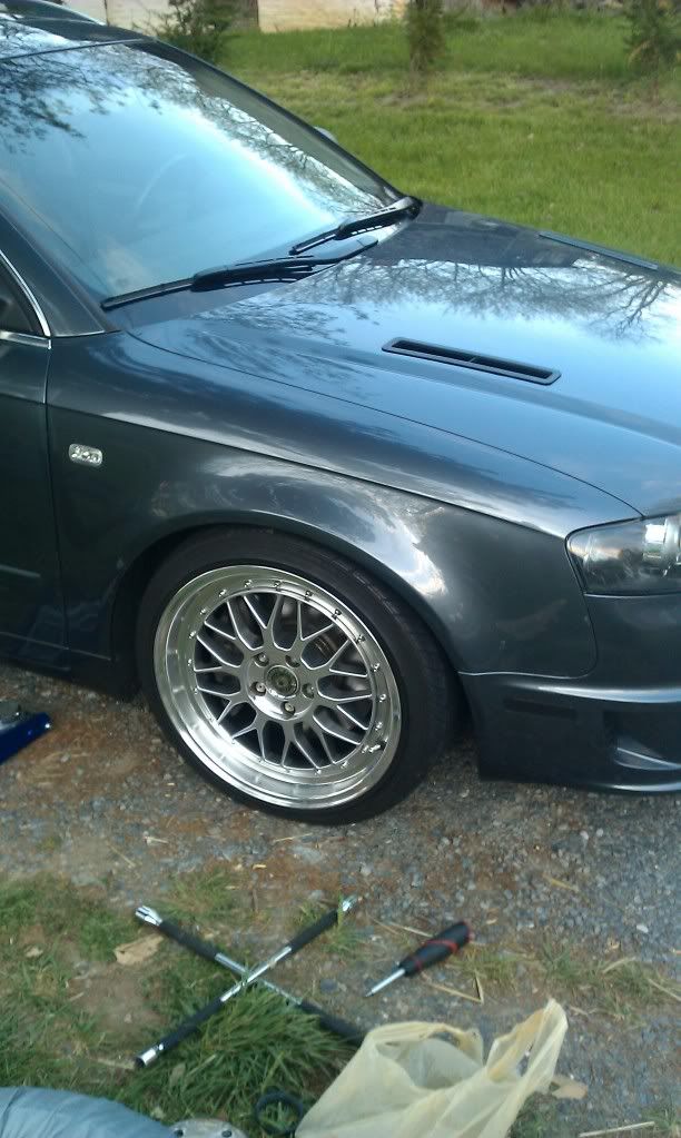

    Test fit,
    though fitment isnt perfect. I need some beefier spacers as they rub on the front caliper, that or grind down the caliper a bit. This test fit I actually stacked two 8mm spacers and I'm not comfortable running that permanently. While I could probably get away with it, I'm not sure I want to risk it.
    Here's the studs, shouldn't i have some threads showing? I don't know the rule for number of threads with studs and wheel bolts.

    calipers ground down, wheels fit.

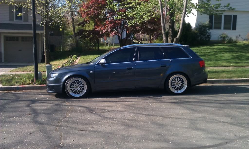

    I think this is the first time I've found a picture someone else took of the car. This is from the sandy point gtg earlier today

    Quote Originally Posted by SykoraA4 View Post
    Personally, I would not feel at all comfortable running with anything less than all the nut threads seating on the stud and a little extra like in the pic below. Just look what happened to Operator's back wheel. He didn't have enough thread, and the wheel fell off!

    Quote Originally Posted by swoardrider View Post
    Since grinding the caliper a bit I no longer have this issue. the studs go all the way through the nuts with a few threads exposed. I feel a lot better about it now then i did when i took that test fit picture. Operator's experience freaked me the f out, and I've been chronically checking everything since then. So far so good.

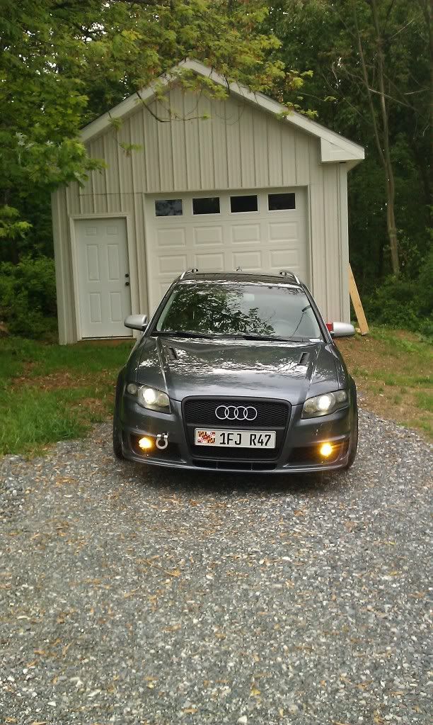

    Fogs: success
    LED turnsignals: Fail...
    now I have no front turn signals. fml.
    - Will
