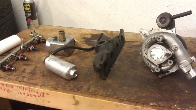

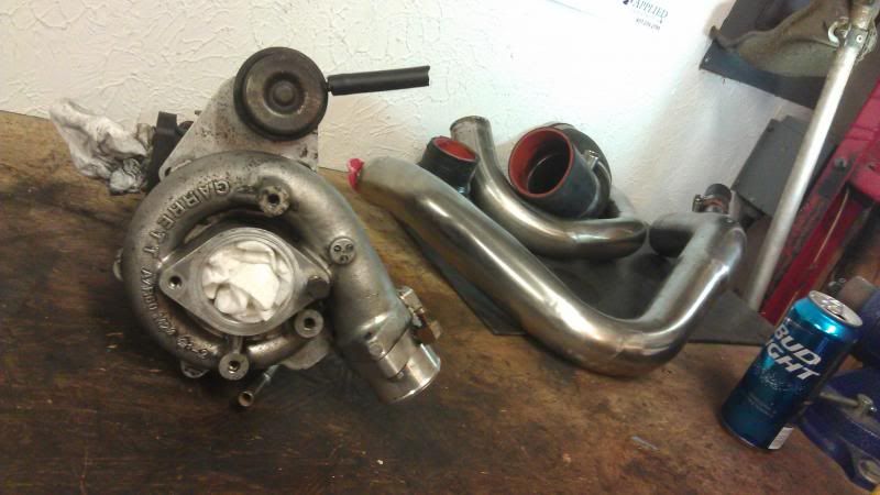

    What would be ideal boost to run at with this turbo and stock manifold?
    2001 Ausi A4 Quattro- Bone stock for now!
    2004 land rover discovery II 2" rte lift
    2001 trans am ws6 cam headers all bolt ons beafed up valve train.
    1999 audi b5 a4 gt28 http://www.audizine.com/forum/showth...-Gt2871r-build (SOLD)
    2004 audi s4 (SOLD)
    Veteran Member Four Rings Raacerx's Avatar
    Mar 22 2009
    40238
    ex B8.5 SQ5, ex 8V S3, ex 8P A3 VR6, ex B5 STK S4
    Norcal
    Just rods, new bearings, a main stud kit, and you'll be able to support over 400whp depending on the fuel and turbo.
    Otherwise, if you're going to be doing new pistons or anything substantial like that...go 2.0L. It's a huge difference, way more than you'd think, but a bit overkill if you're sticking with the Elim.
    That 2871 should get you close to 300whp, depending on supporting mods. The Eliminator housing lowers performance a bit compared to a full frame GT2871, but its still big enough to cause risk to your stock rods.
    You'll definitely need a significantly stronger clutch, find out what style the SPEC flywheel is for (looks like a stock 228mm style to me).

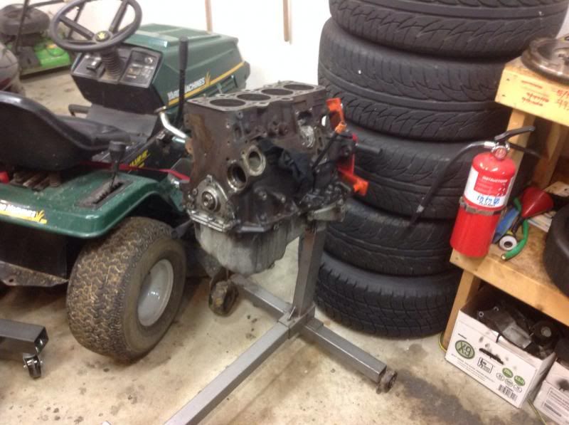

    Tearing down old motor found 1 thing so far. The oil pump intermediate shaft flange has a crack in it where the bearing clamps it to the block. That sucks.

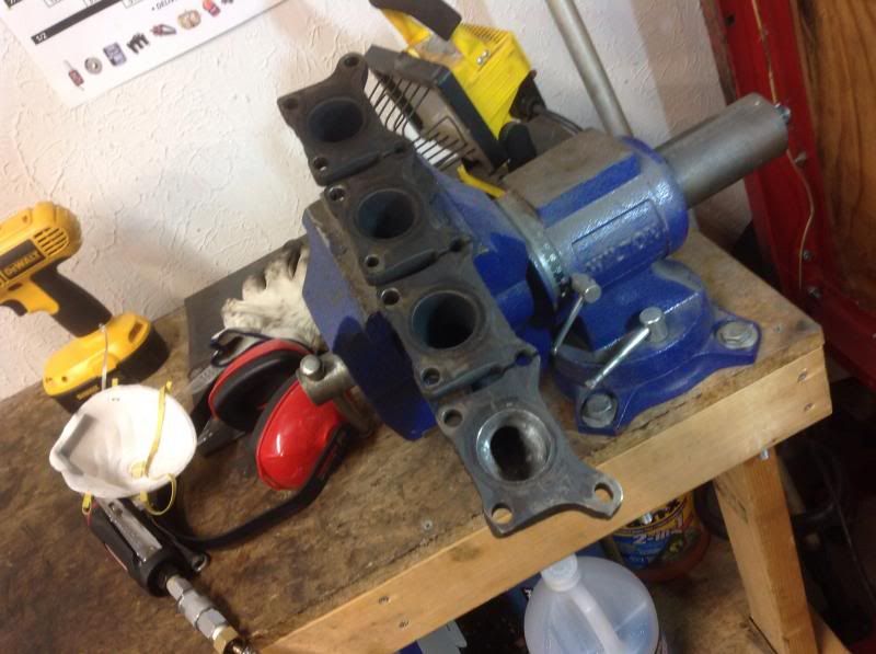

    I ran 22 psi on this turbo and stock manifold and it worked well. I have since changed to a Frankenturbo manifold and it definitely lets its breath more up top. I bought the manifold separate from Doug some time ago, I've heard he no longer sells it on its own but if he does it is well worth the $200.
    If your gonna stick with the stock, you could give it a nice port and polish job while it is off the car, but the runners are still pretty skinny.
    2016 S3
    Instagram- @Thisisastickup
    Oct 06 2013
    124450
    Cincinnati ohio
    Quote Originally Posted by b6Hate4 View Post
    Cool man thanks! After messing around with one of the runners porting it I was shocked at how much material I had removed.
