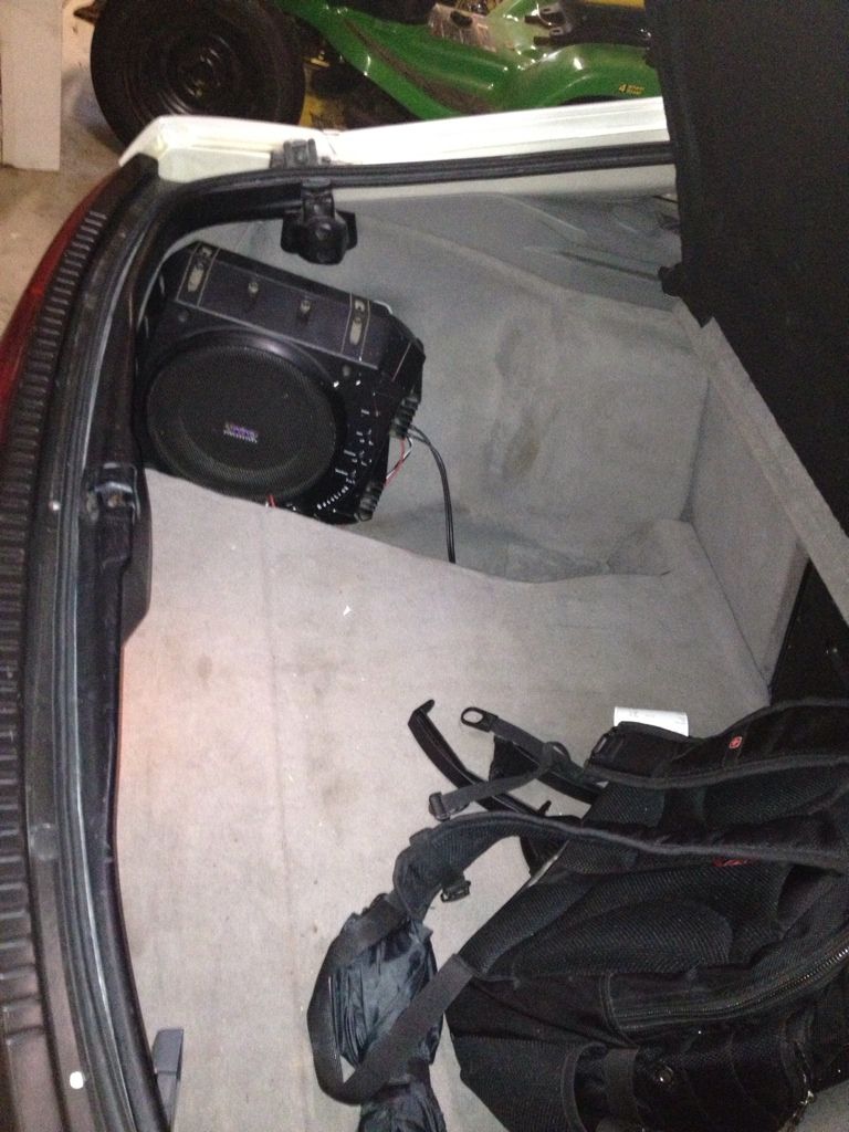

    Have also been refreshing the stereo. Won't be winning any audio contests, but should sound better than what I had.
    Original speakers were falling apart.
    So far I like the HU. Came with Bluetooth (phone and audio), hd radio, rear USB, pandora. And was very easy to set up. Choices are sometimes limited when you want something that allows the colors to be customized.
    Also installed an Infinity Basslink.

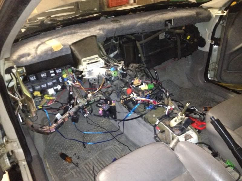

    Doing some work last night. Pulled the dash to fix/replace this list of things. My main goal is to get the air box and A/C working.
    * Heater core
    * re-foam the air box
    * install JHM short shifter
    * firewall gromet around the steering column (tired of all the heat pointed right at my crotch)
    * numerous dash switches that either don't work or bulbs are out
    Already got the short shifter in...
    JoshDub & Pry4sno - With all of the dash and center console out of the way, it literally took me more time to find the short shifter than to put it in. It doesn't appear to be hanging up on anything. My shifter only has one setting, btw. It feels very good when just running through the gears...very similar to the JHM shifter in my old B5.

    Fuse problem solved...
    Took me a while to put two an two together, but each time the fuse did not blow was when the knee bolster was removed. Strange occurrence, but I swapped in a cubby from an early coupe and one of the screws I used went too far into the dash and must have gone into the bundle of wires on this circuit, causing a short.

    Nice catch!
    Not surprising at all though... that's a veritable rat's nest back there.
