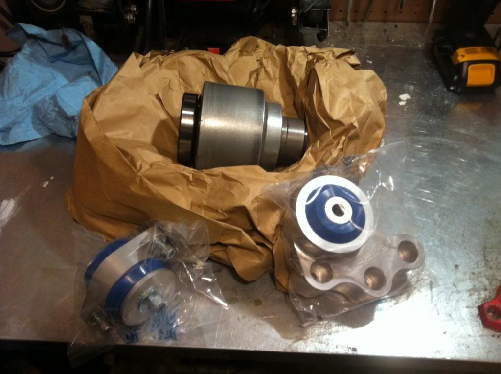

    •Apikol Snub Mount
    •Apikol Transmission Mount
    •Apikol Rear differential Mount

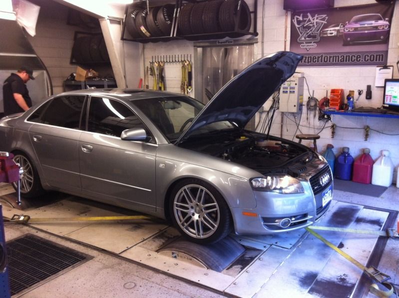

    Dyno Day, and it left me wanting MOAR!!
    226 AWHP/ 271 TQ corrected

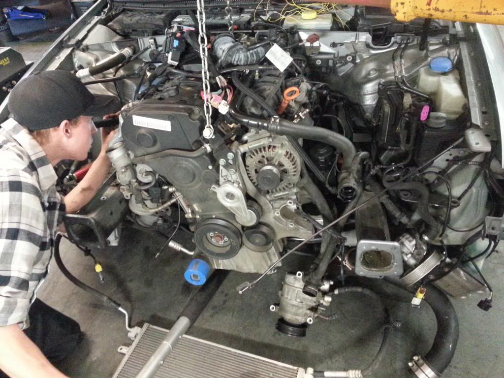

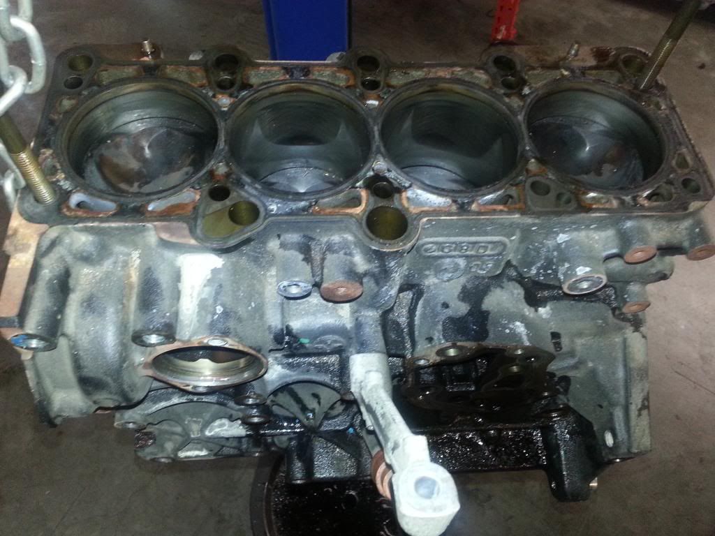

    Now the car is at Blue Water Performance getting IE Rods amd JE pistons and a bunch of other parts!
    As of 02/23/12 this is how the car is sitting. Waiting for the block to come back from the machine shop.

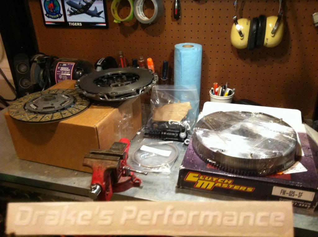

    Clutch Masters flywheel
    USP Metal Slave w/ SS line

    Hey thanks Flex, I'm actually have a machine shop Bore, plane, my engine.

    Got some MOAR parts in!
