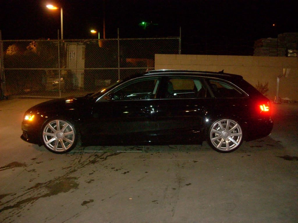

Wheels: OEM 2007 Euro A8L W12
Offset: +46 with 5mm rear spacers and 3mm front spacers
Tires: Nitto Invo 255/30/20
Suspension: H&R Coilovers
Fender Mod: I removed the front fender liner clip at the top of the front fenders as a precaution but other than that there was no modification done. I have 100% no rubbing at all even with a full car.
Thanks: OemPlus for quick delivery, Group 5 Motorsports for performing the machine work to fit the wheels, and to Wolfs9 for responding to my PM's despite copying his setup.
I just noticed you changed the LED taillight for your B8 A4 Avant.
I have the same car with u. And I bought a OEM LED taillight from eBay. Five local Audi engineer spent almost five hrs to try to install them on my car but the lights didn't work properly. I gave up and return the lights back to the Germany seller.
I am just wondering how can you fix that? Where did u get these lights and how can you let them dim?
Thank you. BTW I really like the LED taillight on the avant.
