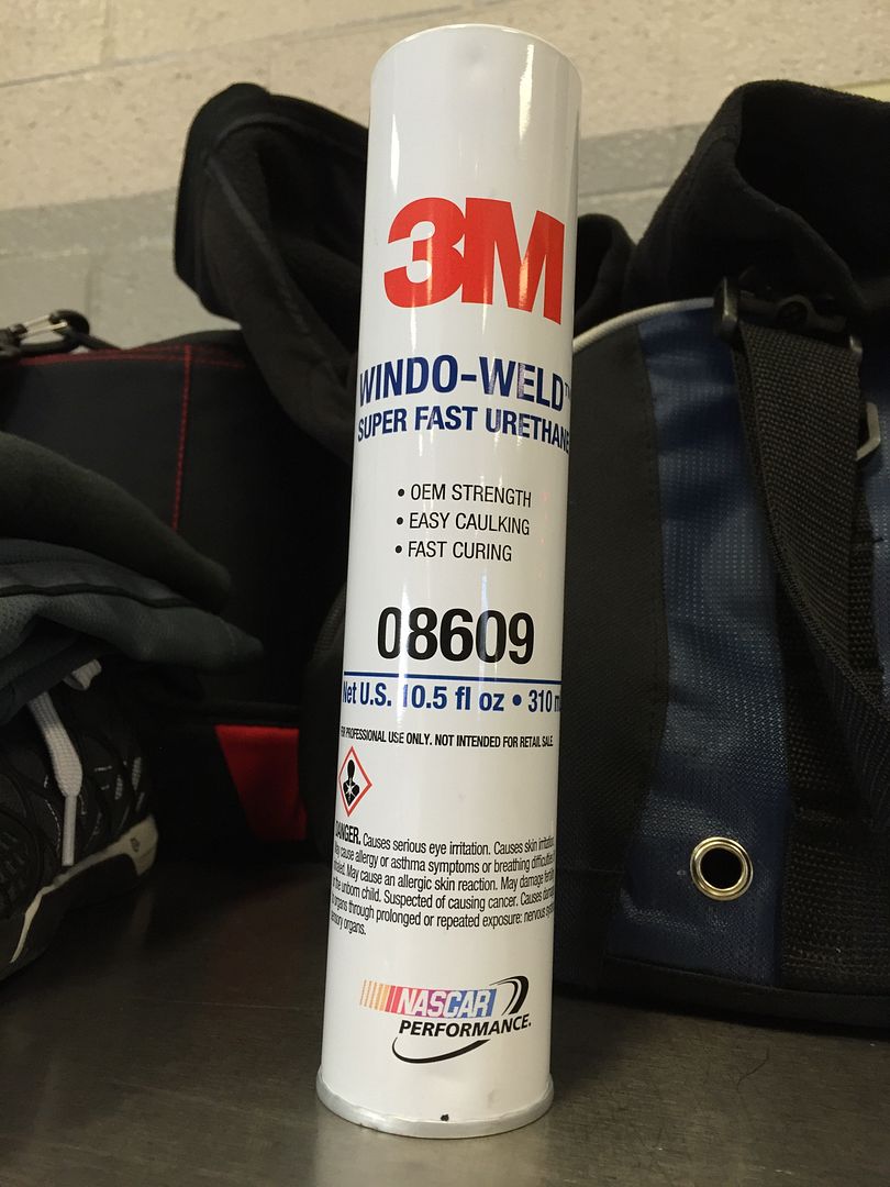

    Also, my rear diff mount was blown out. Ive built many B5's in my career and found I really didnt like the negatives associated with going sold mount. My solution, take a good stock diff mount and fill the voids with 3M window weld. Gave it a week to harden and boom, an upgraded diff mount without the noise/vibration of a solid mount.

    I used window weld on my old Honda builds, and I found that to add much more harshness than inserts. I'm anxious to hear how you like the diff mount. I've pondered replacing it with urethane but read all the horror stories about vibrations afterwards. I hope this turns out to be a good middle ground.
    Ive owned many B5s over the years and have done this to all of them, that video I made 2 years ago for my bigturbo A4 lol. Compared to the all the solid mounts i've installed this combo has been IDEAL.
