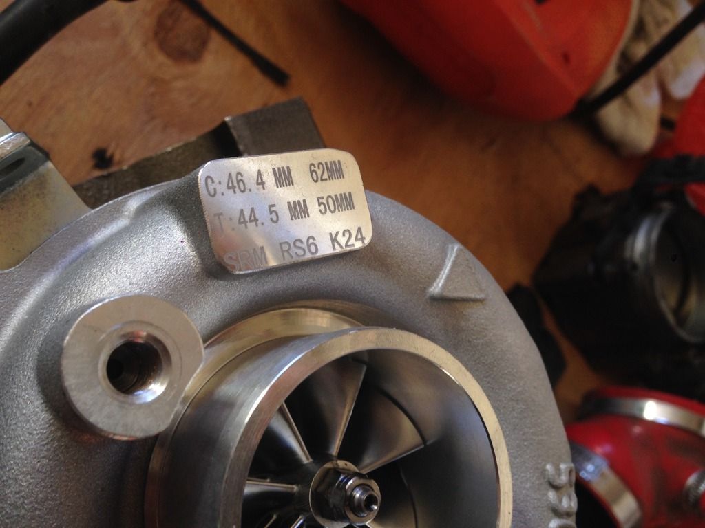

    SRM RS6 K24s!

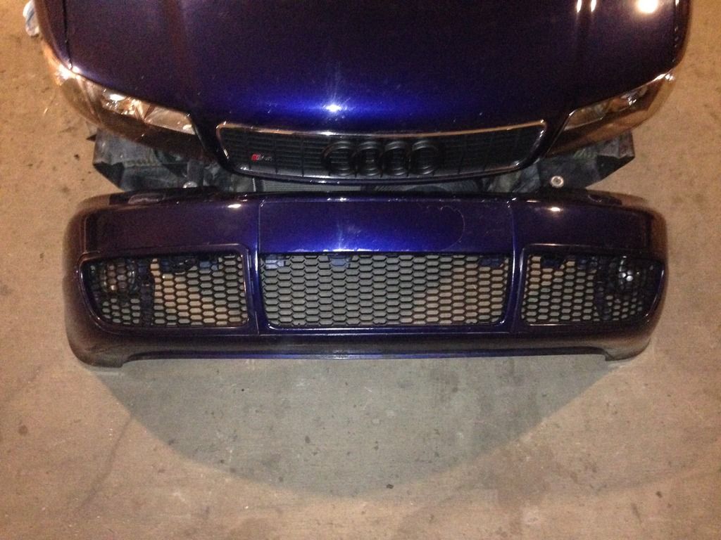

    RS4 bumper mod (I like the look of it, more subtle than a full RS4 front end.)

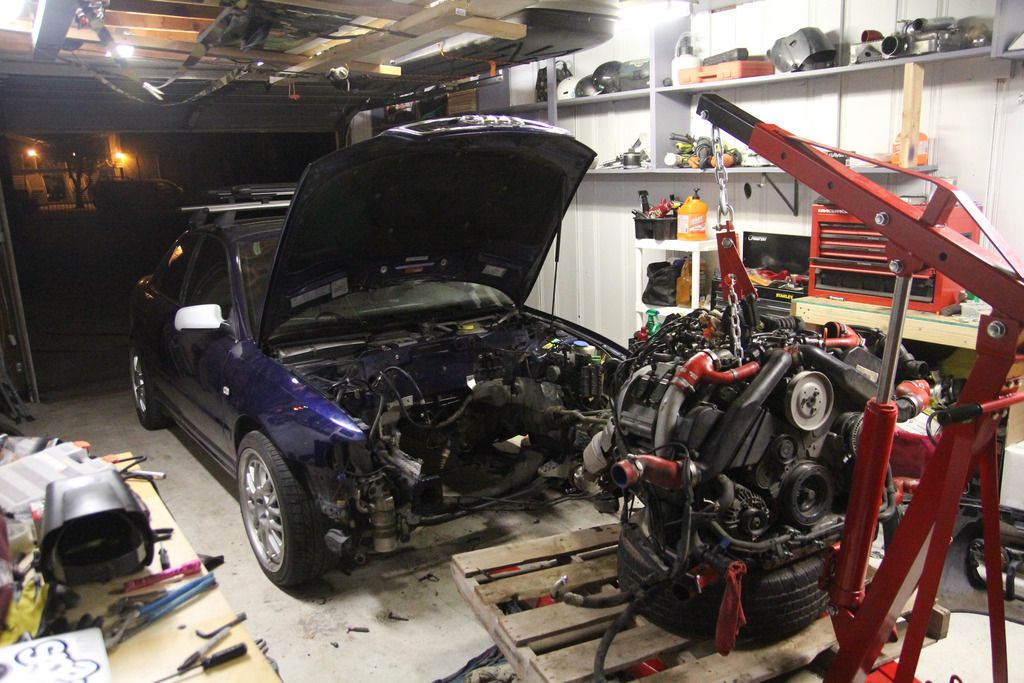

    Overall, the motor pull really wasnít that bad. It was my first time pulling a motor, and it actually went really smooth. It was just a lot of checking over little things. Took us about 3-4 hours total. Forgot to start the go pro at the beginning, oh well..
    Timelapse of the motor pull:

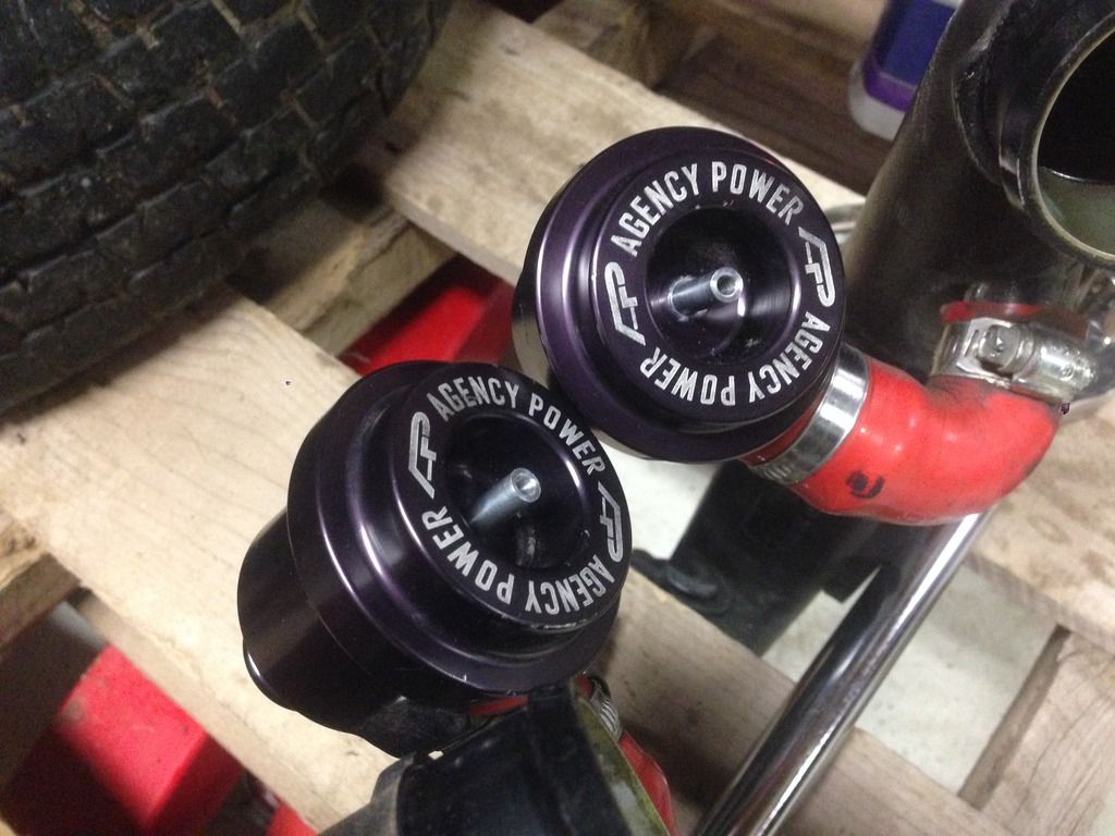

    Anyone have any experience with these DVs? Are they quality or should I look into different ones? They came with the car and I can't seem to find any reviews or tests with them. They've been working well with APR stage 2 at 17 peak psi, holding 15

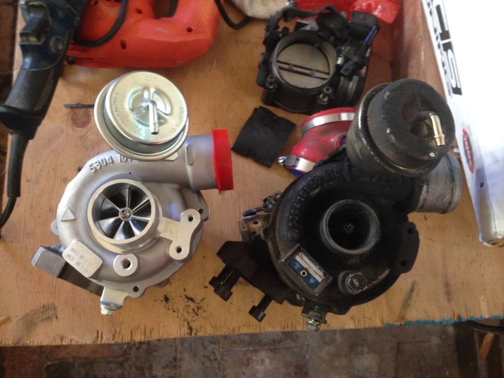

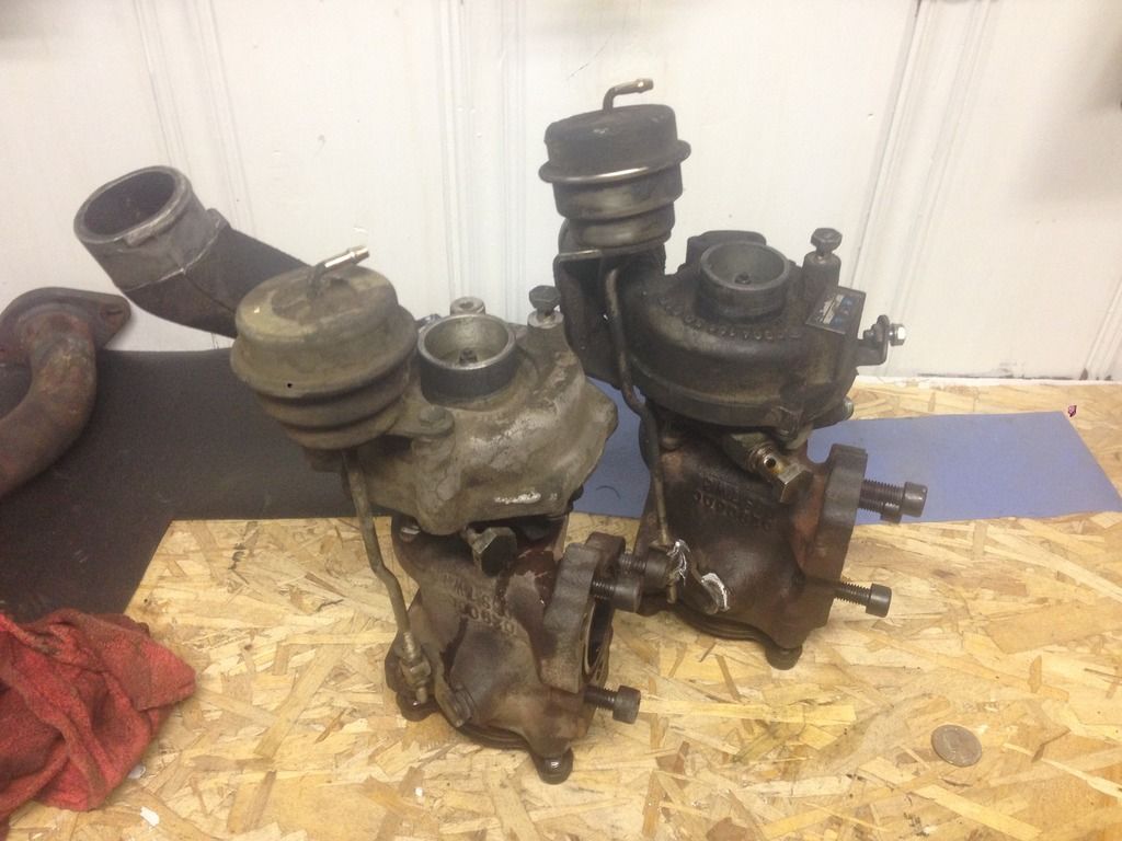

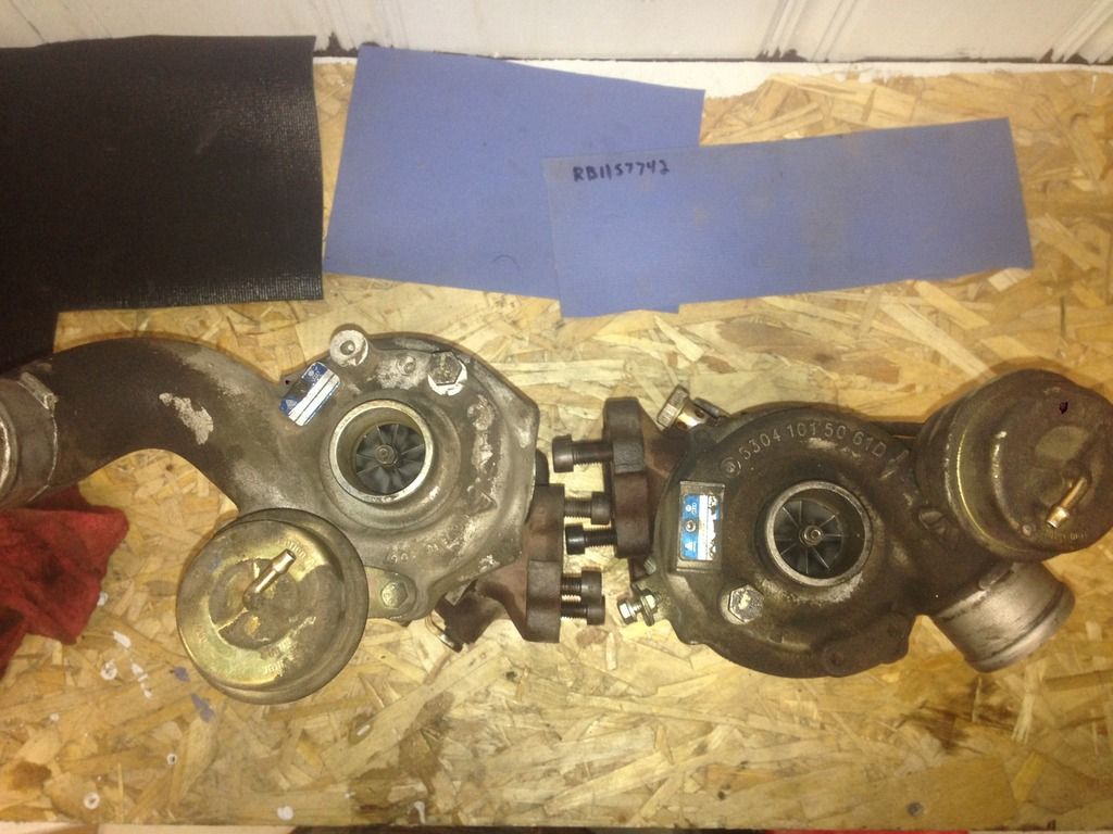

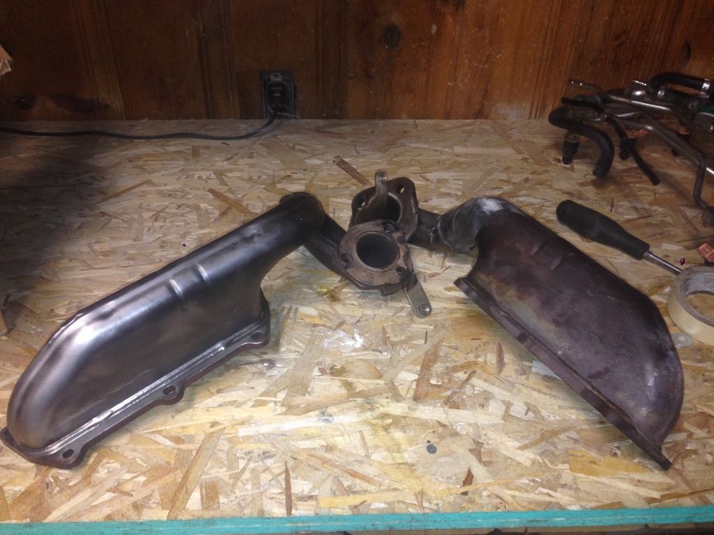

    Got the turbos off tonight. Pulled the fuel rails, intake, and exhaust manifolds off as well. Only broke a few lines/plugs
    Turbos really didn't look as bad as I thought they would. Minimal shaft play, previous owner claimed this motor and turbos had just over 50k miles when it was installed, which would put them at around 70k now.
    A little cleaning on the headers before and after.. Planning on porting and ceramic coating them.
    Next up:
    1. Separate engine and tranny
    2. Replace timing belt
    3. Rebuild tranny
    And then continue on from there

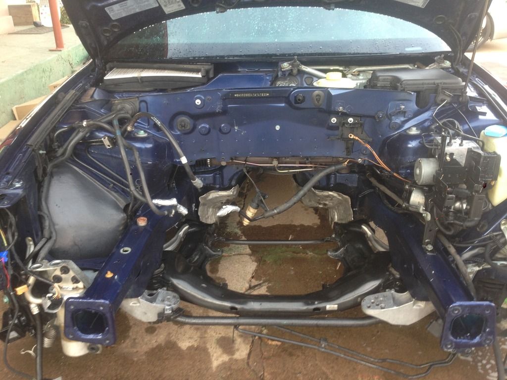

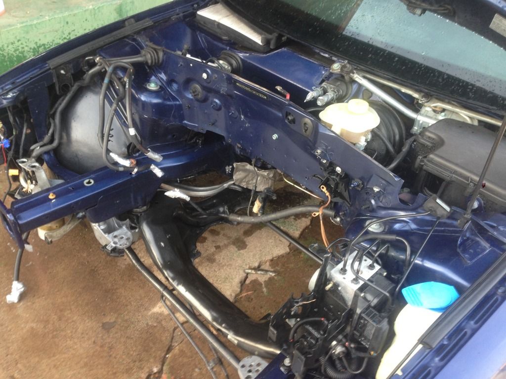

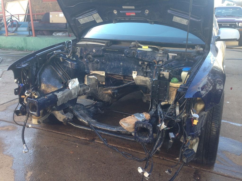

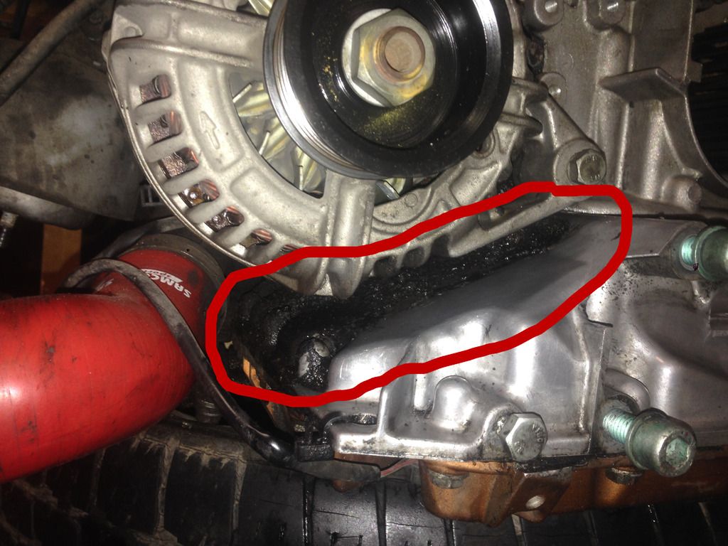

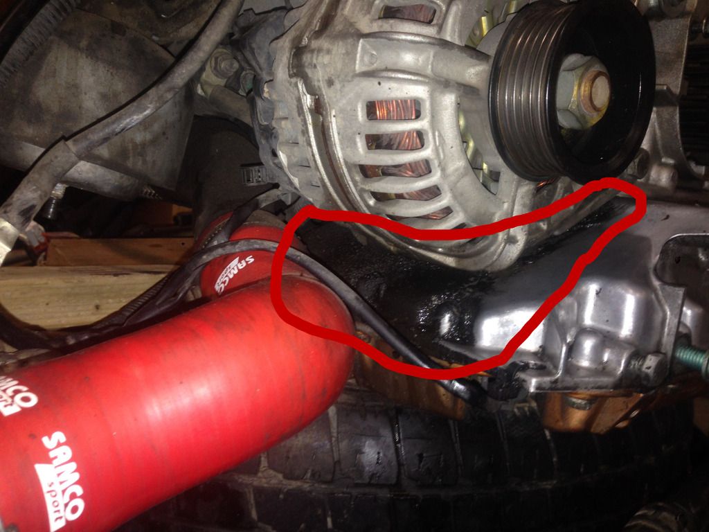

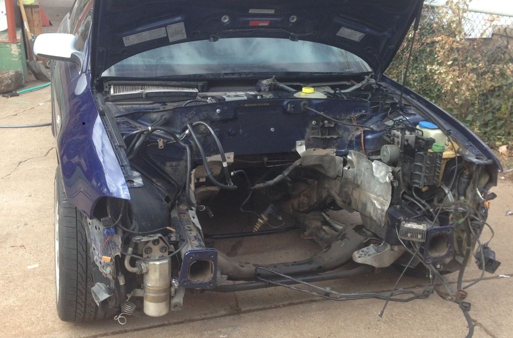

    Cleaned up the engine bay today, its been bugging me for a long time. Nearly 15 years of pebbles and grease in every nook and cranny. Took about 5 cans of degreaser, 2 cans of brakleen, and a bottle of simple green, but Im pretty happy with the result..
    Before:
    After:

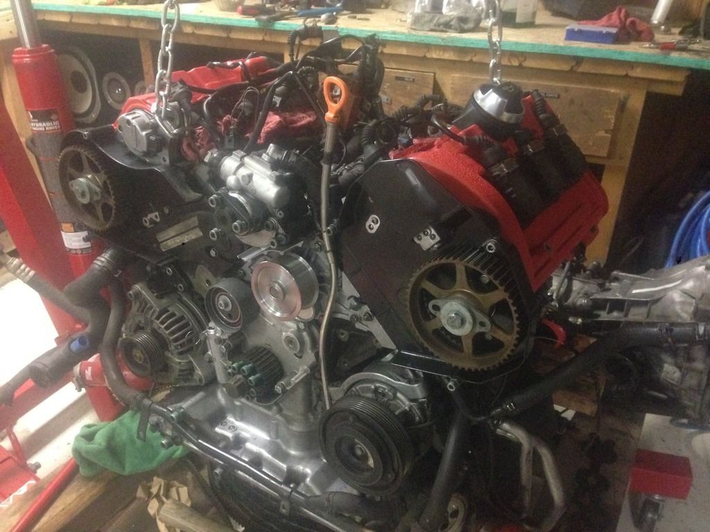

    Also got the engine and transmission separated! Debating whether I want to do the timing belt or the trans rebuild first.

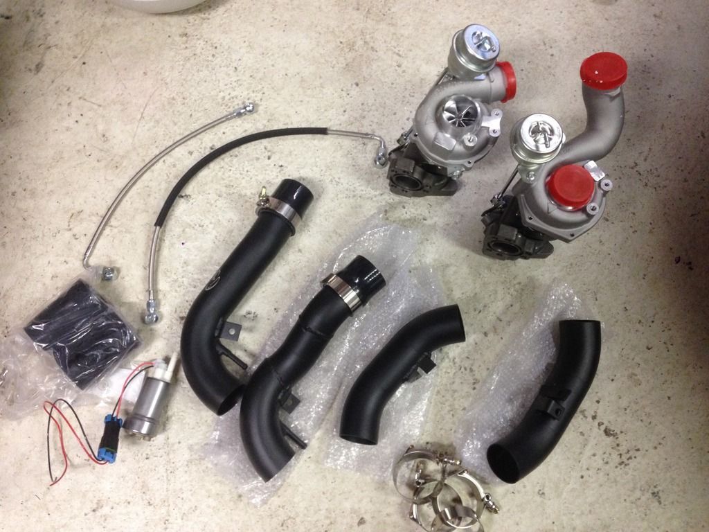

    Got a nice surprise from UPS this morning! SRM wasn't going to be able to get any K04s in for while, so they were kind enough to send me out a set of K24s instead! Could not be much happier since I always had a little regret after going with the K04s with the lack of data/reviews on them. I think I'll like the k24s better in the long run anyways.

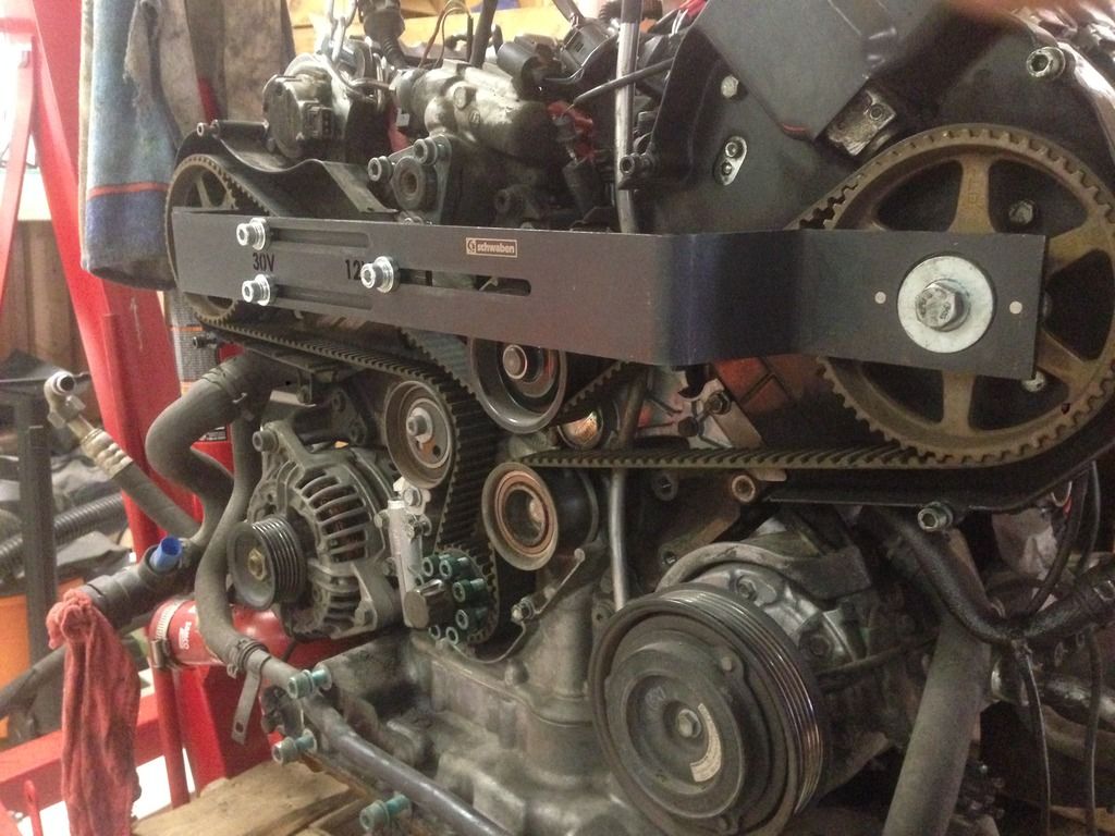

    I was able to get the timing components off and cleaned up, and also get the valve covers off and ready for all new seals. Everything looked pretty clean to me under there.
    Before:
    After:

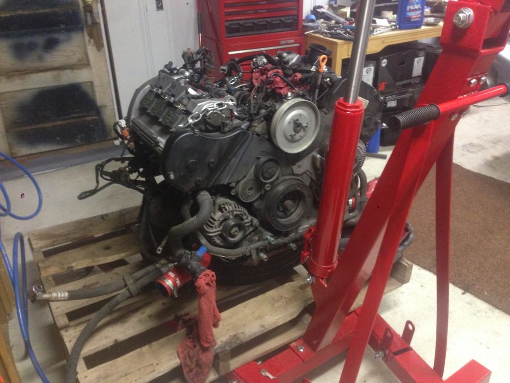

    I was so happy when i finally got my bay cleaned. It's such a good feeling to know the motor is going back into a clean home build is looking great!

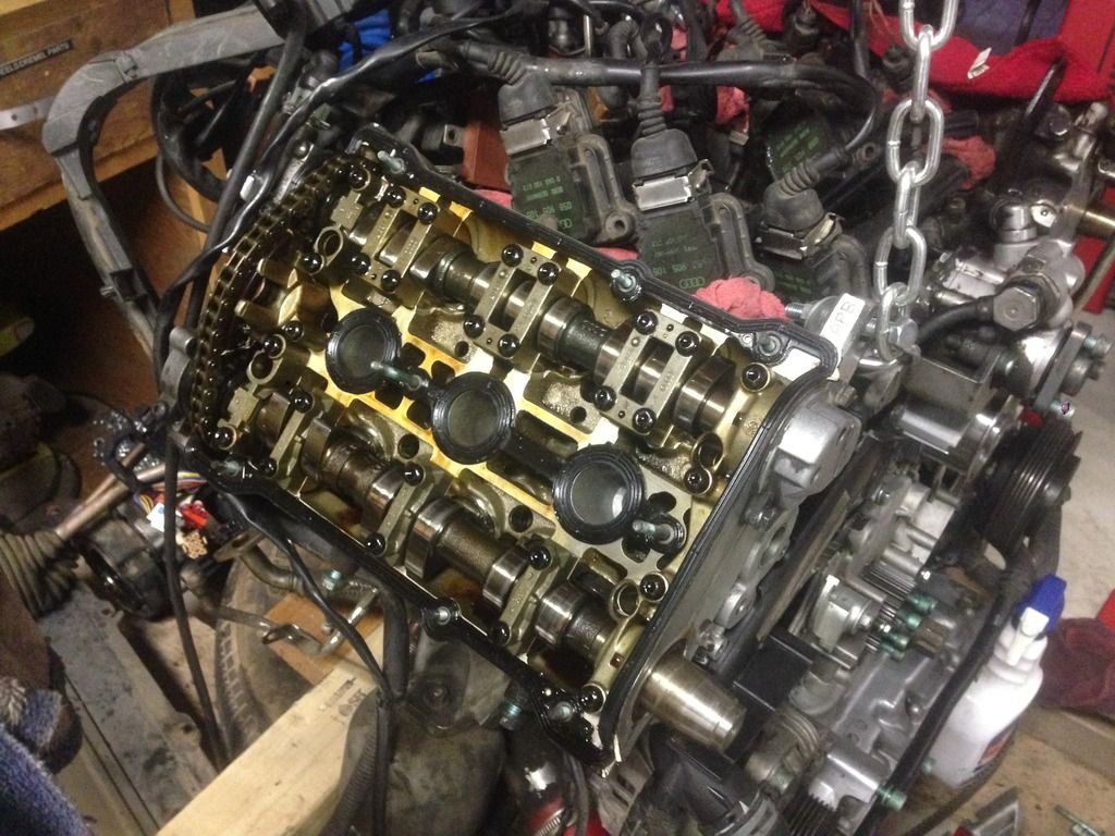

    Was able to get quite a bit done today. Got all the cam seals done, minus the cam chain tensioner gasket and half moon because my dumbass thought I could do it without the tensioner tool. With that said, its being overnighted from amazon. So hoping to have the valve covers and timing belt done by the end of the week.

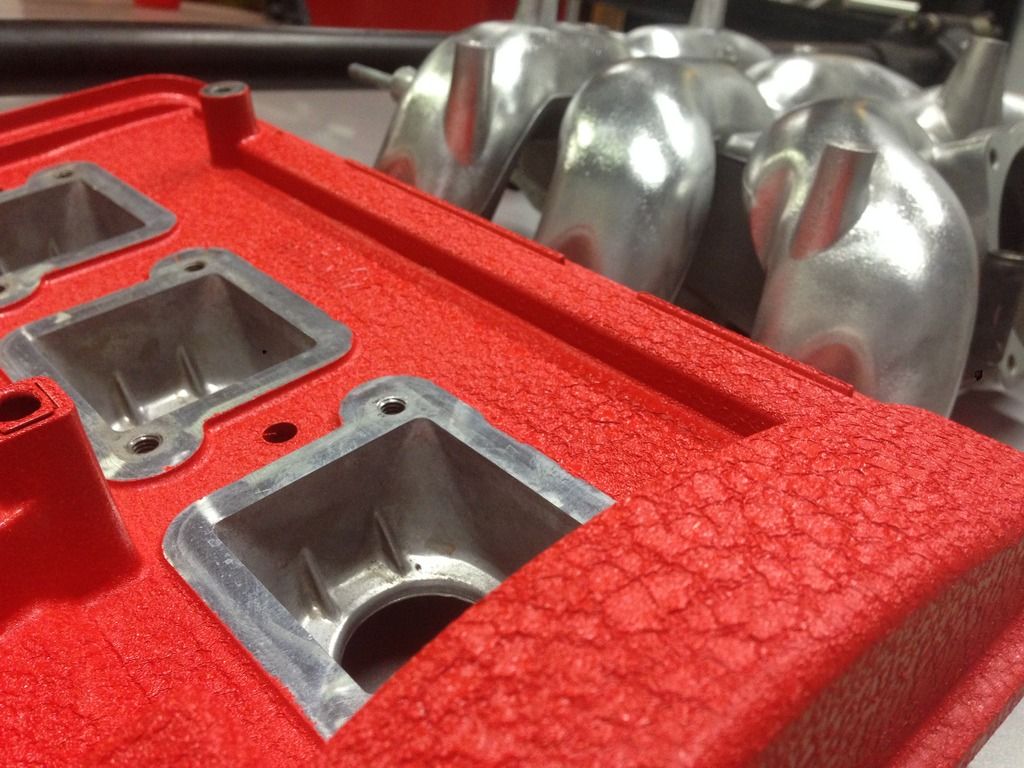

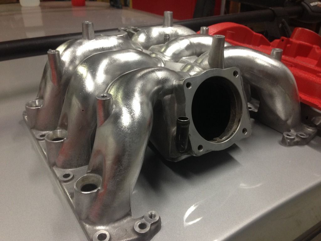

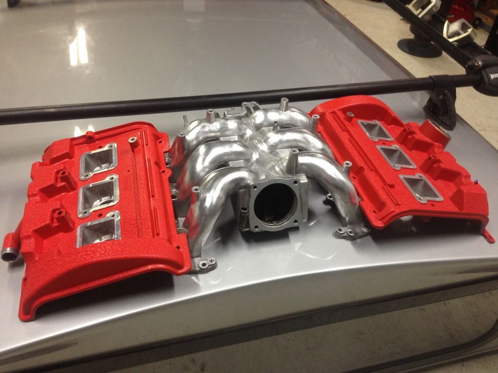

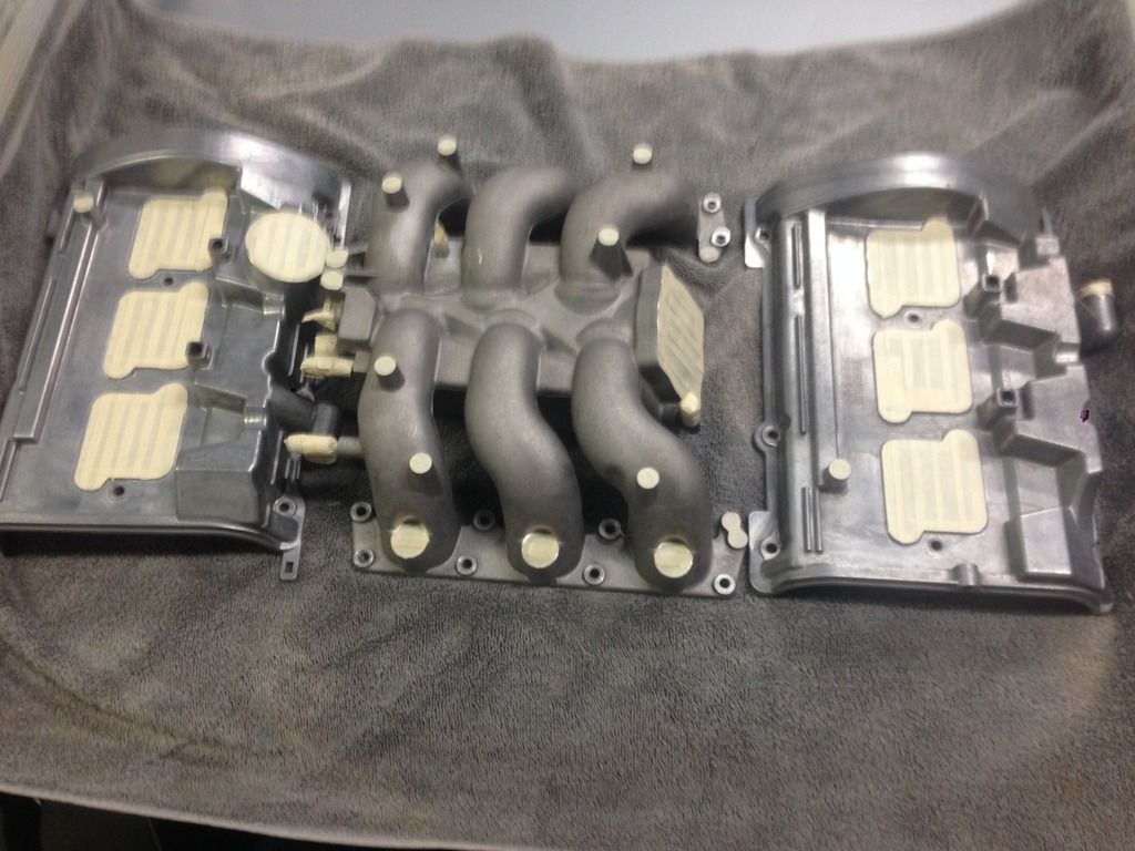

    On a brighter note, I got the valve covers and IM dressed up. Was gonna paint the IM a dark grey, but as I was sanding it down it turned into this nice shiny sliver, so I decided to polish it instead.
    Painted the valve covers with VHT Wrinkle red. Followed the directions and did the 3 heavy coats, then let dry for 2-3 hours, then cured in the oven at 200 for an hour. I was actually really surprised and pleased with the results..
    Prepped for paint:
    End Result:
    Closeup of the wrinkle finish:

    Looks great polished!
    Senior Member Two Rings rani_aridi's Avatar
    Nov 12 2013
    129743
    B5 S4 '00 BB
    Irvine, CA
    Ooooooh what did you use to polish it? Everything looks great

    Thanks! I started sanding it down with 180 grit > 220 > 400 > 600 > 1000 then wire wheeled it with my grinder and thats how it turned out. I tried a little bit of chrome polish, but it didn't really do anything.

    IM and VC's look good.

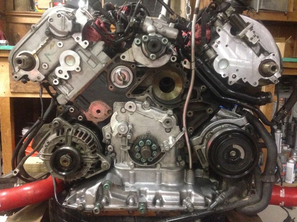

    Made it all the way to here, then could not find my new damn idler roller anywhere. Im 90% sure I had it when the timing belt kit arrived, but somehow lost it. So now on hold once again, waiting for parts/tools/etc to arrive. Was hoping to have the motor buttoned up this week, but looks like its going to be next. On a brighter note, I got all of my seals done on the top end!
    Also, does anyone know where this leak might be coming from on top of the oil pan? Im thinking its power steering fluid, but its hard to tell.

    Can you identify the fluid? Could be oil. Could be PS running from the pump. Was the leak already there is it leaking without even starting the engine/pressure?
    Senior Member Four Rings CJ_'s Avatar
    Oct 27 2014
    291120
    Flag/Phx, AZ
    Items for Sale
    It was already there after I pulled the motor. It seems like an old build-up of something. Hard to identify the fluid. Is this just a common spot for build-up/road grime, etc?
    I know I had to top off my power steering fluid about once every month or two, still don't know the source of that leak.

    I had the same build up on mine. I didn't have any leaks up top outside of the normal seals and gaskets. cleaned it up and it hasn't shown any signs of leakage yet, although I just got mine back together. mine was so bad the entire face and crevices were covered in nearly a 1/4" of grease/oil/road grime

    Is that a Geba pump? Have seen the bearings go on two that looked similar to that.
    Im sure none are 100%, but I try to use Hepu when I can.
    There are only 2 things needed to make an Audi work properly - Duct tape and WD40. If it moves and it shouldn't - Duct tape. If it doesnít move and it should - WD40.

    Yep it's Geba, it's the one that came with the ecs timing belt kit.. Thats not good to hear.. Might just try my luck with it, it feels solid, but idk.

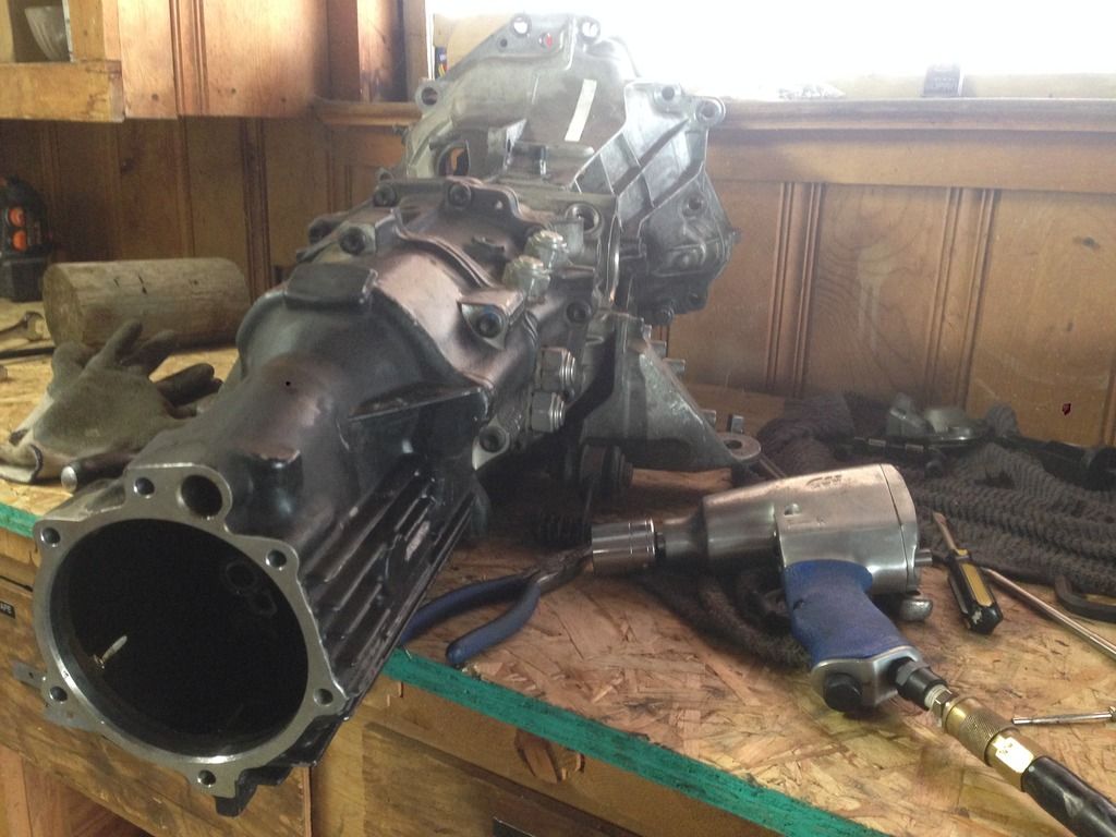

    Transmission time!!
