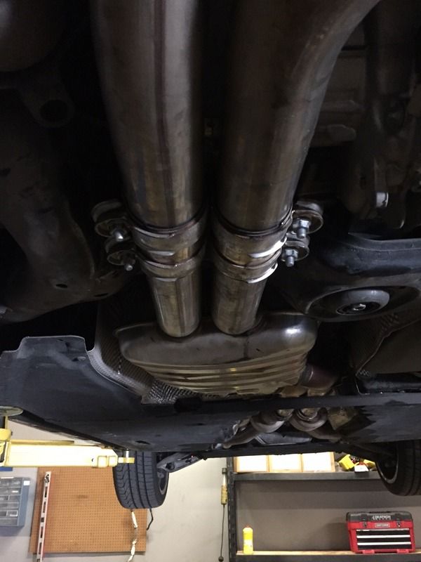

    Was wanting to do something on the exhaust side for a little extra growl since the pre-face lift is so dead quite. But did not want to lose the valve system nor risk any drone. Almost picked up a Milltek valvesonic system but thought I would try this OE sport exhaust that I came across from an Audizine member first, as it was far less expensive.
    I did not need really need the first section that comes off the factory down pipes, as I have a set of APR downpipes I plan to install at some point. Also, pretty sure that first section has nothing to do with the improve sound of the sport system, and it made shipping the unit a little bit more feasible

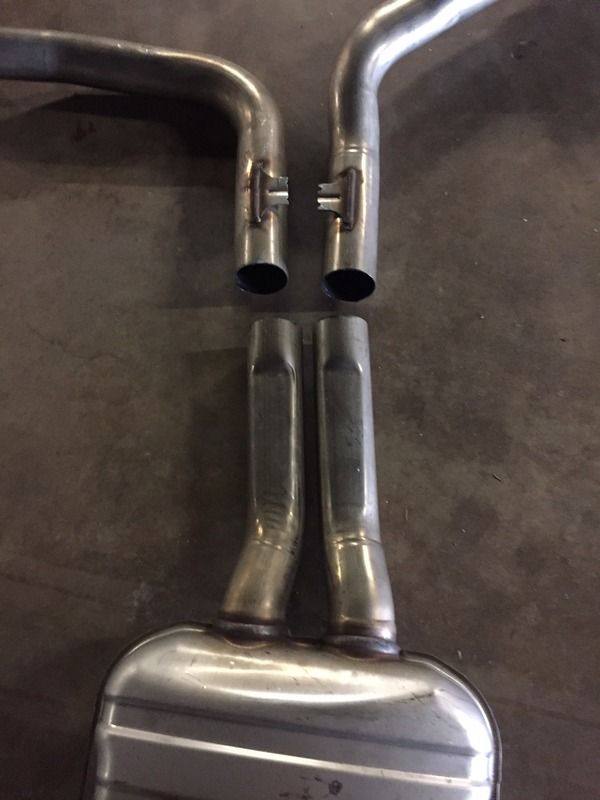

    I also had to ask the seller to have the system cut to make it shippable as well. There are pre-determined factory "cut points" on the exhaust where if a dealer needed to replace a section they could, as opposed to how it is installed from the factory as one large single piece.

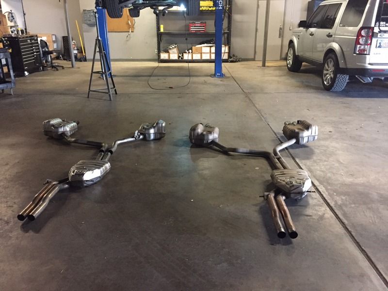

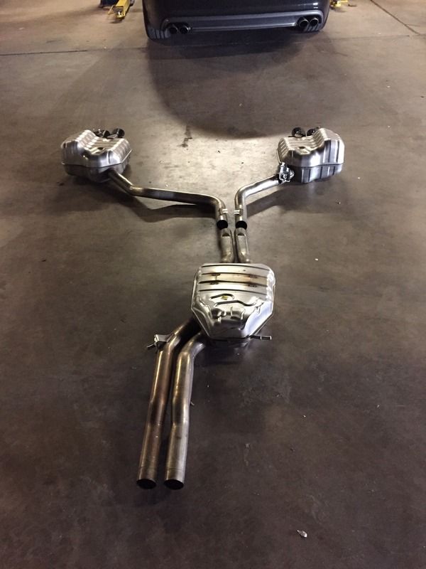

    Factory sport exhaust
    Cut at just the right spot of easier shipping
    Sport exhaust on the left and OE 2013 exhaust on the right.

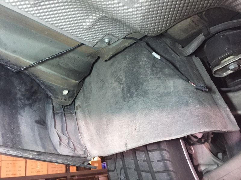

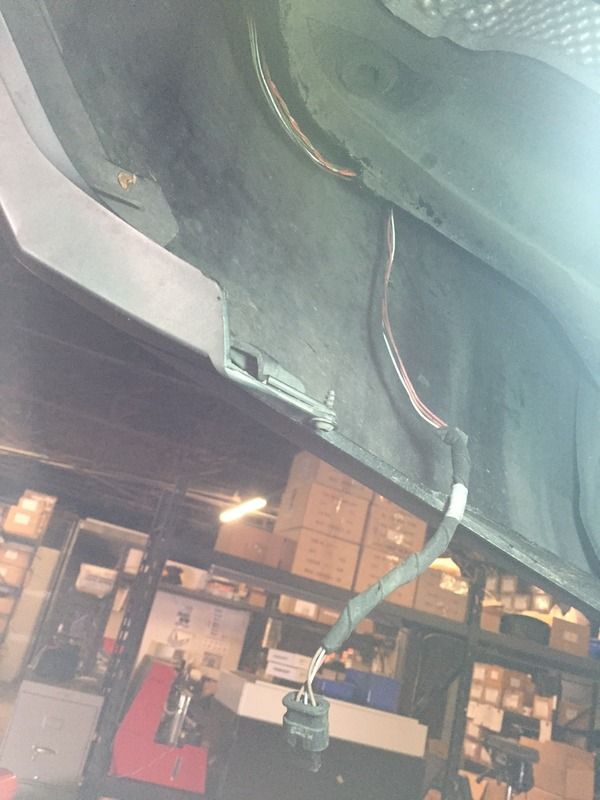

    It is basically a plug and play system, except one aspect. The valve assembly on the driver side sport exhaust is not in the same location as my 13. On the pre-face lift both valves are after the muffler and on the sport exhaust the driver side valve is before the muffler. So an issue is that the wiring harness will not reach without some improvising. One could cut and extend the wires, but instead I was able to separate the two harness that come together to get enough slack to pull the harness back to the new valve location. I will say that it is a PITA to get the wire to stretch that far and it takes every mm you can get for it to reach. Separating the harness took 1/2 the total install time, including accidentally cutting one wire and soldering it back to together
    The harness separated and stretched as far as possible and re-wrapped. But I did get it just long enough to be able to tuck it up behind that small section of liner so it was not laying on top of the muffler.
    So prior to receiving the exhaust I assumed I was going to have to get it welded back together since it was cut up for shipping. But luckily the seller cut the exhaust at just the right spot, as well as included the clamps from the front section. So instead of welding I was able to simply butt and clamp the sections back together, just like how the front section is from the factory

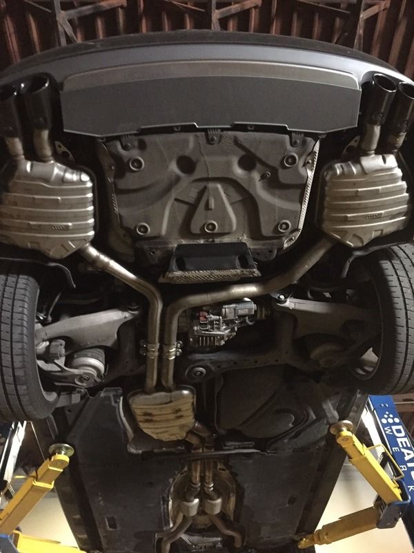

    All installed and wrapped up. Took about 3hrs with a lift, not being in a hurry and half of that time messing with extending the harness
