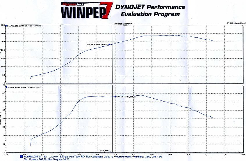

    I still hold on to what I have said for a long time, do not go larger than a 28series sized turbo on the 1.8t. Stock block/GTRS is probably the best bang for the headache, and feeling ambitious - drop in rods and choose a larger compressor like the 71r or like me a billet HTA compressor and crank it.
    A healthy running GTRS setup will yield 350chp, or 196.5hp/liter which is alot of power honestly. The same hp/l on say a 2.7tt would yield 530chp or ~400whp..
    Just food for thought, dont ask too much from the little 1.8t or you will end up disapointed.

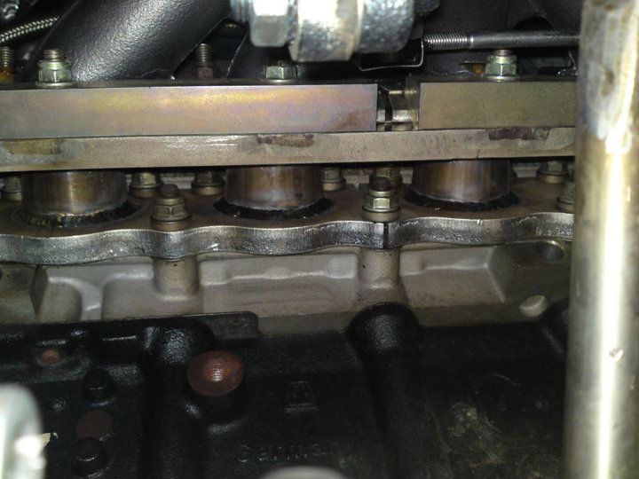

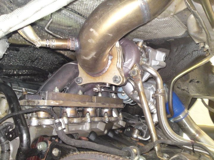

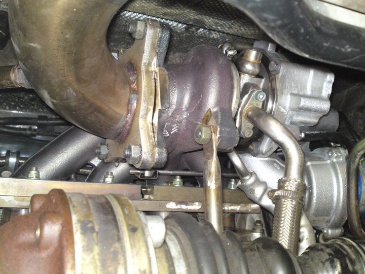

    here in greece we use the K04 turbo from new Audi S3. using transition plate between head and stock K04 manifold. the most astonishing is the powerbrand starting to built boost on 2000 rpm and up to 7000 rpm.
    a friend did this years ago with no troubles , only thing you need is a good tune and forge scat rods if you want to e safe. i think is the best you can do for 1.8t for a daily driven car that don't ask special treatment
    here is the dynosheet for non-believers (290whp ) and some pics of the project
    the dyno boost was 1.4 bar (20.3 psi) . Imagine what is going to happen if you push it to 1.8-1.9 using meth...

    ^Even used the S3 manifold, well done.

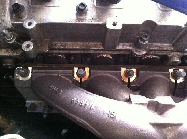

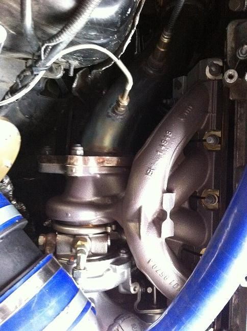

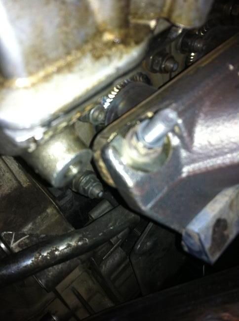

    heare are some more pics of the transition plate. the most important is that the engine block and head is 100% stock except the rods, no need for aftermarket clutch etc. if i could turn back time i would go that root for sure...

    Thats one hell of a efficient k04 if you ask me.
    Jun 27 2011
    77478
    Quote Originally Posted by texasboy21 View Post
    You can't NOT use that FSI s3 manifold. Its integral to the turbo hotside.
    In other news, I've never seen this done. Thats awesome. The S3 K04 is a hell of a turbo. Nothing like the weaksauce K04-15 us 1.8t guys are used to.
    Quote Originally Posted by vinny.dtw View Post
    That S3 K04 has billet wheels and a much revised blade profile, etc. Its a totally different beast than the k04-15. Lots of the 2.0t guys make over 300awhp with it no problem. Just need some rods and you're good.
