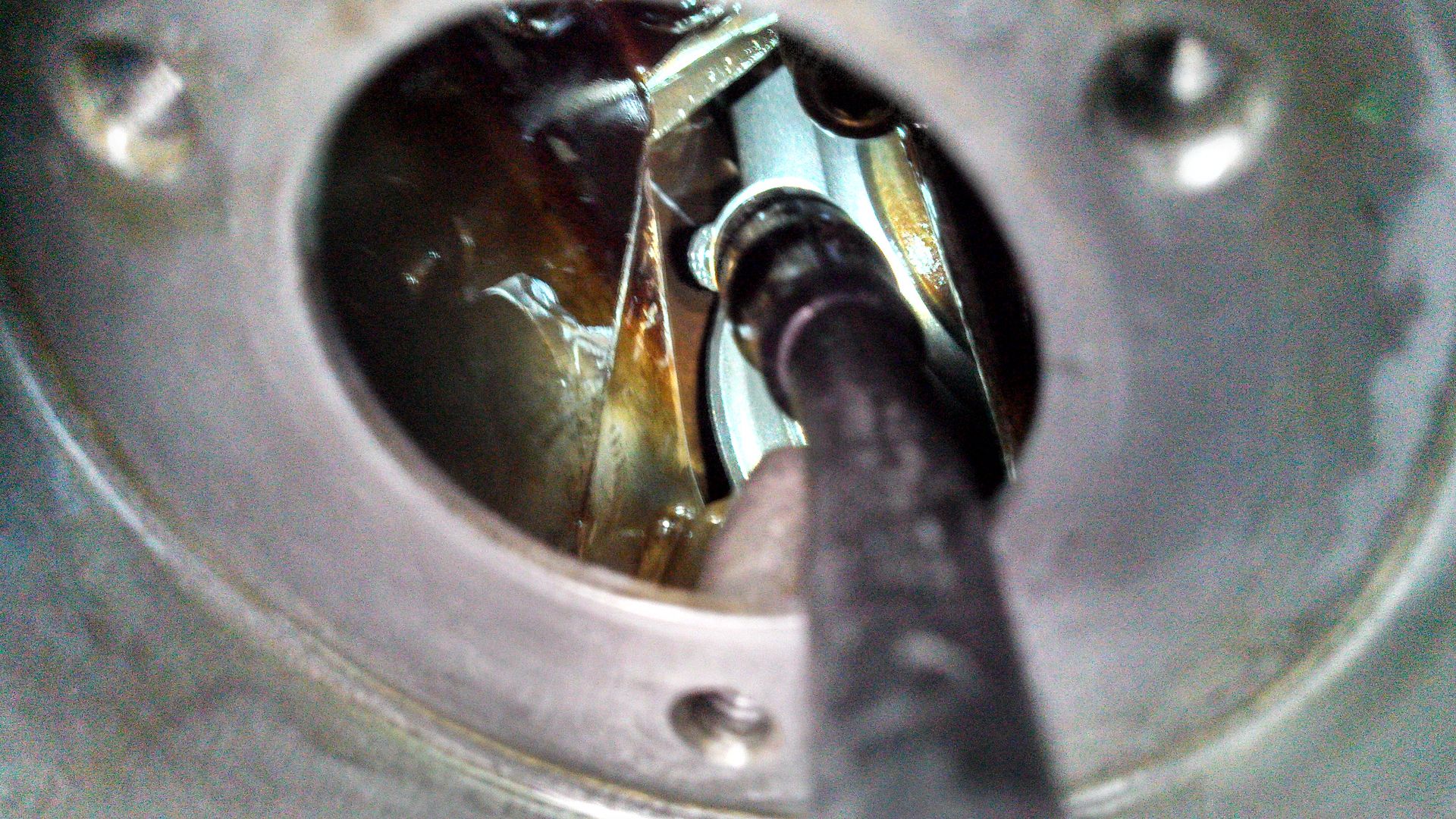

    View through oil level sensor hole:
    Main web cracked bad:
    On the one hand, dammit.
    On the other hand, holy shit, that's kind of awesome.

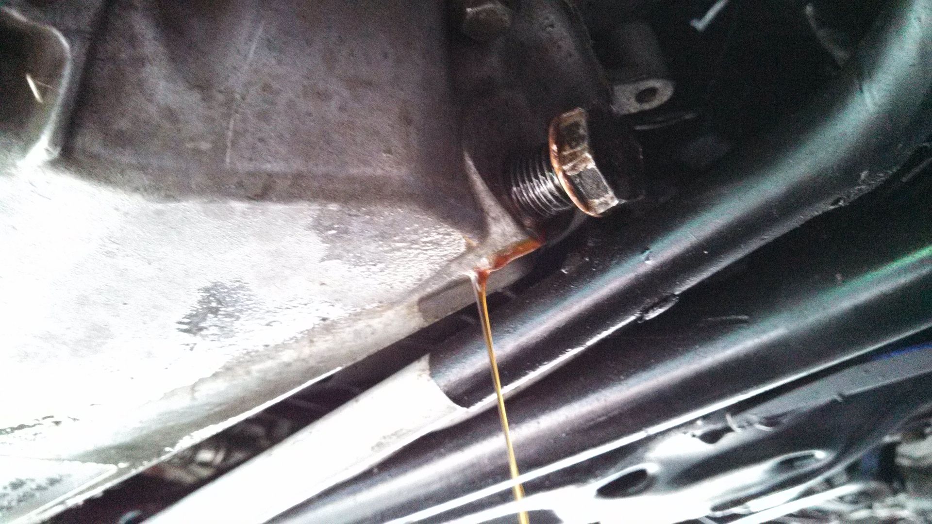

    So when you check your oil and its way over full and all your coolant is gone its not a good sign lol.
    Step 1:
    Drain coolant errr I mean oil... yes that's coolant. the oil came next lol.
    Step 2:

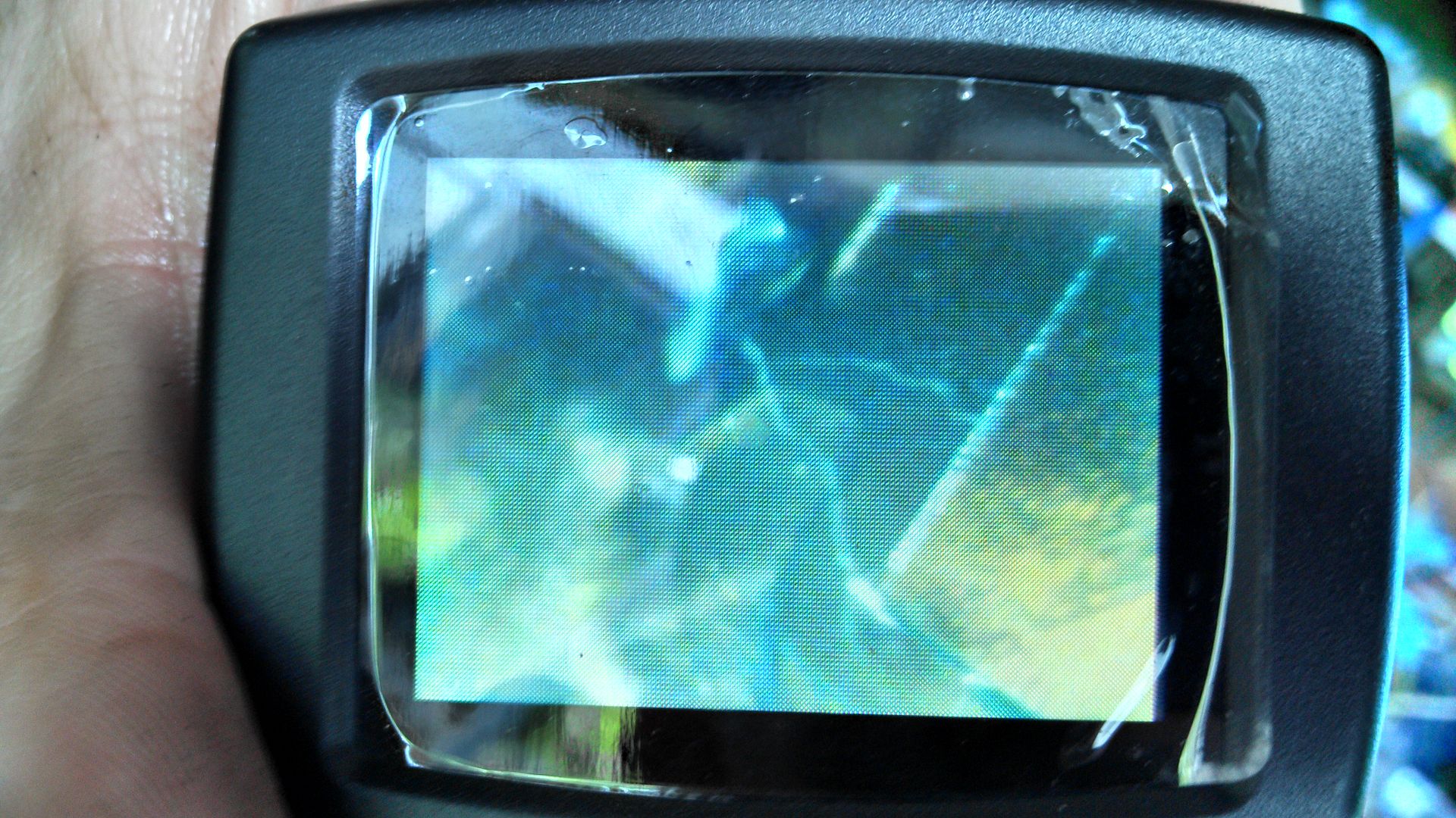

    Pull the oil level sensor and peek up into the hole.
    I used a bore scope but I could see the problems with my naked eye lol.

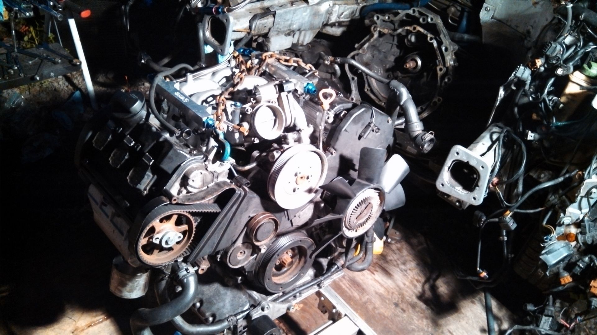

    Out in 2.5 hours
    impressive. Next one in and pulls by saturday night? :)

    So I'm now thinking maybe I should do my bottom end plans with the 2.7 late block.
    That way the bottom end should be solid. and will prove it out prior to the 3.0...
    Will just add a week to being running again...
