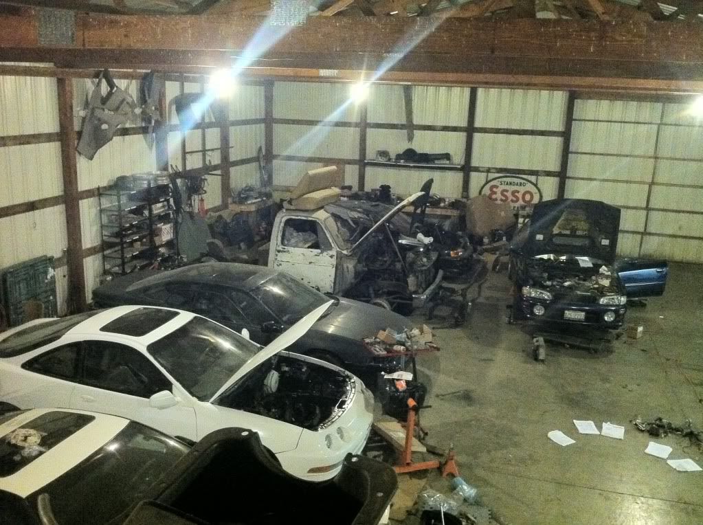

    Why did you do that in gravel? Lol. I have a ton of garage space if you ever need somewhere to work.

    Well I'm sure the wood made all the difference haha. You work fast, and seem like you'd be a good person to have owe me a favor, so you're always welcome hahaha. You can see about 1/4 of my garage in this picture.
    Nice!
    May 16 2008
    28851
    WA
    <= this guy is extremely jealous of that garage space!!!!

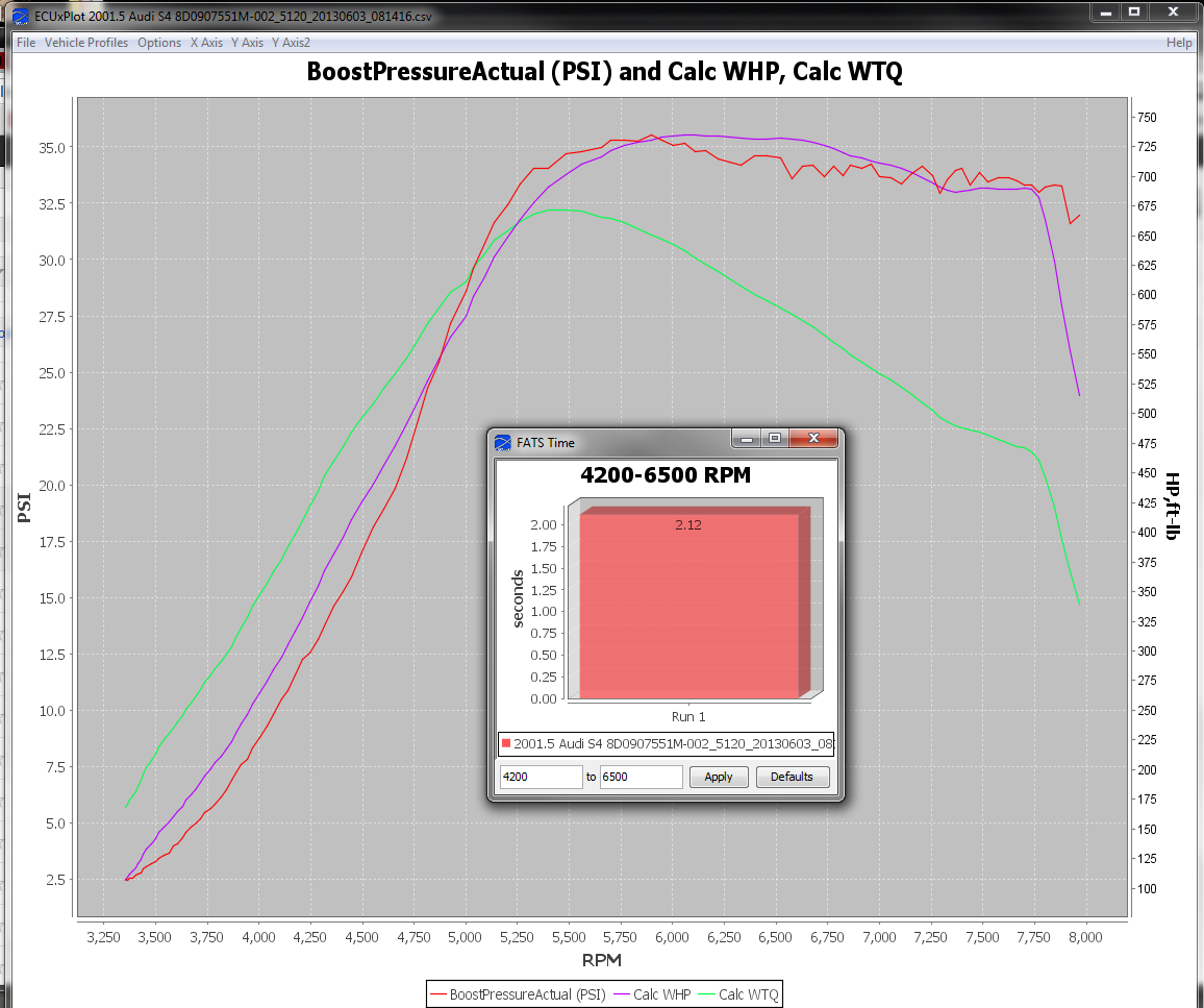

    2.1 FATS time this morning at 35psi.
    I'll post video and plots later :-)

    And because we all love the G's...
    Are the 'vehicle settings' in ECUxPlot all untouched?

    Quote Originally Posted by jibberjive View Post
    Only thing I changed was the RPM per MPH was changed to reflect reality.
    Here's my settings:
    Mass (kg): 1700
    RPM per mph: 68.11
    Coef of drag: 0.31
    Frontal Area: 2.034
    Driveline loss: 25
    Sep 18 2012
    100686
    State College PA
    The 2.1 time was slightly up hill...
    I was setup for a flat run on my normal spot on I-80 but when I got on it realized ESP was still on... so it started freaking out and pulled a bunch of timing so it "only" managed a 2.2 time lol.

    Here's Virtual Dyno overlays:
    Blue is 32psi with No Nitrous (2.38 FATS)
    Red is 35psi with Nitrous (2.12 FATS)
    Crazy stuff lol

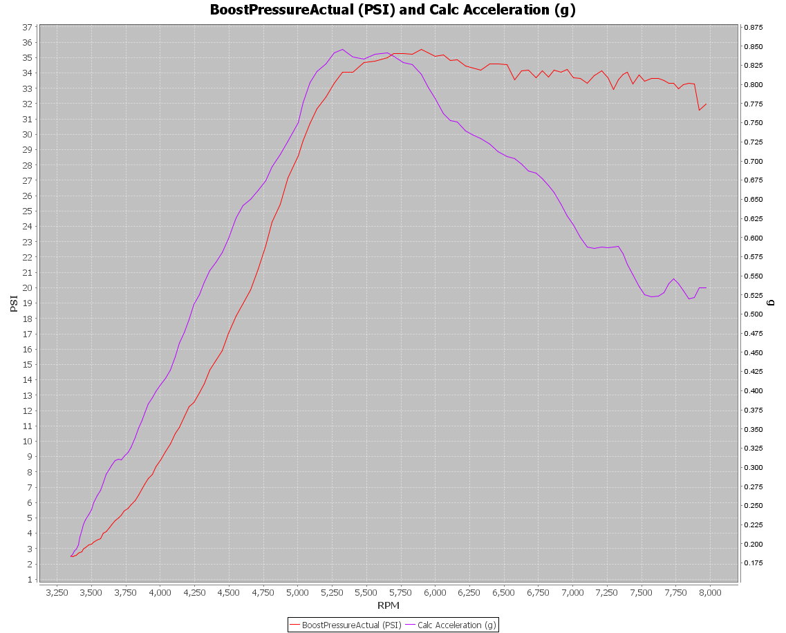

    Veteran Member Four Rings NOTORIOUS VR's Avatar
    Jan 29 2009
    38059
    can you add a boost plot to that? Is the boost falling that hard past peak TQ? With your size turbo, you should try to keep increasing boost after peak TQ to keep it as flat as possible.
    Oct 27 2011
    83106
    TOYS
    Philly Suburbs
    Quote Originally Posted by NOTORIOUS VR View Post
    boost plot is up a few posts

    You going to taper that boost up to hold the power up top?
    Sep 18 2012
    100686
    State College PA
    You can see in the pic above that it dropped off about 2psi...
    I haven't got the Wastegate dialed in for 35psi yet so it's no big deal lol.
