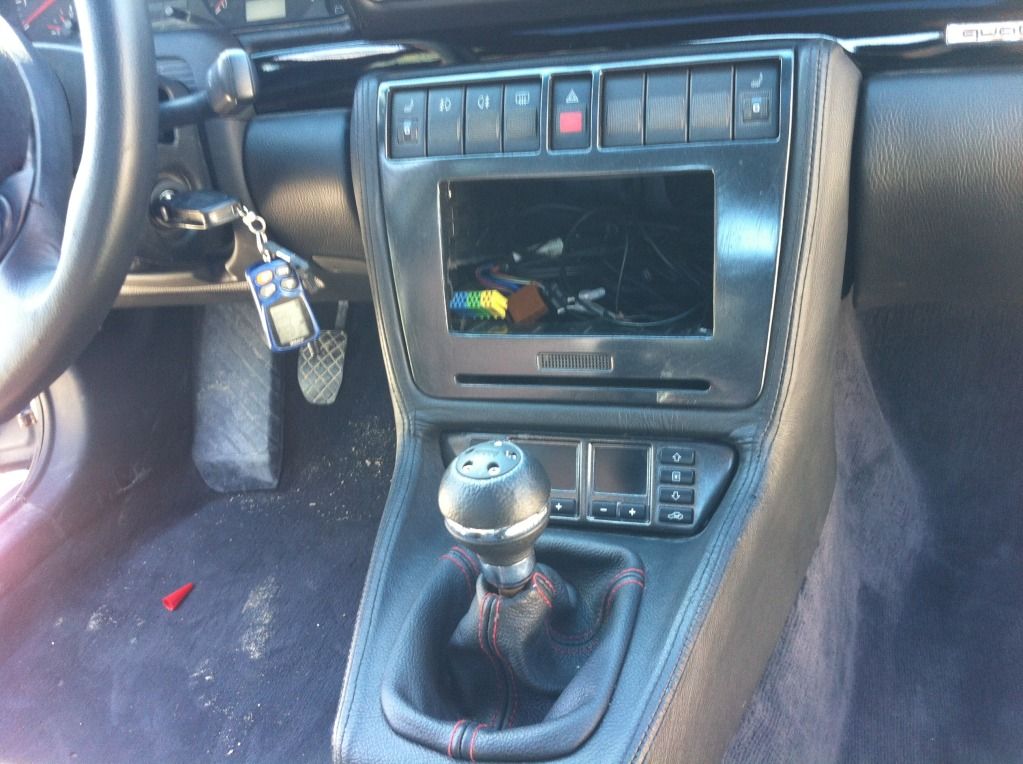

    The center console we had to custom make it using plastic weld and plastic bond and the hvac controller was already custom made by some body here in the forums a couple of years ago. I've purchased it when I was still living in the US so like 5-6 years ago.
    Quote Originally Posted by silverman View Post
    What center console is that? Im just curious as to how you got a double din in there and how you mounted the HVAC stuff below?
    ...or did I miss that?

    Damn good to know/thanks for the info. I really like the leather wrapped dash. That is something I want bad but with double din... Seems like a facelift conversion would be less work on my end!
    Also, J/w Why'd you move?
    I think it's way easier to swap for a facelift one if you find the parts. Over here finding parts it's difficult.
    Btw I moved back to Albania because I only moved to the US to go to college. Once that was done I shipped my car across the ocean and moved back.

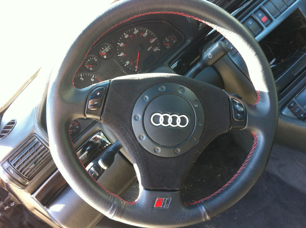

    Dooooooo it! People have wired them up for a bunch of shit! I'm just deathly afraid of wiring!
    Cactus green B5 A4!
  8. #288
    Veteran Member Four Rings jaychen's Avatar
    Feb 19 2011
    71196
    Earth
    I was going to do this with my S3 wheel.
    Perhaps use one side for boost and the other for manual prime for my fuel pump!
    It can be done quite easily. You shouldn't have a problem using it for your pumps the_pirate.

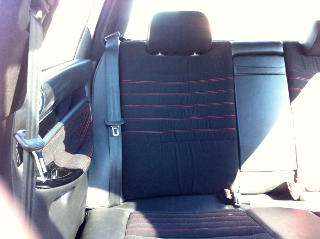

    Getting some black seat belts today from a junk yard because the grey ones look like shit.

    Quote Originally Posted by Aliel View Post
    Thanks man but this is only a temporary color so hopefully the one I chose as a final one will look nice too.
    A little update. Today me and my buddy made a double din opening for my new head unit and relocated the climate controls. It's not finished yet. The parts still need to be painted and some small details fixed.
    where did you get the plastic surround piece or did you custom make that? Where did you get the plastic? I have a pre facelift as well. This is where I am at right now. Mine is a little different idea. I decided to update the climate control unit.

    I actually modified the stock plastic piece. It was cut up and plastic welded and finished with plastic filler. Then it was sanded smooth and painted.
    I really like the direction where yours is going as well. I like the updated climate control. Do you have a thread about it where I can stay updated?
    Quote Originally Posted by jeffrey146 View Post

    Quote Originally Posted by jaychen View Post
    You'll need a Tiptronic slip ring to be able to wire the buttons to anything.
    And just so you know...you can't use one button for boost, and the other for anything else. They are both linked to the same track on the slip ring / clock spring. So both will control whatever you link the Tiptronic clock spring track to.
    Thanks mate!
    Hadn't realised this. I will probably just get a filler plate for one side anyway and use the other side for something like intercooler sprayer or similar.
    Thanks mate!
    Personally, I'd be inclined to leave both buttons functional, rather than blank one out.
