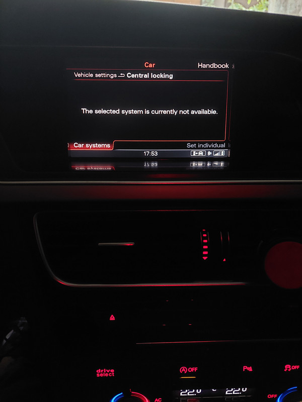

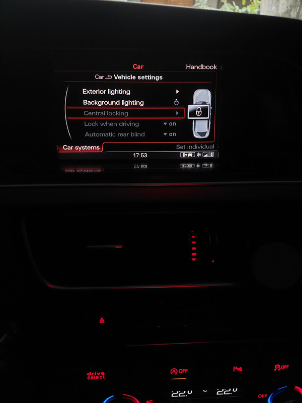

    One more issue that did not work out for me and I post here as related to VAG coding is regarding the AUX heating. I have been successful at enabling ventilation menu. AUX heating also shows up but if Turn it on, it goes off. Also might be important to mention that I do have a suppl. Heating with either auto or off setting.
