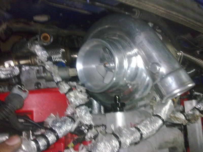

    so that's 950hp+1000hp?
    And to think that they charge extra for the polished ones....And I didn't pay or wanted it polish...
    APBS4 to tell you truth I am more worried about the 4 inch downpipe ...I don't think it will fit.......

    what turbo is that? why go 4"? isn't the exhaust outlet only 3 or 3.5"?
    You'll still benefit from a bigger exhaust diameter!
    There's still 10 feet of piping. The bigger diameter, the better.

    not entirely true. the larger it is could cause less backpressure and could also aid in cooling of the exhaust gasses, which is not good. but for the most part if it is set up right the larger diameter could help, however a usual rule of them is to match the diameter to the backside.
    Yea so true look at hondas with 6 inch exhaust..... those bitches are mooving

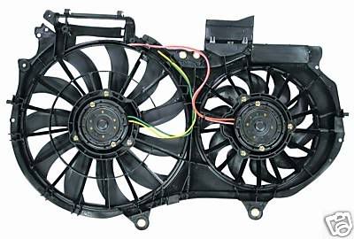

    The fans and controller - are those stockers from a B7?

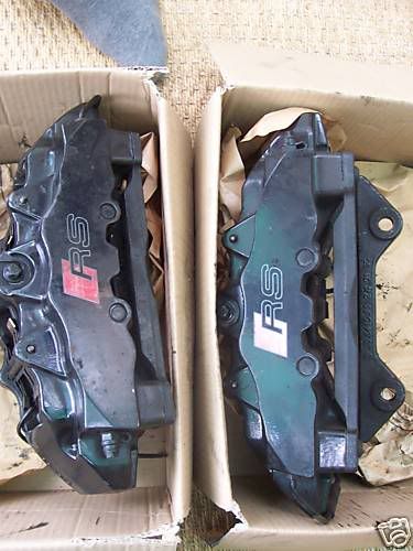

    8pistons RS6 brakes.....

    Yes ..OEM B7 RS4

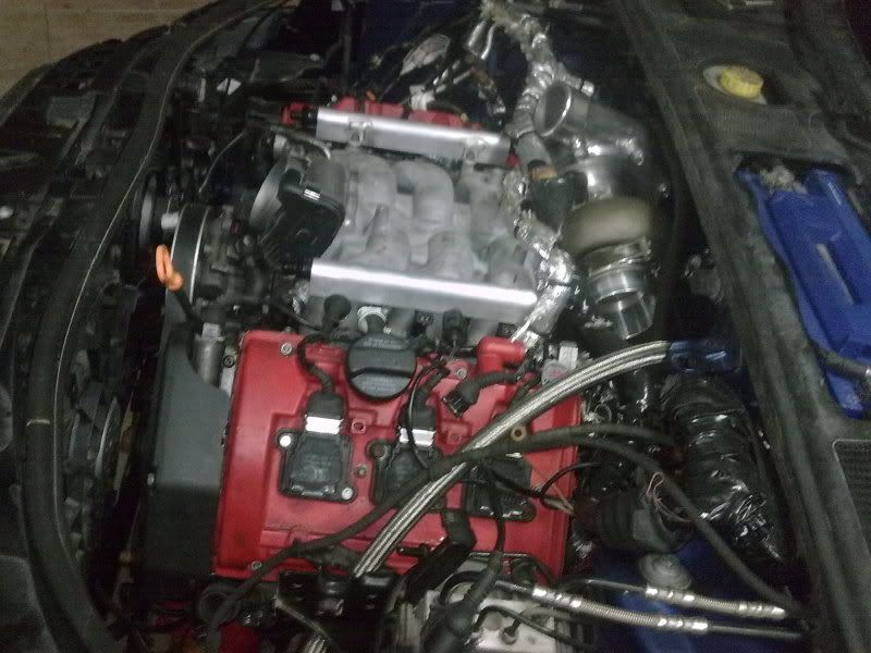

    Some new phone pictures...

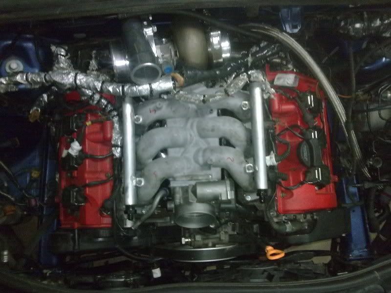

    Downpipe is gonna be a squeeezeee. Also interested to see your IC piping.

    Also interested in seeing what the charge piping is going to look like.

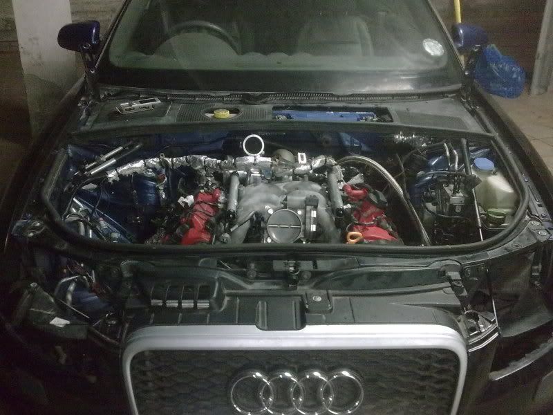

    We manage to squeeze a 3.5 inch Downpipe. We had to make room for it, by cutting a small lower piece of the secondary firewall...

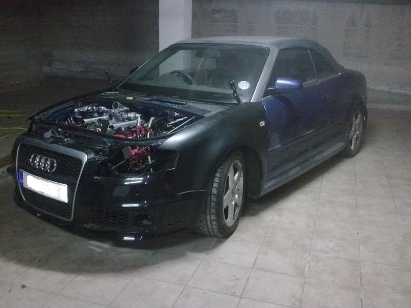

    Car is almost finished .It is now at the body shop . The RS4 back fenders are getting installed.
    I would take it for a custom FMIC as soon as it finish
    I am currently missing the drive axel (I hope Advanced Automotion can help with this) and I need to replace the crankshaft positioning sensor since I broke it during assembly...

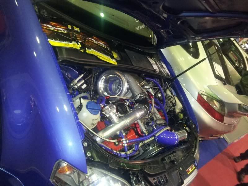

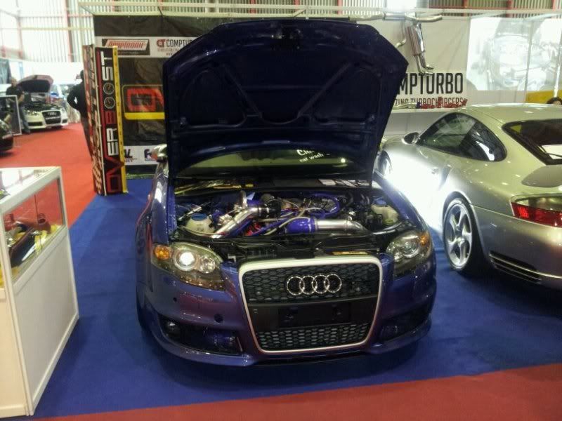

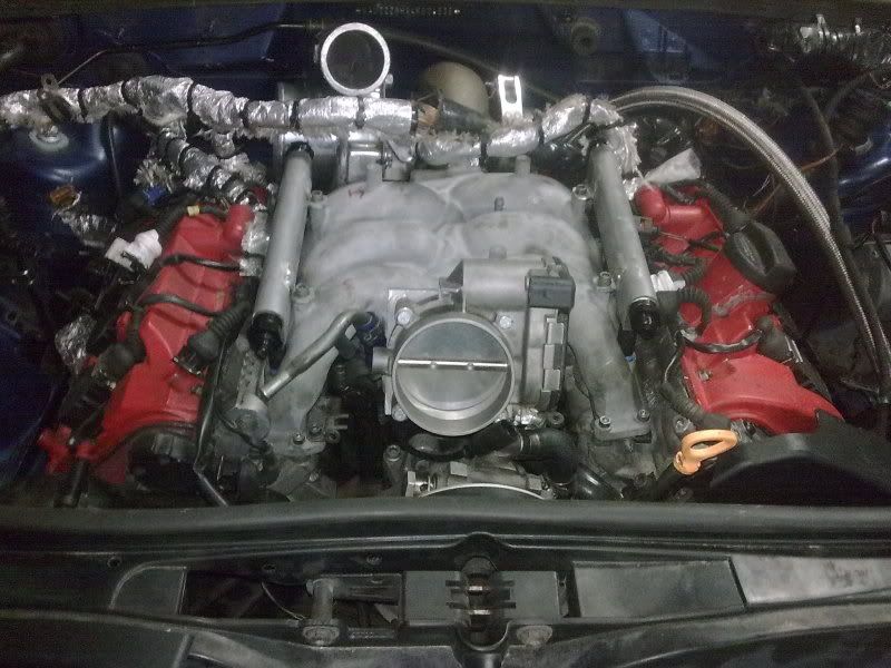

    I had some issues with the built. Basically I had to redo all the wiring, which I just finish.
    I still haven’t break-in the engine. I did tune it a bit on the dyno before redoing the wiring.
    Only 2-3 issues remain to finish it
    1. Calibrate the shift knob. For some reason after the JHM short shifter update ,I cannot get the shifter alighted. I tried everything I could think of, watch the videos 1000 times, been throw the service manual but I can not get it to work. To be able to get reverse the shift knob was to be tilt a lot to the right. I tired calling JHM a few times but nobody answers there phones. Are they still in business?
    2. Reroute the brake cylinder vacuum pipe since its too close to the downpipe
    3. Tune it
    Some pics from a motorshow that we took part

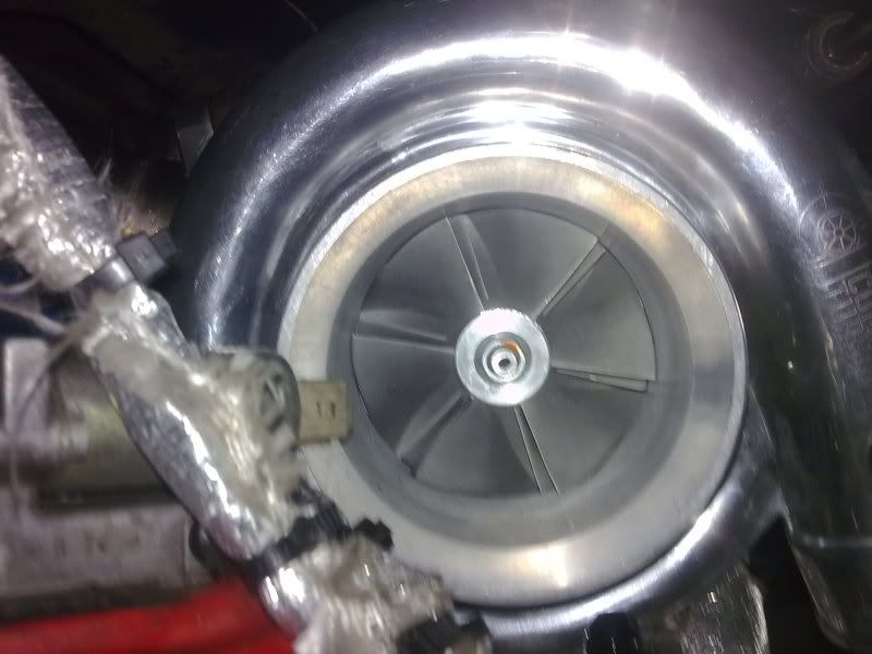

    Btw I update the turbo to a 7879 billet with antisurge compressor cover

    I just finish beding in the engine.
    Having a single turbo added a lot of issues (oil leaks and fire!!) but I finaly got aroundf them..
    My first impressions of the big (1250hp turbo) single turbo system is thats is lagy. With 3 gear up to 3800-4000 rpm I have 0.5bar
    Today (or tomorrow) I will strap it on the dyno for the first face of the tuning. i will be going up to 1.5bar (if the silicone hose of the throttle body doesnt pop free again)
