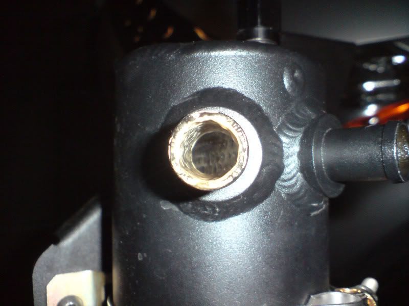

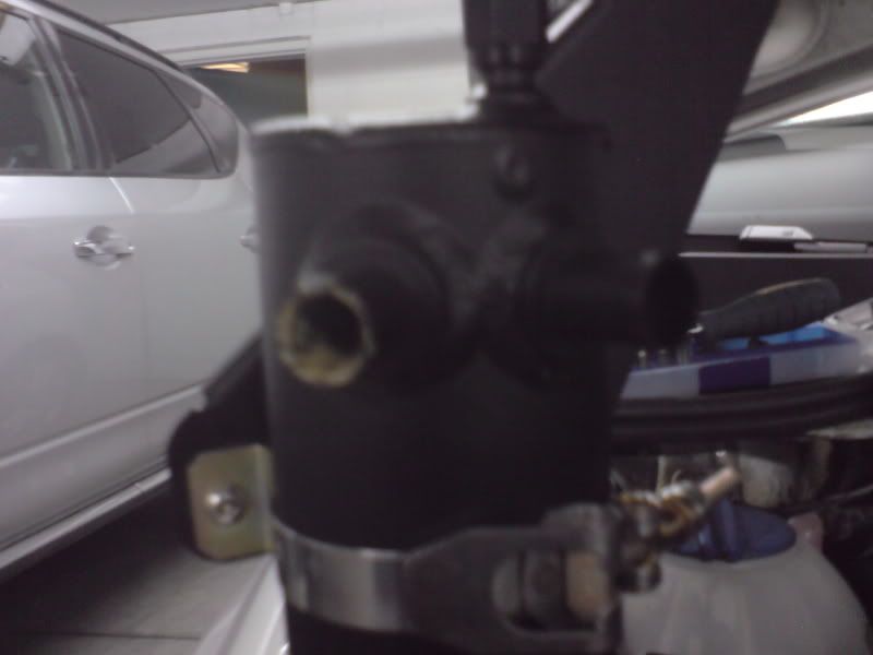

    Here's a Picture of the In and Out Ports of my Catch can when I drained it last night off my 2.0T
    Last picture is a drain I made a while back. I usually drain every 300 km since I'm afraid of freezing issues in the winter
    Look at how bad it is for a 4 cyclinder engine... and imagine your 3.0T engines running even more power and with a larger intake manifold.. how much worse could it be??
    I'm very interested in getting an S4 for my next car.. but if there isnt an OEM or aftermarket solution to this I don't think I'd come back to VW/Audi...

    Great post with pics - this is what you DO NOT want in your intake manifold. EVER. The Catch can, catches this and you can dispose of it properly. If the design worked where it would truly recycle and burn this, it would be ok, but it doesn't for FSI engines :(

    Quote Originally Posted by NWS4Guy View Post
    NP. We're all FSI engines here.. figure I share the wealth of info and pics
    If you're good with DIY you can easily get a Carbing Catch can and hook it up yourself. I picked up one for a friend's GTI and he's ordering the PCV plates so I Can hook it up for him. Carbing Catch cans and some Forge catch cans are Universal for people who hook it up in their cars and aren't using specific kits. It may not look as clean or be easy to install, but still does the job for a lot less money, and still does the same thing.
    Heres a pic of my catch can

    catch cans in 20 below freezing can make for a ton of moisture, then ice in them. Once blocked....yer doomed. Keeping them de-iced might be a pain for us canadians.
    2021 Suzuka RS6
    2020 Nardo RS3
    2018 Ibis R8 RWS
    Veteran Member Four Rings riegeraudi's Avatar
    Apr 16 2009
    41314
    Re: Direct Injection and build-up issues
    thanks lou nice to know than we canadians don't really have any options I guess.
    Oct 20 2008
    34404
    Quote Originally Posted by L0U View Post
    Well, if you want to keep your car in tip top shape you have to keep up with the maintenance
    Quote Originally Posted by riegeraudi View Post
    Draining the catch can is easy. I do it every 300km or so. takes about 10 mins.
    Apr 16 2009
    41314
    Quote Originally Posted by Akatsuki... View Post
    So you are in T.O so am I so you have had no problems with it in the winter? Has you ever had it freeze before? If it does freeze will it harm the engine?
    Oct 20 2008
    34404
    No Issues what so ever.
    People had freezing issues cause they didn't drain it consistantly, and had the steelwool version of the catch can, where some steel wool had water in it and froze over time.
    If you drain it consistently it shouldn't be an issue. I have a really large catch can, so as long as i drain it every so often it wont be a problem. No issues here.
    I'll keep you updated with this as it gets even colder. So far I've been draining every 300 and no issues. Once it stays permanently under 0, I'll drain it every time I come home. I park my car in an underground parking, which stays around 5 degrees, so even if there is a bit of freezing it should melt. After a drive your catch can is usually hot, so it's a good time to drain.
