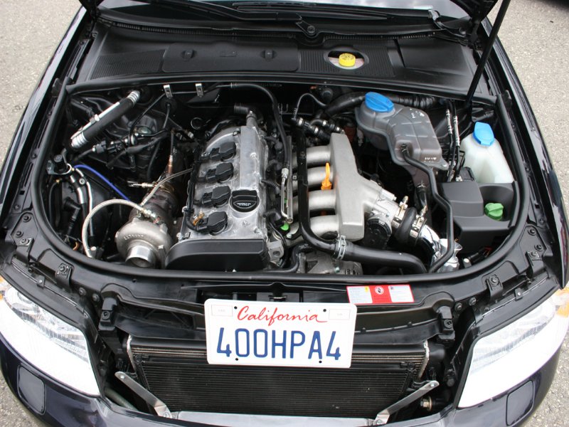

    That link you posted does not bolt up to the stock manifold, it come with it's own manifold. Some people consider that hardware obsolete because you can make the same power with a GTRS Eliminator (which looks more OEM and the programming is more refined).
    Give me a second and I will post up pictures of the link you posted installed on my car.

    Re: K04...GT2X...GT28r...GTRS/GT28rs - Official Turbo Comparison
    Quote Originally Posted by dirtybrd View Post
    A red x?
    Ill rehost it, comcast must not like hotlinking.

    Quote Originally Posted by Greg@DTH View Post
    you know, now i kind of feel dumb. haha...just looked at the link again and it clearly says it comes with a turbo manifold. how much would a kit like that cost to have installed anyway? obviously it would vary by shop, but an estimate would be good enough...since ive got absolutely no clue.
