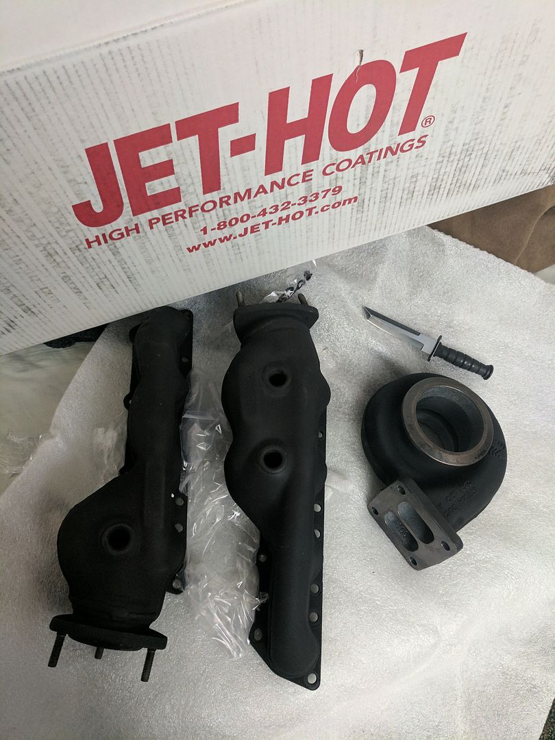

    • Custom Direct Port Water/Meth Setup (30cc nozzles)

    $450 for the headers
