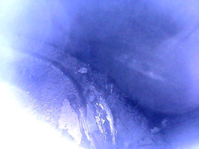

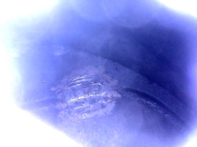

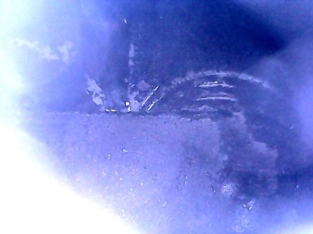

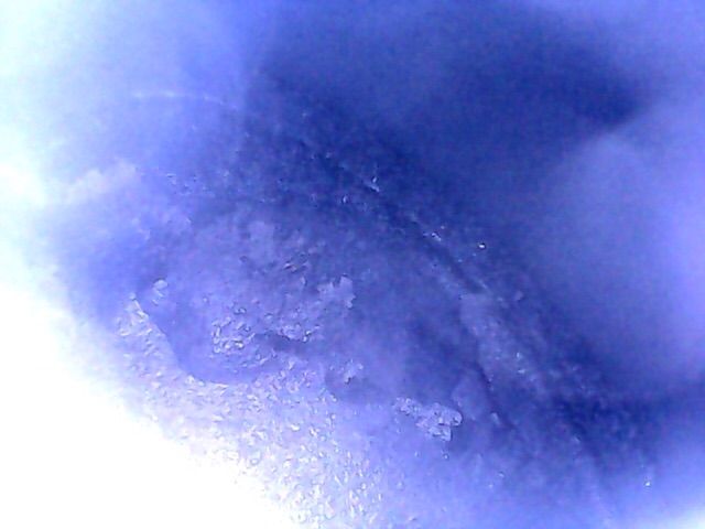

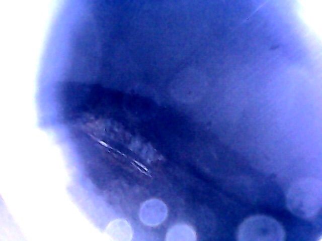

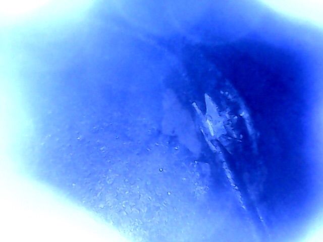

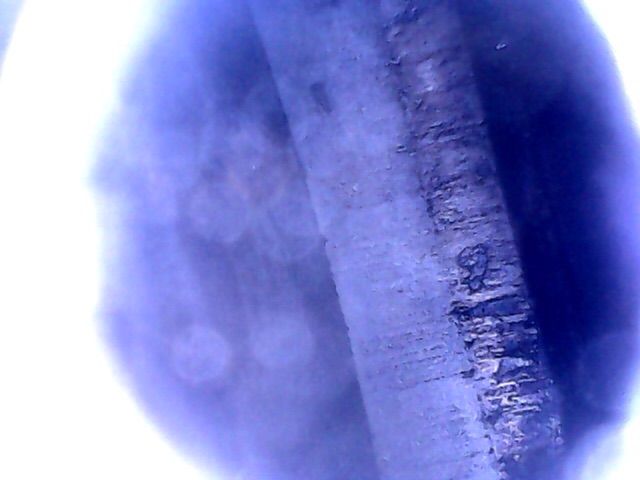

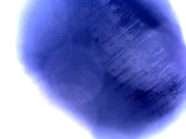

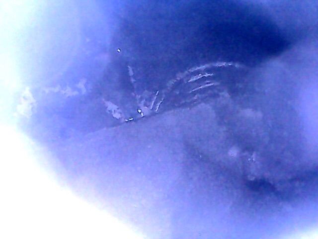

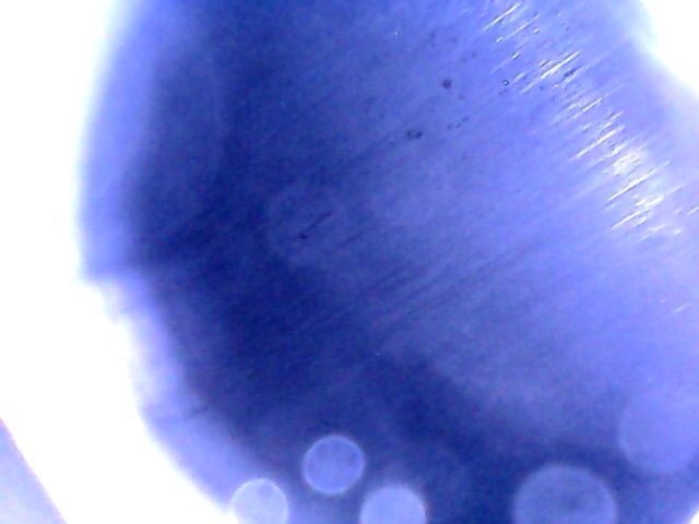

    So I finally had an opportunity to look into the engine today with the scope I purchased. Yeahhhh doesn't look good, you can see where valves hit Pistons also very scored cylinder walls.

    cylinders look like junk :( u need short block

    I just had the same issue with my b7 s4. Turns out the crank jumped timing due to a broken guide. Turned over where i could almost hear the starter more than the engine kinda like what you are describing. I pulled the intake (quite easy) and could visibly see that i unfortunately bent my intake valves. I found a motor on car-parts.com for 1200 with a bad upper oil pan,s so i gotta earn my savings. Wish you luck
