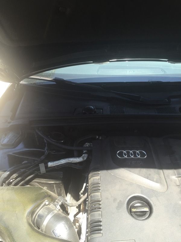

    Quote Originally Posted by blbroo View Post
    Just have to find a place to mount the dang thing.
    That's exactly it. It'd probably have to go in the trunk, and then I'd have to relocate the pump there too, rewire it, run all the tubing, etc etc. Be easier just to install the new level sensor into the washer tank.

    Quote Originally Posted by lettuce View Post
    What about the area under the cowling on the passenger side?

    [QUOTE=blbroo;11733135]What about the area under the cowling on the passenger side?
    I don't think it'd fit there. The tank is bigger than you'd think, and the cowl area is smaller than you'd think. Having a separate tank for each would be nice though. I've noticed I'm real stingy with spraying my windshield nowadays.
    That is where I have my Snow tank mounted. Just to the right of that air duct, pretty much center of that duct and the positive battery terminal.

    Quote Originally Posted by shaunm82 View Post
    And it fits in there? Nice. I wouldn't have thought that. There's even enough room for the tubing to come out of the bottom without bending, and you're still able to install the cowl cover?
    My only gripe with that would be having to either 1) remove and reinstall the cover every time I need to fill up the tank, or 2) cut a hole in the cowl to access it.
    Yeah, I had to trim a little bit of the underside of that cowl in order for it to fully seat, but nothing visible from the top side. But that is my issue now, having to remove the cowl every time I am needing to refill, which I have to do today actually.
    I thought of cutting a hole in it for easy access, but I didn't the look of a gaping hole just sitting there.
    Hm. Maybe if you mounted the tank high enough so that the cap would protrude from the cowl, and cut a hole in the cowl perfectly to fit the tank opening, you could make it look almost like it came that way from the factory.
    Think you are onto something. Since I need to refill tonight I'm gonna give it a shot~ Will post results!
    Awesome. First double check to make sure there's enough clearance between the top of the cowl and the hood for the tank cap. That's the only issue I can foresee with that. Something tells me there isn't a lot of space between the top of the cowl and the underside of the hood, but I've been known to be wrong about things like that in the past.

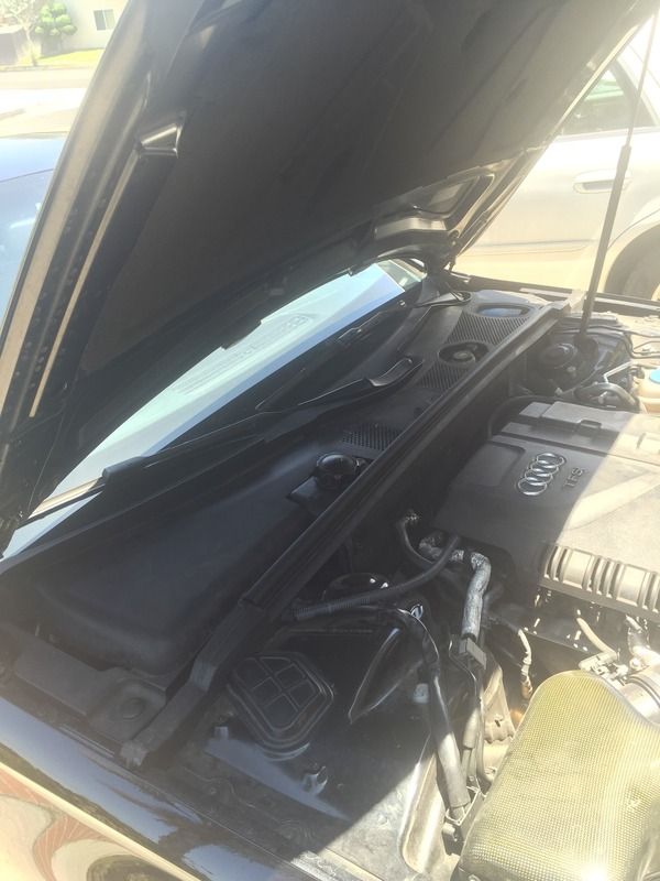

    You mean like this?
    - - - Updated - - -

    Quote Originally Posted by ddun View Post
    You mean like this?
    - - - Updated - - -
    Just ordered the Snow Performance 212 MAF kit. Will be doing the install exactly like this. Not going to tune for meth at this point. Going to run a 225 nozzle in the IE throttle body plate. Using the kit to cool IAT's while running a APR K04 kit. Down the road I may get the 100oct file and utilize the kit to its full potential.
    You mean like this?
    - - - Updated - - -
    I wonder how big of tank you could fit in that area. Blbroo told me to put my tank there a few months back when I was looking into the water/meth kit. Great spot and looks clean man!
