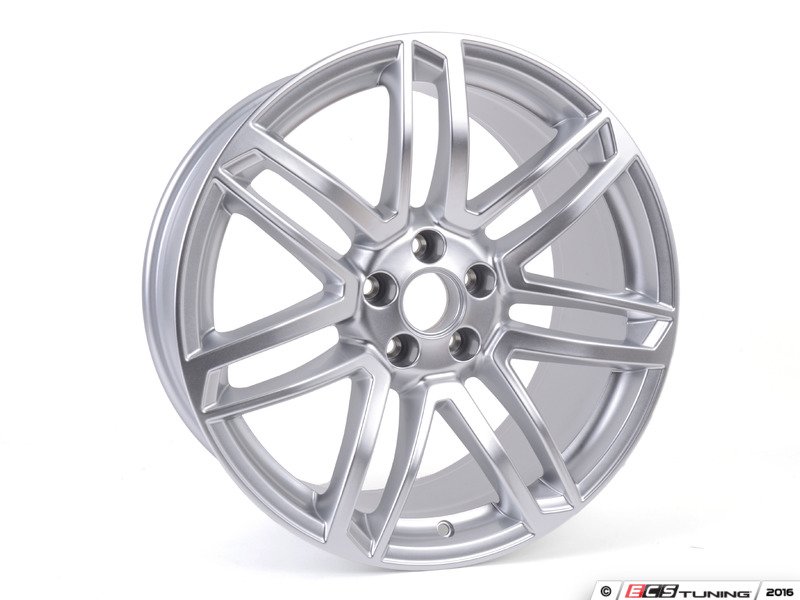

    I'm waiting on a set of (seemingly rare) used S5 Audi OEM Speedlines, Model: 3431, Part Number: 8T0-601-025-DB to install onto my 2016 S4.
    They were take offs from a B8.5 S5. I believe these wheels may also be used on the RS4 and RS6.
    These are the S5 wheel Specs 19x9 ET33 and (Pirelli P-Zero) Tire Specs 255/35/19.
    My 2016 S4 is stock height and I have no plans to lower the suspension.
    Based on this thread and other research I've done these (S5) 19x9 ET33 255/35/19's should sit flush on my S4 with no rubbing.
    Has anyone else seen someone running these wheels on a B8.5 S4 before?
