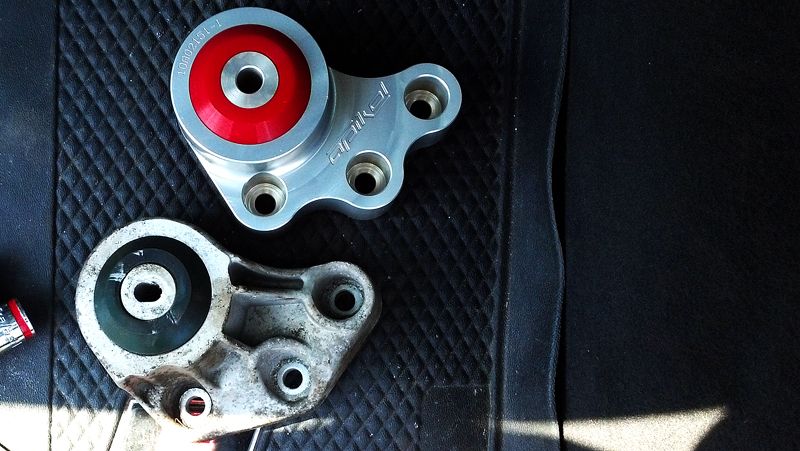

    Apikol Rear Differential Mount (Red - Race)

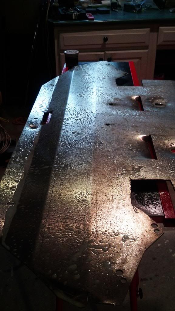

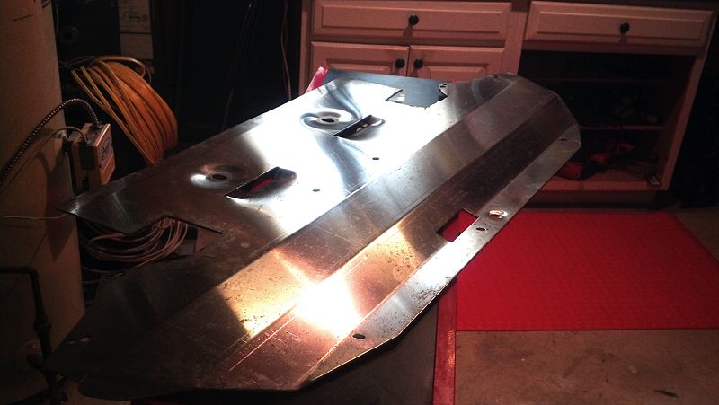

    Dieselgeek Panzer Aluminum Skid plate

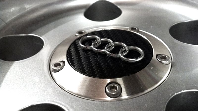

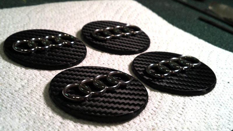

    Custom 4 center caps

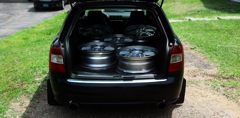

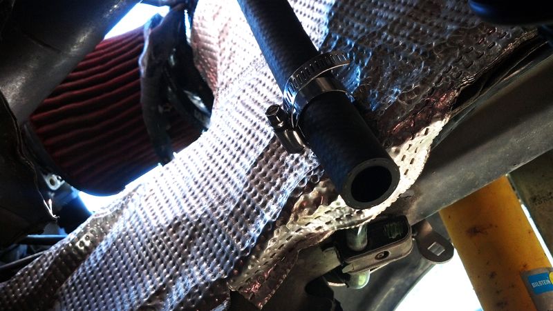

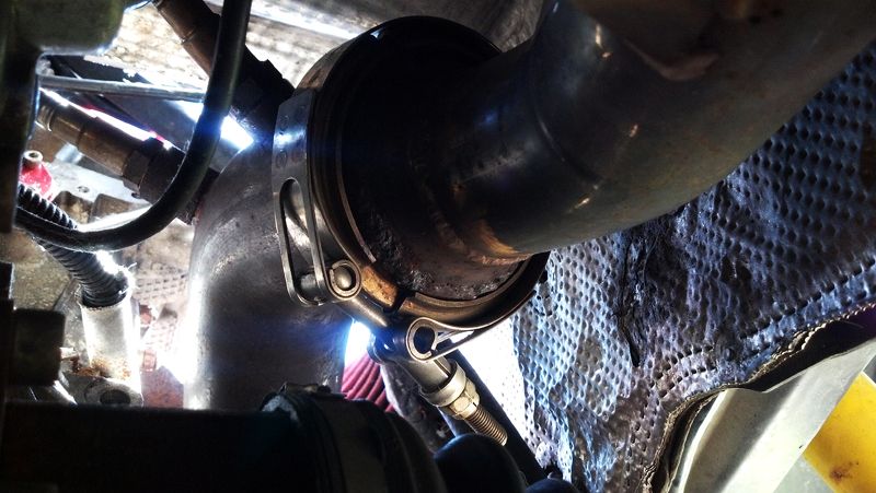

    I was so excited when I took delivery of her that I didn't even go for a test drive. It had a K04, APR exhaust and other modifications.
    Here's a pile of 'junk' parts an hour after parking it.
    I was just about done removing parts at this point

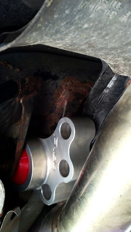

    I bought 034 Motorsport Track density engine mounts before receiving the car. Almost all of my mounts are upgraded so I figured I'd do the engine mounts while I was tearing it down. I had no idea the stock ones were toast.
    Getting buttoned up!
    Nothing a little Mother's couldn't take care of
    And then she was alive
    More to come

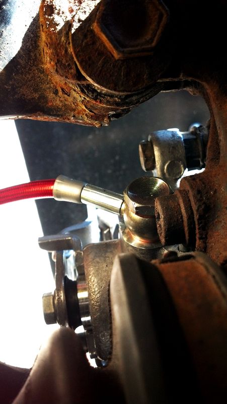

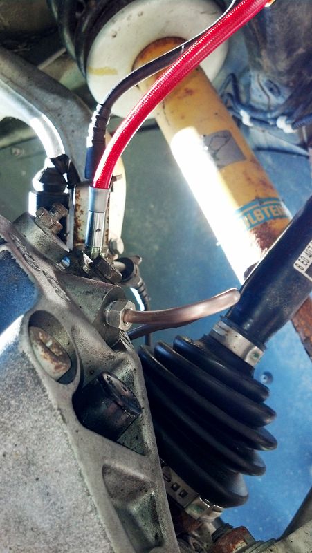

    Installed USP Motorsports metal slave cylinder and braided steel line. You can see some JHM content in the back there.

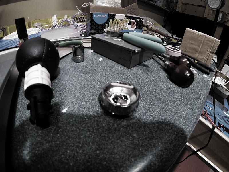

    Couldn't find the right sized allen socket, so I used a spark plug socket in reverse with a 1/2" drive. Worked perfectly

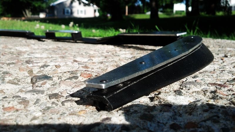

    Removed the ABS bracket for modification.
    All cut up and painted with some flat black enamel
    Installed. So much room for more activities!

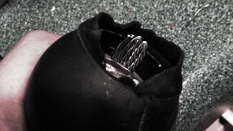

    And of course I had to do the paper clip mod. I used a paper clip and pliers on my previous B6, but found a much easier way to complete the job.

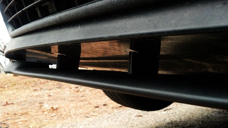

    The dirty girl is earning her name still. I found that my J-plug is slowly leaking. I called the dealership to find out that they sell it for $18 so it looks like I'll be ordering that online. I need to do something about my license plate frame and hardware as well.
    - Scott
    Das Build Thread
    Performance parts for sale:
    MagnaFlow Race Muffler - Vibrant 4" Filter - MAF 4" Housing
    Veteran Member Four Rings Molotov's Avatar
    Feb 24 2007
    15888
    2005 USP 1.8TQM Avant
    Burlington, Vermont
    I got around to changing my leaky j-plug the other day. Here's a shot of the puddle that had formed on the block's lip
    I grunted and cursed for far too long before removing everything to get a better angle on the plug. It would not budge. A clear view of my ghetto coolant hard/soft pipe as well haha. I will be fabricating a new hard pipe to clear my SEM intake in the future.
    I decided to reuse my coolant at this time. Planning on doing my timing belt and coolant flush this spring. I filtered the used coolant through a shop towel and this is what it picked up... yikes!
    There's also a distinct vacuum sucking sound coming from fuel injector #1. It isn't sealed very well at the intake manifold, so new top and bottom o-rings are on their way

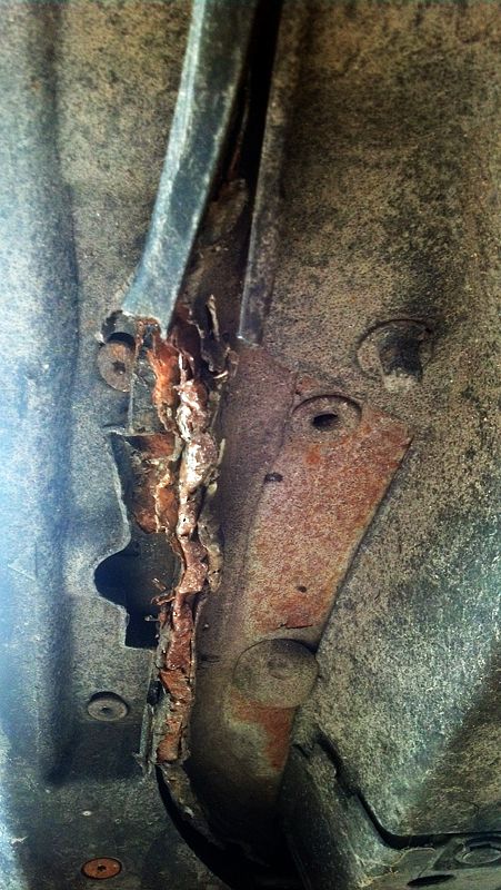

    And I just placed this order today. My front left frame rail jacking point is busted, so bring on the RS4 jack pads!

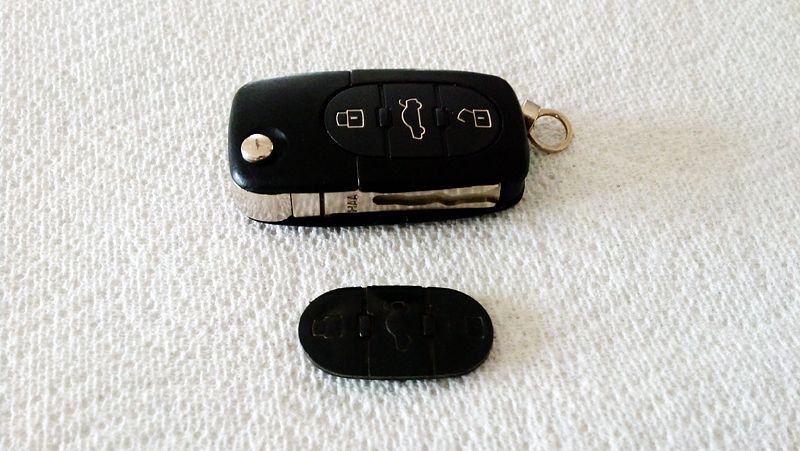

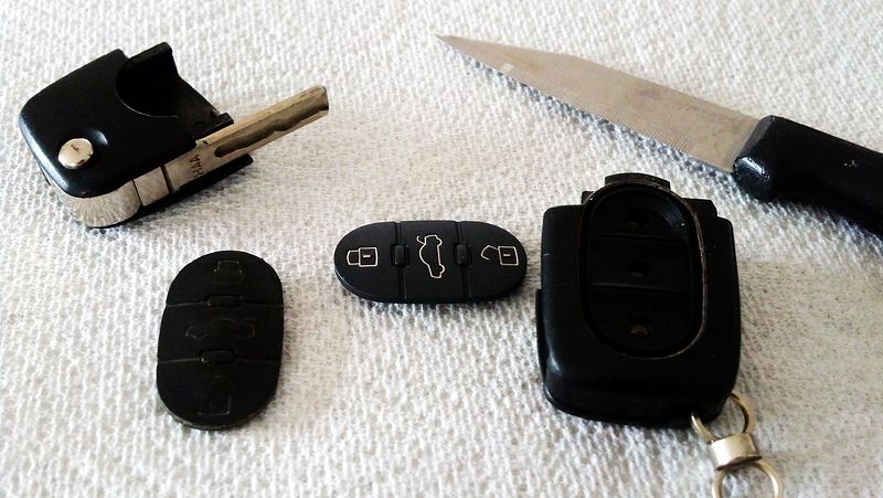

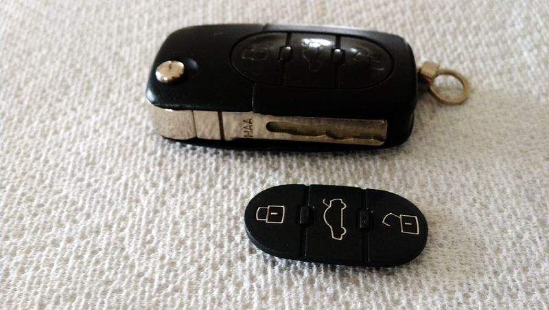

    Got a box.
    It also had this in it
    Separating the key seemed to make button pad removal easier. I didn't want to mar the keyfob further
    Oh, there was another box as well..

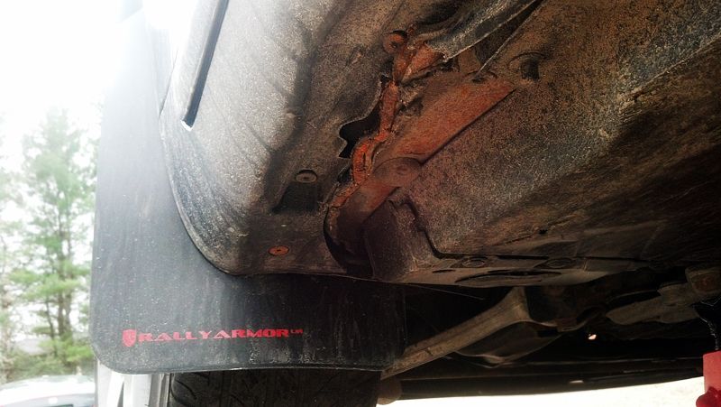

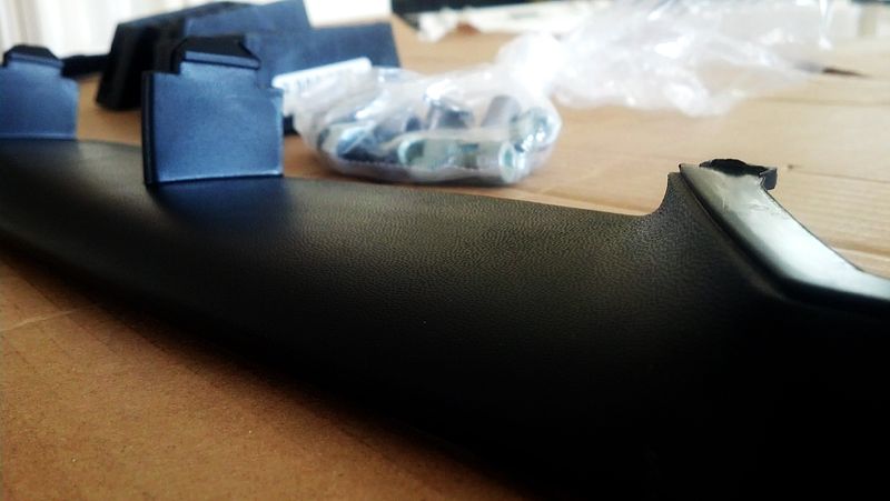

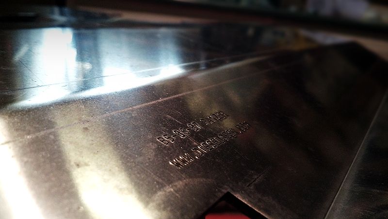

    I need to update this a bit. Back to 05-14-14.

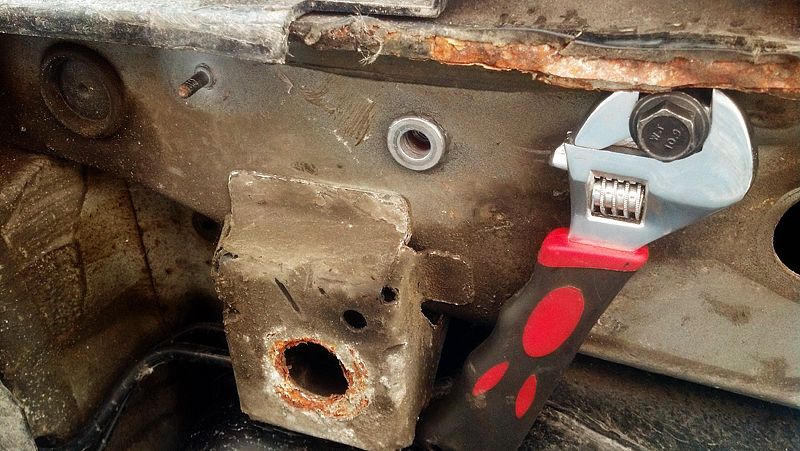

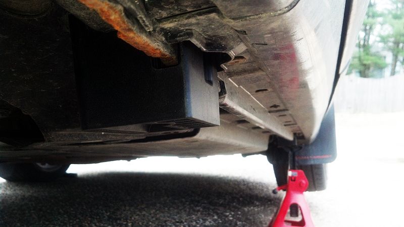

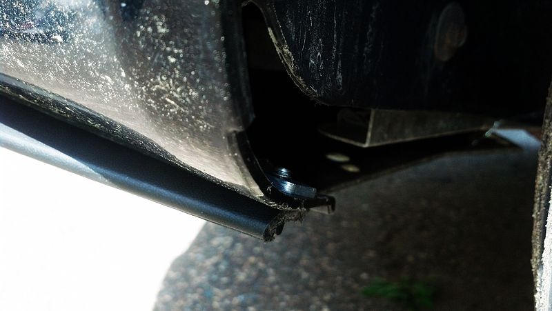

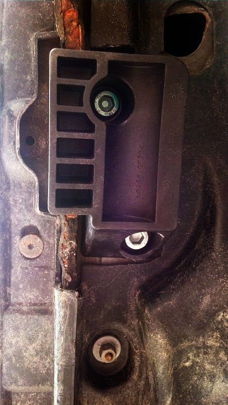

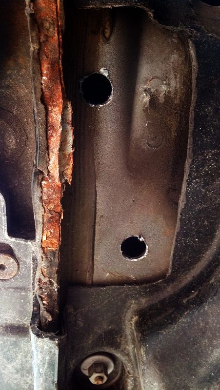

    It was clearly time to upgrade to some RS4 jacking points. My frame rail wasn't feeling the floor jack so much...
    "Straightened out" with some vice grips
    Rear jack being fitted and traced
    Plastic cut and reinstalled
    Drilled out
    The tool
    Well nuts and epoxy
    Cheapo adjustable wrench used for install
    Already being put to use
    They hang down a little bit...
    And some friends' B6's
    This one just had some OEM 19" RS4 wheels put on. They poke out a little too much in the front but otherwise look good

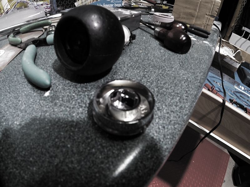

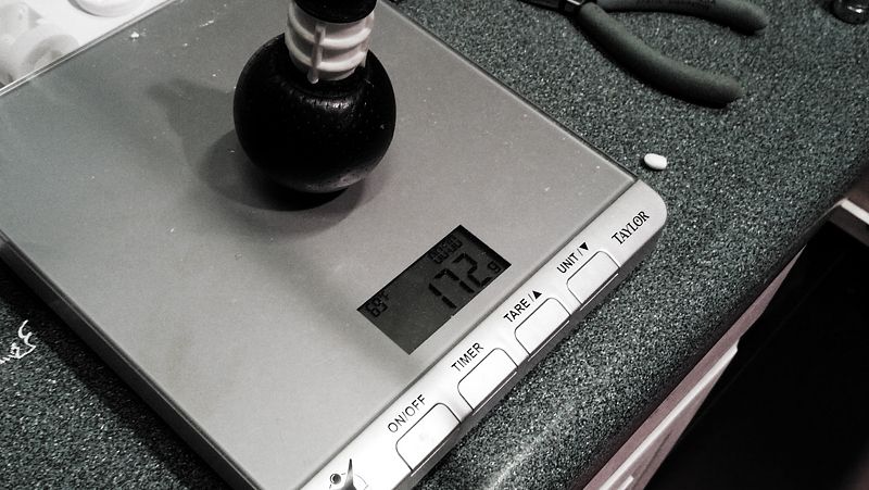

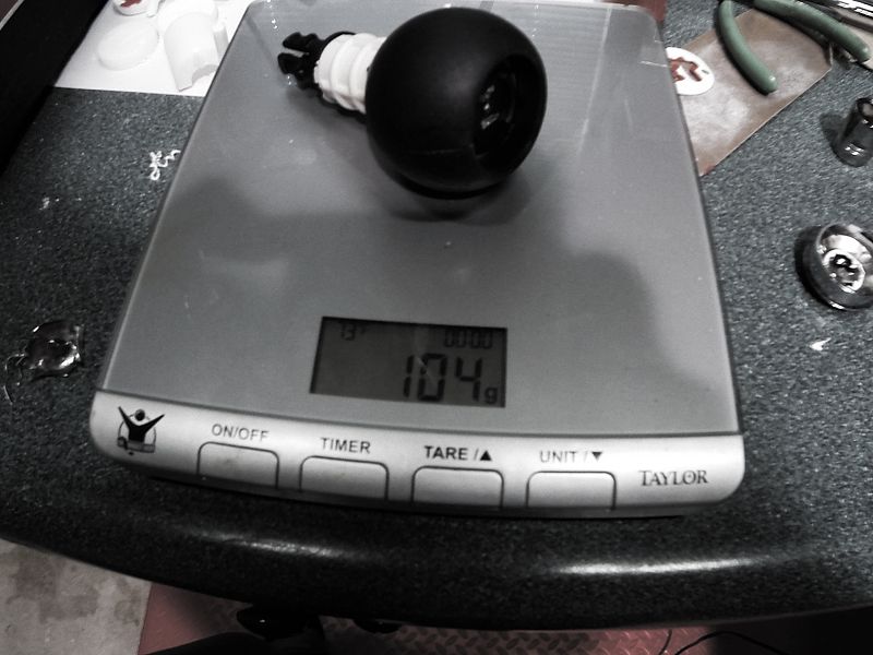

    I wanted to see how much weight I could add to my shift knob with materials that I had laying around. I used a 1/2" drill bit, dremel with sanding attachment, duckbill pliers, wire cutters, aluminum foil, solder and soldering iron.
    The cap fits snugly without clips, so those were removed.
    Weight with some material removed. The unmolested knob weighs 110 grams. I actually drilled into the center and removed more material. I didn't take as many pictures as I intended to.
    There are 3 slots that I stuffed twisted solder into. This added about 1.5 grams.
    Final weigh in at 172 grams. That's a 56% increase in weight for free.
    The weights were created by doubling up aluminum foil and fitting it tightly into the cap and the knob cavity that was created with the drill and dremel. I removed the foil carefully to not disturb it's shape. I then dropped solder into the foil with a large iron until it was full and let it cool. I probably could have been more meticulous with the material removal and dropped lead in for more weight, but I was just screwing around.
    The idea is that a heavier shift knob has more kinetic energy, and when it is put into motion it will engage the next gear more easily. I gotta say, the JHM trio feels even smoother with just 62 grams added to it. I'm happy with the results

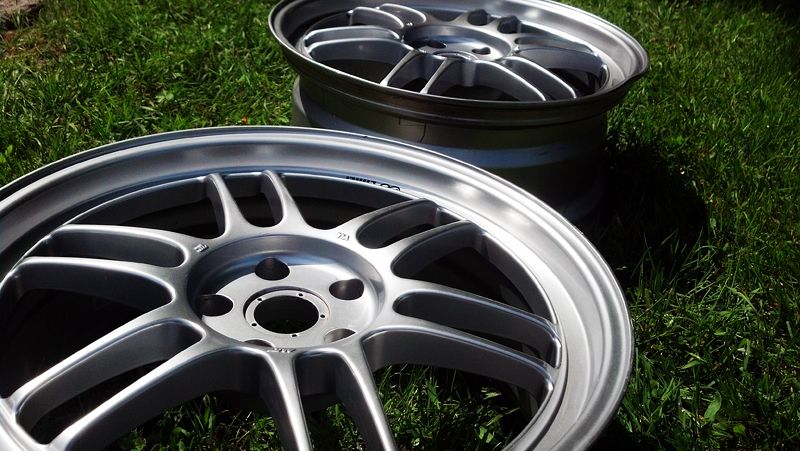

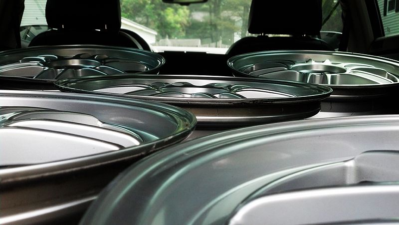

    06-17-14
    Time to fix some RPF-1's
    Cleaning them up
    Can you spot the bend?

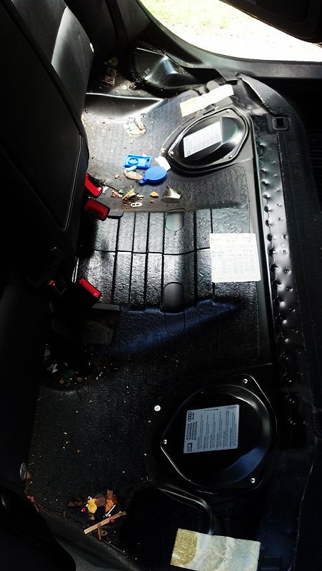

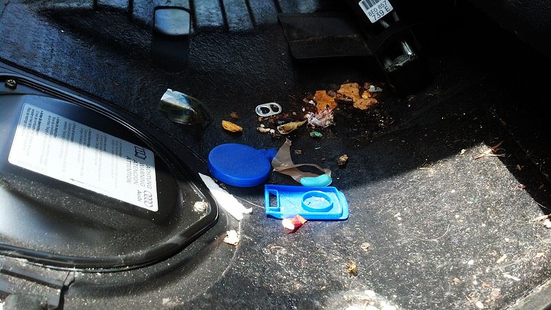

    Found some treats from the PO when taking out the back seat
    Loaded up and ready to drop off.

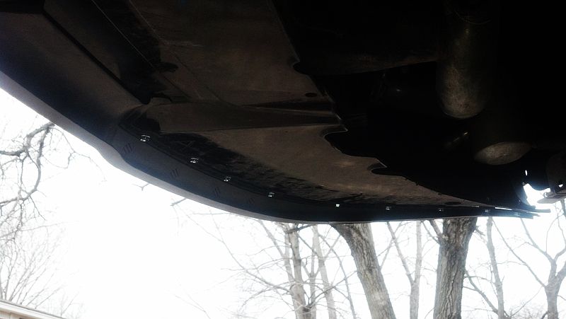

    06-29-14
    So this happened...

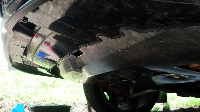

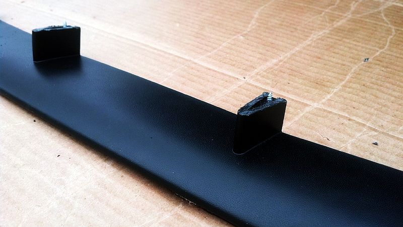

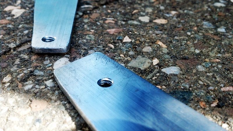

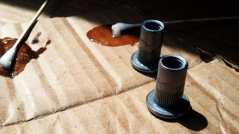

    All of those self tapping screws didn't pay off. It was time to get serious.
    Custom brackets tapped for 1/4-20 bolts. I got the aluminum bracket idea from tankdeerpat.
    Bolted on with loc-tite.

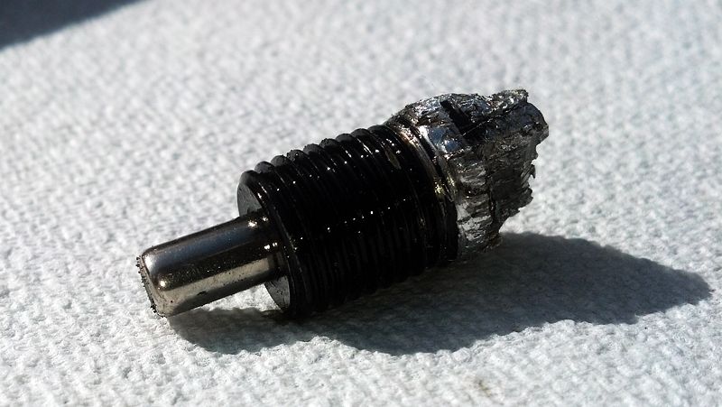

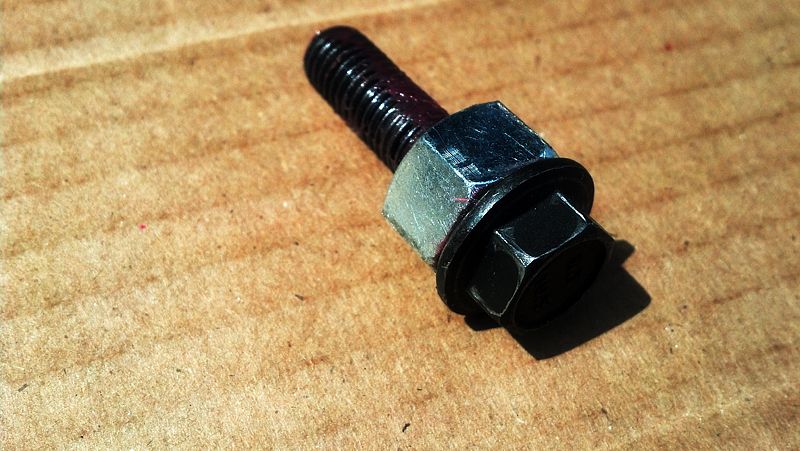

    I also thought it would be a good time to do my overdue oil change but the magnetic ECS drain plug had other thoughts.
    It stripped with the correct 6 point socket. I hammered on another socket and put some heat to it. It stripped more. I then slotted it and tried a large flat head screw driver with a vice grip attached. The plug was so soft that the screw driver started to open up the slot.
    No more fucking around time. Squared it off and vice gripped again with heat.
    All that remains. Luckily I had the original drain plug to throw back in.

    Damn that doesn't look like the drain plug was of good quality. I can't believe you had to hack it up that much to remove it.
    Feb 24 2007
    15888
    Burlington, Vermont
    Quote Originally Posted by JEENYUS View Post
    Yup. I'm not the only one who had to do it. It's a very soft metal. I found multiple threads on teh webz about the ECS drain plug stripping.

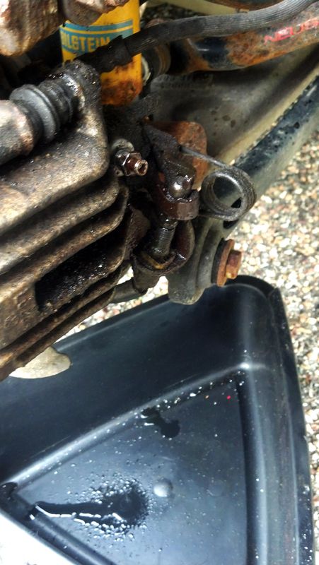

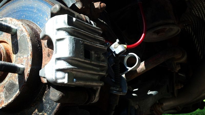

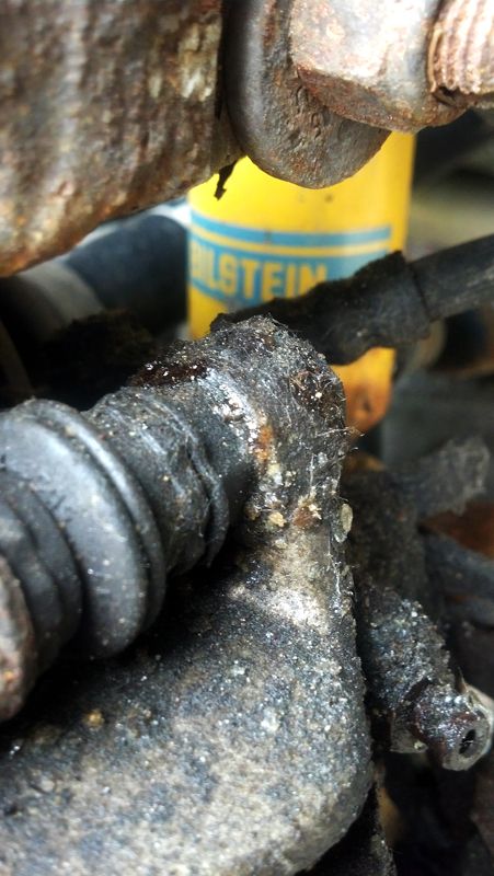

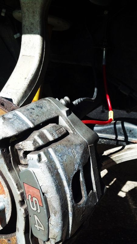

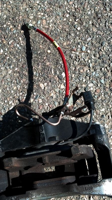

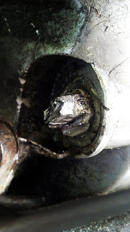

    Wheels are ready to swap, but what's that fluid?
    I picked up my newly straightened wheels and headed home to swap them over. I completed the passenger side wheels and made my way to the driver's rear. It was apparent that something was leaking in a bad way upon removing the wheel. There was fluid coating the inner barrel of my Avus wheel.
    The caliper was coated in fluid and the dirt that it attracted
    The bleeder screw appeared to be wet. I wiped everything off and tightened the screw a quarter turn. This caused a faster leak.
    The bleeder screw had stripped out the threads in the caliper.
    So here I am with my freshly repaired wheels and a ruined rear caliper. So what do you do?
    Buy more parts!

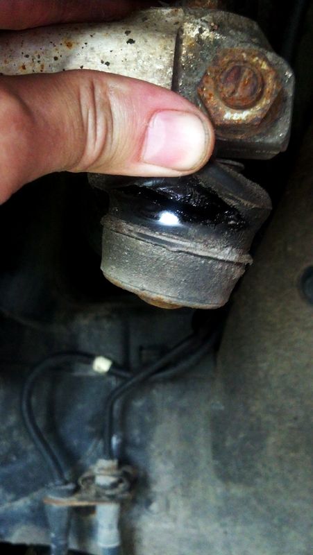

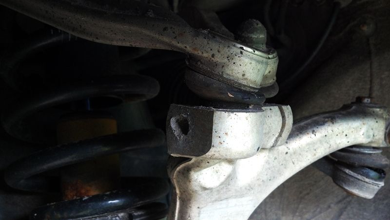

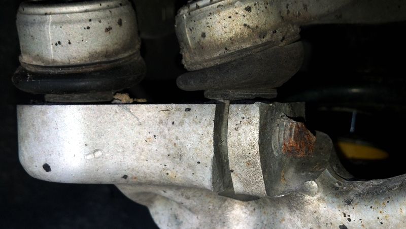

    This wasn't the end of problems though. I found the driver's side tie-rod split. I also noticed that somebody had previously attempted to remove the pinch bolt, with zero success I might add.
    I still have a full control arm set with upgraded swaybar end links and full metal S4 tie-rods, but seeing the pinch bolt like that had definitely discouraged me from attempting to install them. The tie-rod was also seized.
    But wait, there's more!

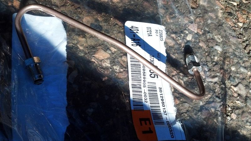

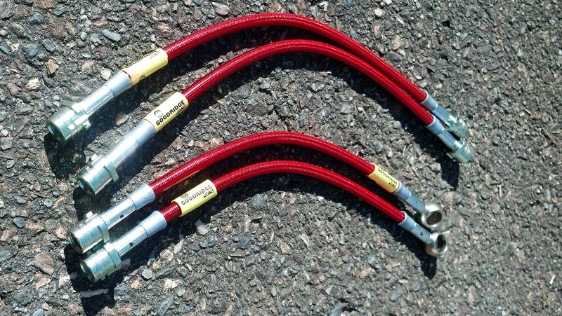

    I had to get new B5 S4 front caliper hard lines. The flare nuts on the original lines were also seized. They twisted the line and cracked it. The car was down for another week as the hard lines were not available locally.
    New hard line and Goodridge SS line installed
    New rear caliper installed with line

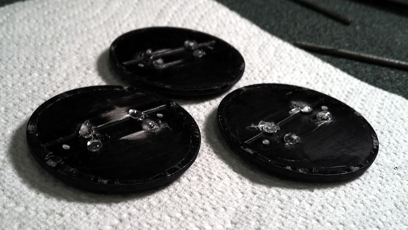

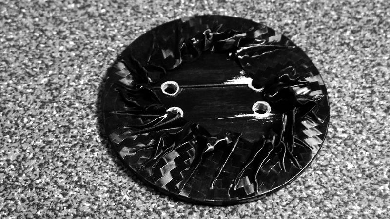

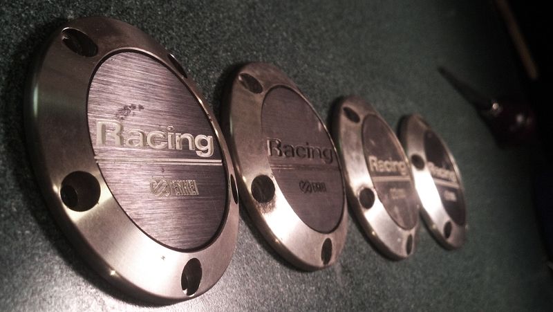

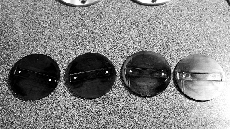

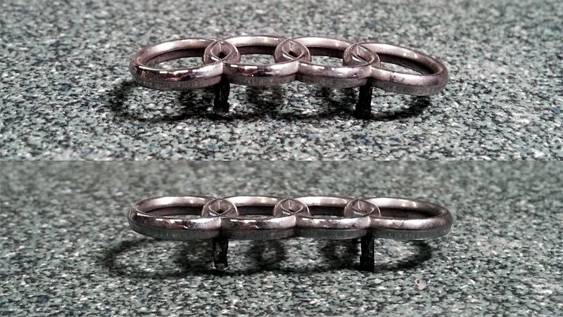

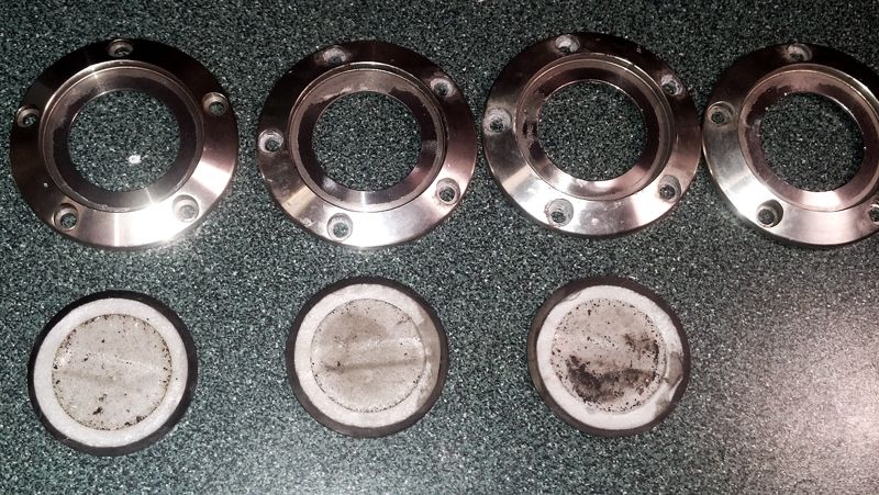

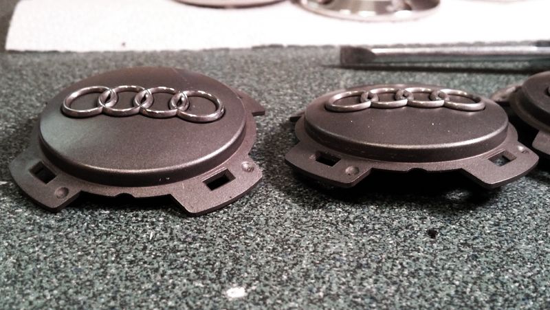

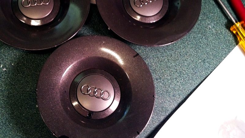

    I decided to change up my center caps while I had some down time with the brake issues.
    Original Enkei racing center caps
    Popped these out
    Cleaned up
    Found some rings laying around...
    Drilled out the backs
    Before and after heat gun. Too much curve for my flat caps
    3M 1080 Carbon
    - Scott

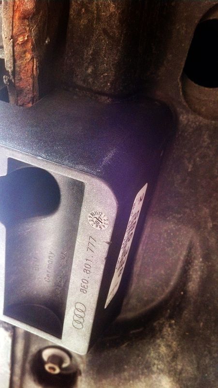

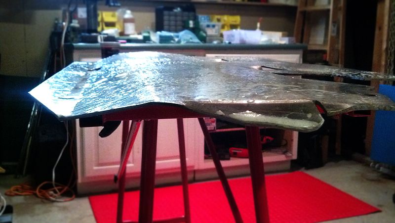

    Here's a shot of my Eurocode E-pipe test pipe with AFR sensor bung and v-band flanges. Flanges were MIG welded on.
    I found that my crankcase/valve cover dump had been rubbing on the axle and wore a hole through it. I cut it short and worm-clamped it out of the way.
    Apikol Race rear differential mount vs. what I thought was a stock mount. Turns out the other mount was an old version of the Apikol street. I'm not sure what this is worth.
    In it's new resting place.

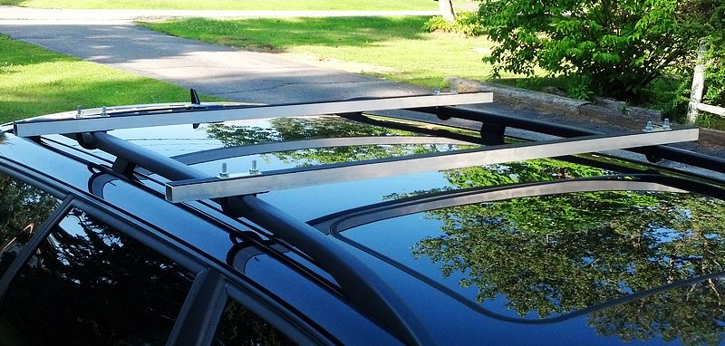

    I was nominated to drive to Saranac Lake for a camping trip. I had no way of attaching a canoe to the Avant. Luckily I only had to attach some cross bars to the roof rails. I fabricated these just for the weekend. They worked out well but I didn't get any pictures with the canoe on top.
