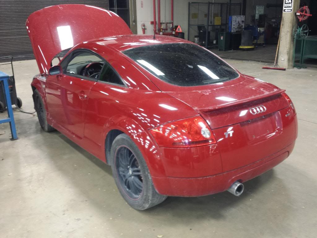

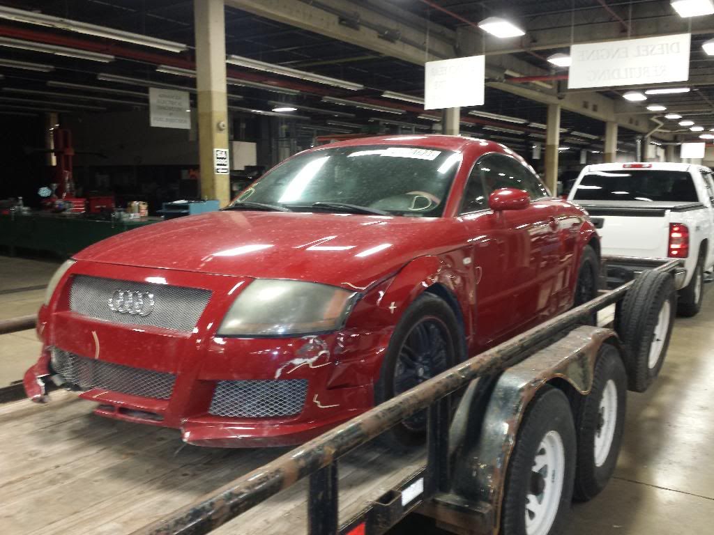

    I thought I would share my latest project with you guys. Nothing special, at least at this point. Its an 01 TT Quattro 180 that I bought off the auctions for a song. It was in pretty rough shape to start out even though from the pictures its hard to tell. I actually was talked into it by my dad who spends more time watching auctions than actually working. Damn government workers :p
    Ill start out with this: I am NOT a body guy so going into it I was a little uneasy. I have always been comfortable with anything mechanical and I am a bit of a suspension junkie so I knew that part would be easy. This will basically be my way of learning fiberglass and paint.
    So this is what I had to start with. Hood is straight and both lights got missed. Lucky because on a quick look they are around $700 each
    I ended up tossing the bumper and fenders because I didnt want to screw around trying to repair them. Just for fun I called the stealership to see how much a new OEM front end would cost me. $2800 but he would discount it to $2200 for me since I was buying so much. No way.

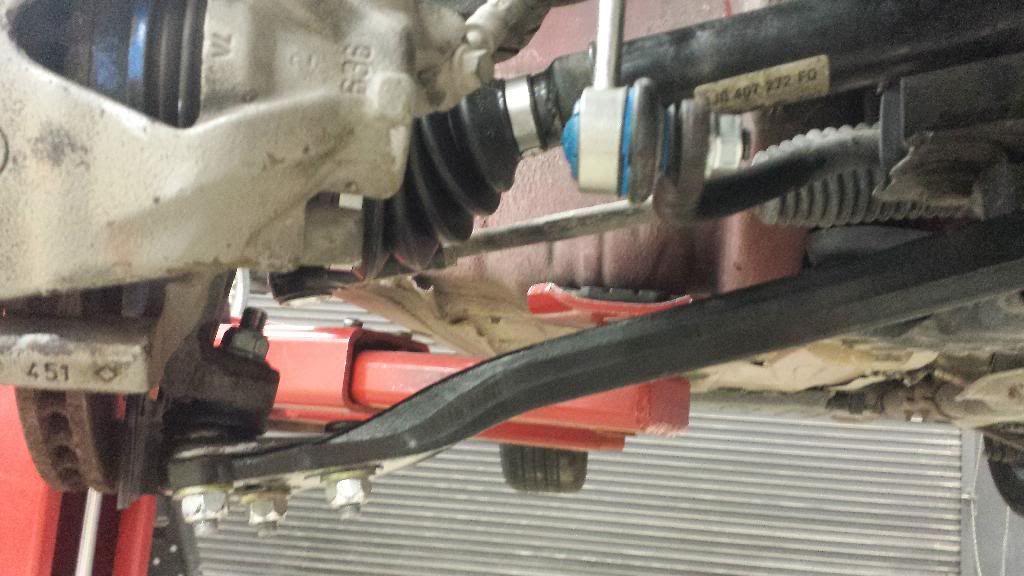

    I bought some Meyle HD control arms, tie rods/ends, and ball joints. Some new CV boots to finish it up and its nice and shiny underneath.
    I aligned it and drove it around a little gremlins are coming out. PS pump is whining and im getting some clunks from the rear end. ABS light is on but from what I understand its a common problem. Ill get to those things later I guess.

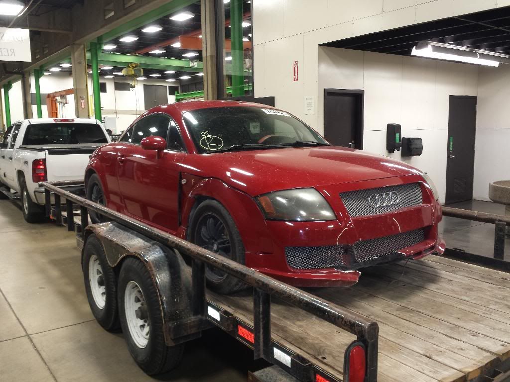

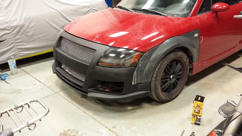

    Found a few fenders from the scrapper for $300 and a local guy had a new Duraflex bumpe. A core support had to come from the stealership unfortunately.

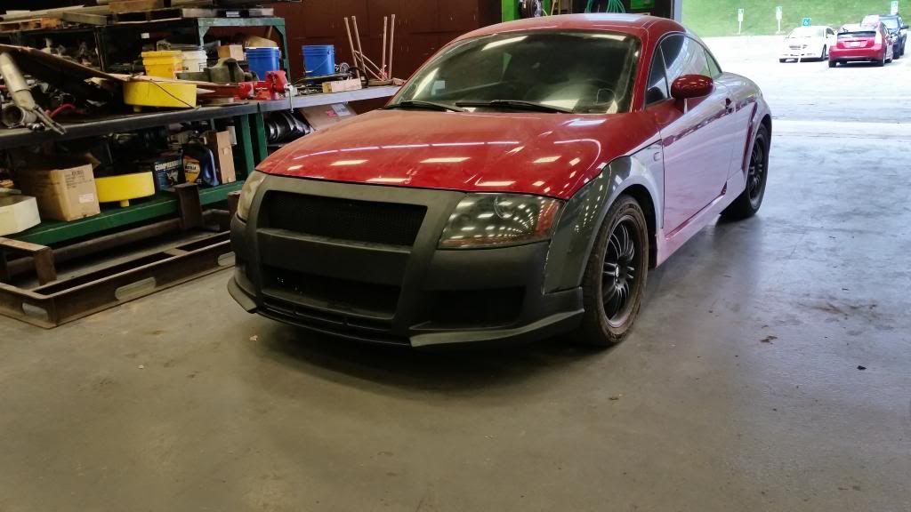

    Along with a quick polish on the headlights this is where I currently sit. big difference on the headlights but they need more. Not quite clear enough for my taste yet. I temp mounted the bumper until I have a chance to get it back on the lift and actually make some alignment adjustments.
    Any suggestions on mounting the bumper and getting the seams straight will be appreciated. I managed to get the fenders aligned pretty easily but the fiberglass bumper is pretty rough and the edges arent quite straight. Obviously its going to need a lot of prep. I still need to make the corners fit better and do a bit of sanding and filling. The plan is to paint the whole car so I dont have different colored panels and so i can take care of the clear coat rot on the back.

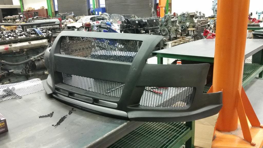

    I started out by continuing work on my fiber bumper but I have realized that I just dont have the time to do the fiber work on top of painting the rest of the car so i ended up buying an OEM bumper even tho I like the look of the fiber one better :( The fiber one is up for sale if anyone wants it. 400$ shipped.

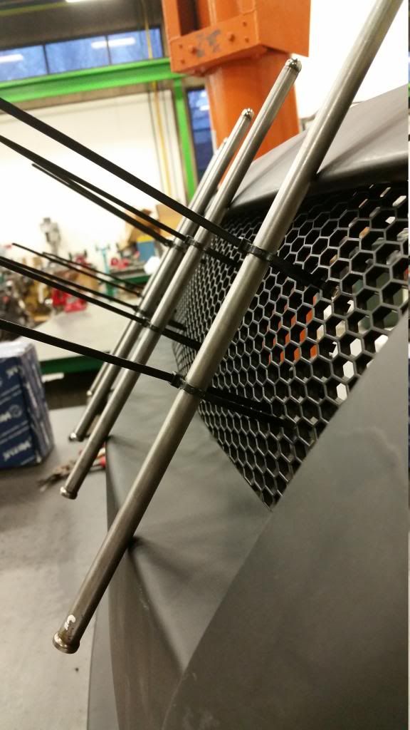

    I replaced the grilles with black ABS mesh and it looks WAAAY better, and they dont need paint :D
    lower sides

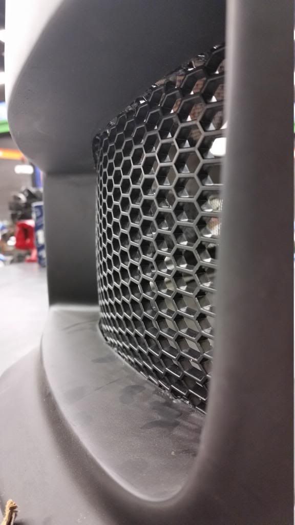

    putting a little curve to the main grill to match the curve of the bumper. A little bit of pressure and some heat to set it in. I had a few old pushrods laying around that were perfect for this.
    and the final product
    I am still looking at doing a honeycomb grille or something on the OEM bumper. not sure about badgless or not yet

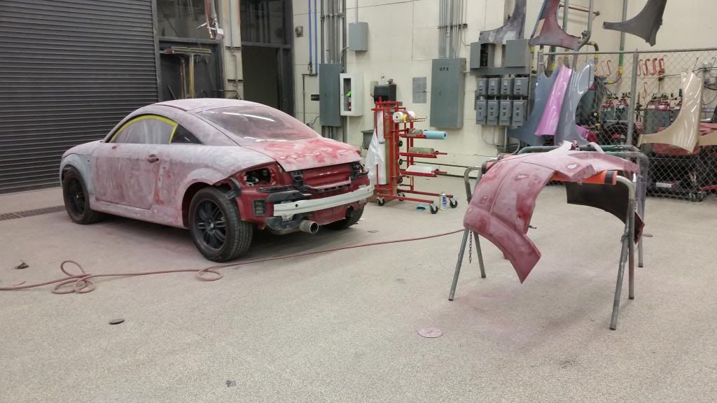

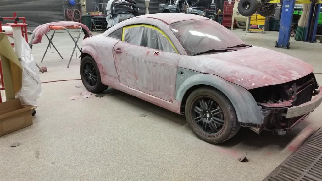

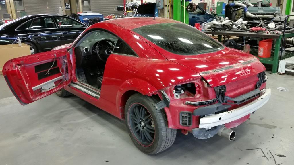

    I spent about a day an a half pulling plastics and stuff off to get ready for paint. The glue they use on the rear spoiler is a royal bitch to remove! I dont recommend trying to remove it unless you plan on painting the rear hatch.

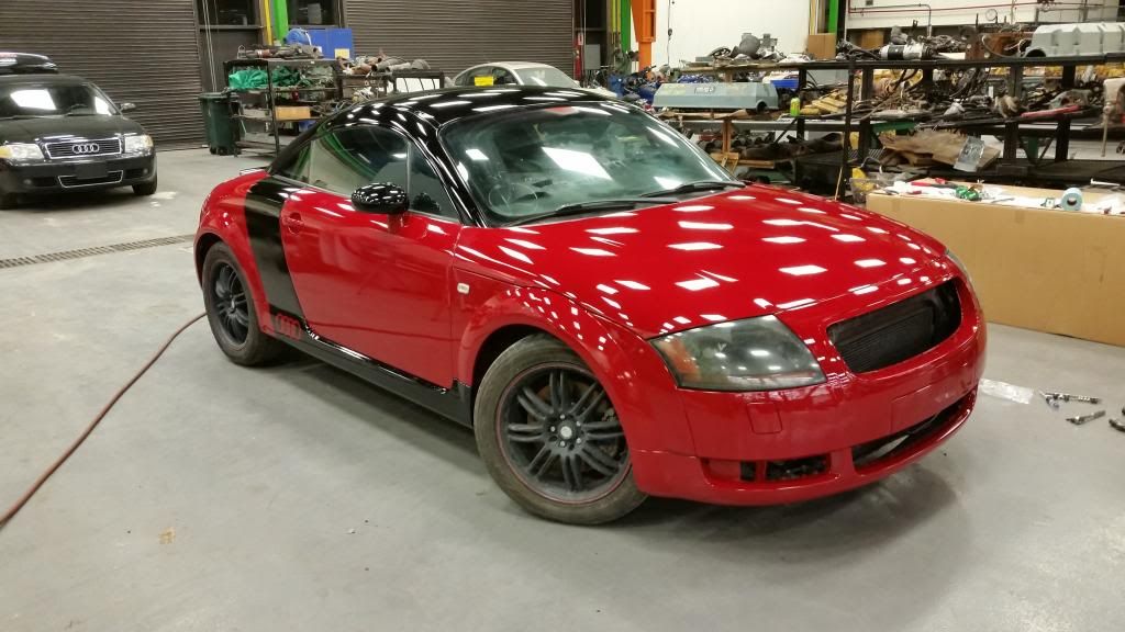

    Currently this is how it sits. I hope to have primer and sealer on today and maybe some paint later this week. Other than the initial damaged panels the rest of the car is really straight. A couple small dings and mostly just rock chips.
    I have been considering a couple options for paint. All red the way it came, Audi QS...
    or something along these lines
    I cant wait to get it on the road so I can start wasting my time and resources on performance parts!

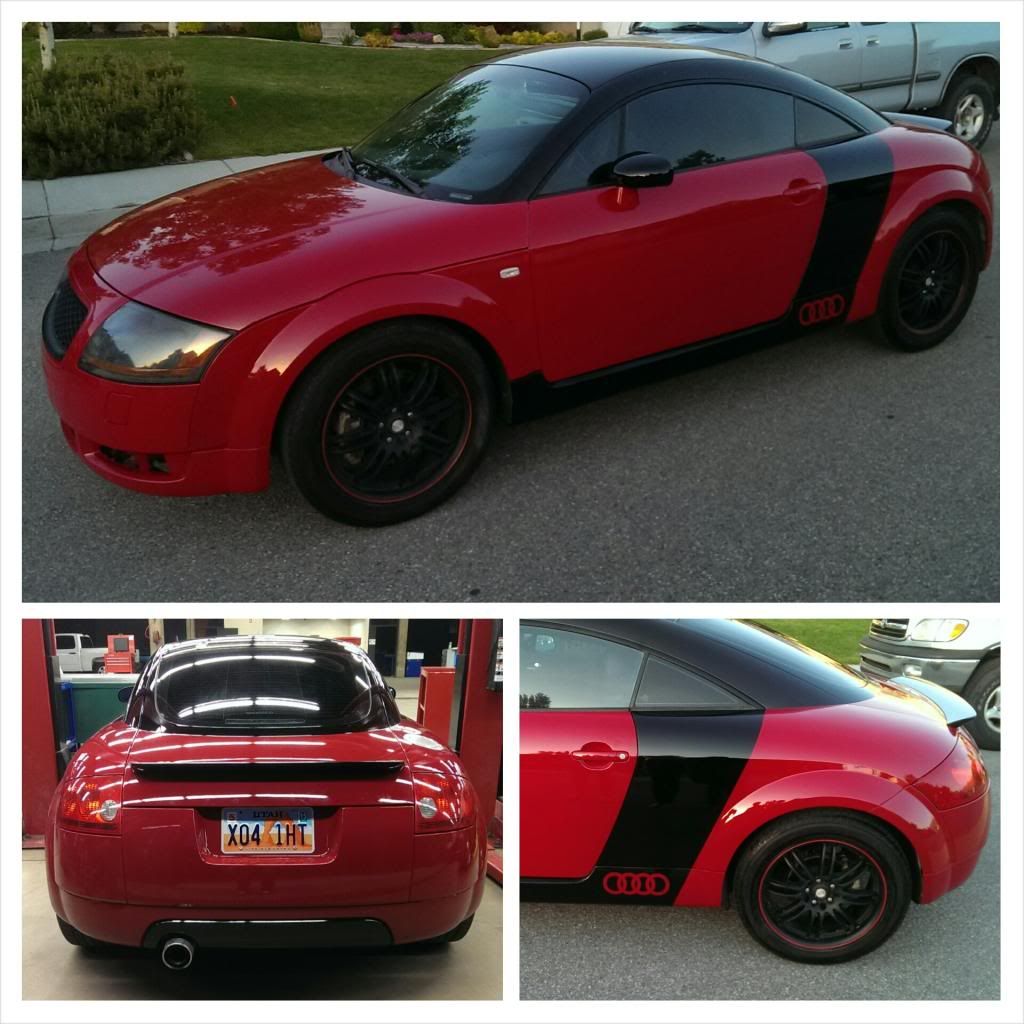

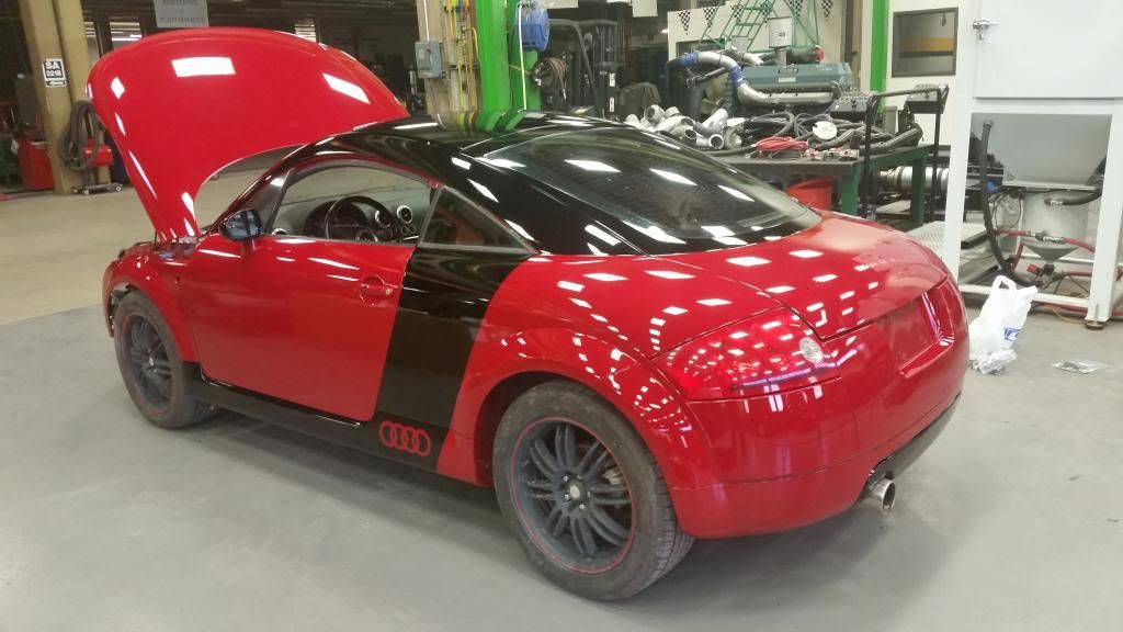

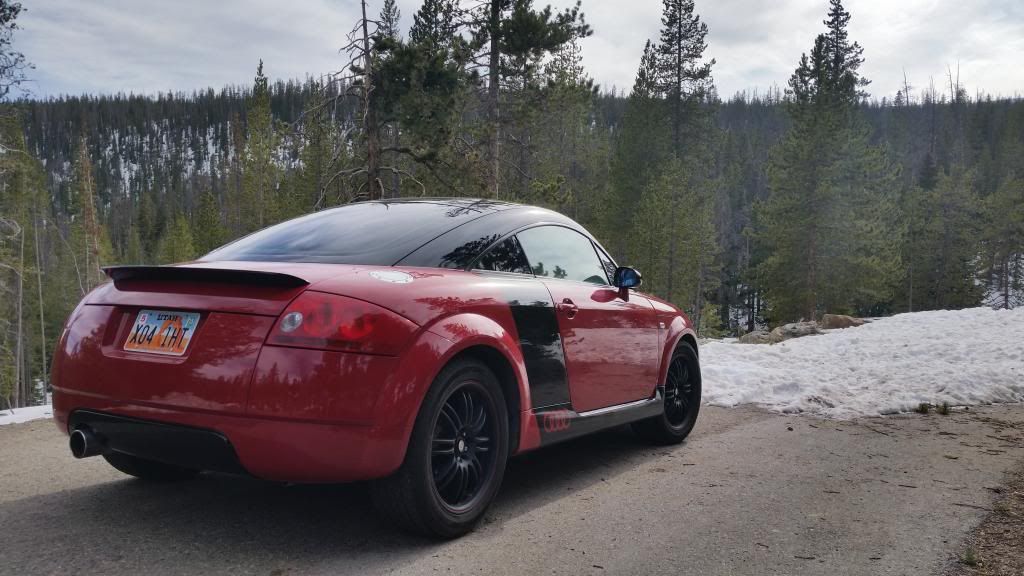

    Paint is done! Let me know what you think

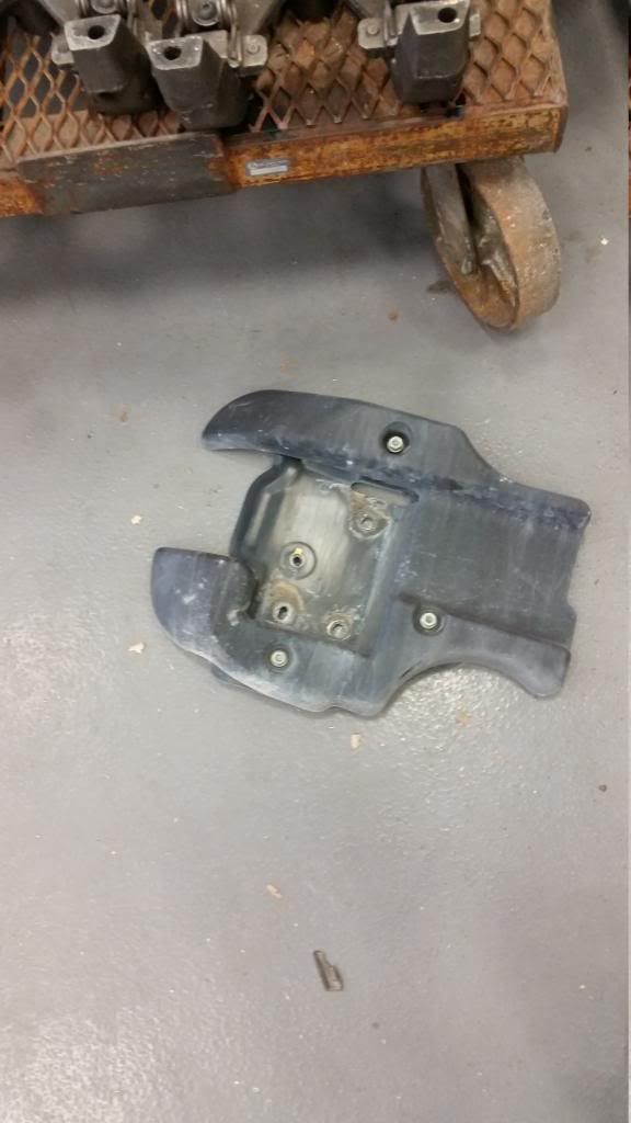

    did a little bit of weight reduction while i had the bumper off too.

    I have spent the last several days cutting and buffing the clear coat and its looking fab.
    I think next step is coilovers and wheels. maybe Motegi MR116 18" or something. I like the colors of the existing wheels but not the styling

    What is that part you took out for weight reduction?

    Its a counter weight that audi added as part of a recall in the early years (2000 i think?) along with some suspension changes and the rear spoiler.
