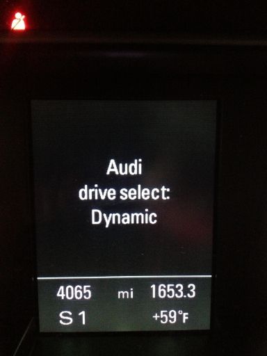

Enable Audi Drive Select
http://www.audienthusiasts.com/VagCom_FL_ADS.html
Working
My adaptation settings are as follows:
Channel 66: 47
Channel 65: 3
Channel 64: 3
Channel 63: 3
Set channels 63-65 to 1, 2, 3, or 4 to set the ADS default to Comfort, Auto, Dynamic, or Individual, respectively
