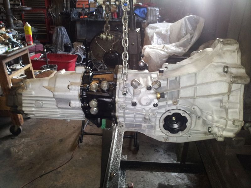

    Okay it looks like I should be getting the swap kit pretty soon from Scott @ Advanced Automotion! Hopefully once the shop receives everything we can start going through the parts and maybe get some pictures.
    In the meantime, here's a pic Scott sent me of the rebuilt tranny on the test bench!
    Can't wait to finally get started on this project and see the difference in the car once the 6 speed is in. I'll be MORE than happy to finally be rid of the TIP!!!
    Aug 25 2010
    63236
    I have never seen such a clean 01e :)
    Now hurry up and get it in your car so you can launch the hell out of it!

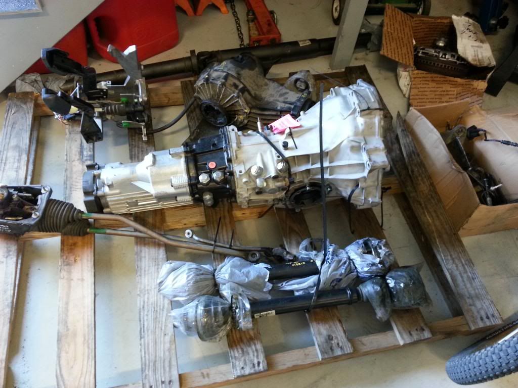

    Okay so after a longer delay than I anticipated, the swap kit is in route! It was picked up last Friday and I'm hoping it will arrive at the shop tomorrow. Of course with the Memorial Day weekend they won't start going through everything until later next week. Hopefully I can get some pictures once it arrives and then we can work out a plan for beginning this swap!!!

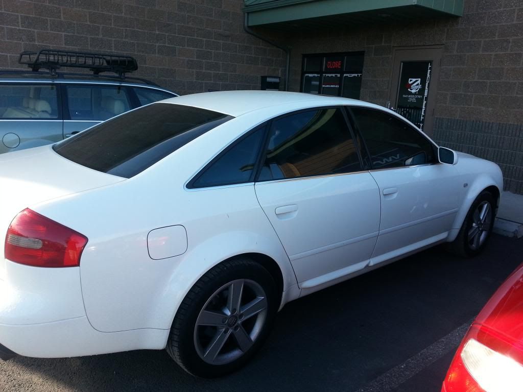

    Okay the day to begin this swap is FINALLY HERE!!!
    Dropped it off at the shop this morning.
    We had received the kit, but where waiting on a few smaller parts to arrive before pulling the TIP.
    I'm hoping I can get out of work early enough to get down to the shop later today and take some more pictures in the different stages. Hopefully once I get this damn TIP out and replaced with the 6 speed, we won't have any more issues with the f*%#@!*& transmission that has been a nightmare with this car! As it's a 2000 4.2, I need to have them pull the ECU out and send to JHM to get the proper flash done and from what I hear will also make a decent increase on the performance side as well.

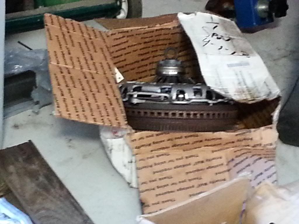

    Are you using a double mass flywheel ?

    I'm using a B5 RS4 clutch and flywheel, which I believe is the dual mass flywheel.
