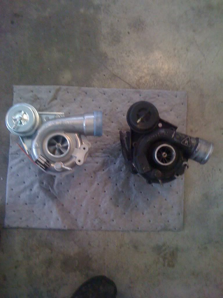

    I have installed the Frankenturbo already and I am currently trying to figure out what i'm doing about tuning. I have GIAC already so I can get a PC16 (KO4 Hammer File) for cheap. With Doug's help (Frankenturbo Genius) I believe I can make the PC16 file work. My hopes are at least 300ft/lbs. GIAC claims 295ft/lbs with just a Ko4 and this Fh4-L I know will destroy a ko4. Here are some pics of the install. More to come with updates on software. Current set up. 97 A4 1.8t Quattro. Intake Spacer, 034 silicone hoses, Apikol SMIC, Frankenturbo set up (turbo, TIP, 3in MAF). 3in testpipe to 2.5in exhaust with single muffler. Once I get software I will be dynoing at AWE tuning.

    I put new oil feed line on. Don't have to but my car has 200k miles and i figured it wouldn't be a bad idea. If you just blow it out it should be fine if your running good oil. I used my ATP manifold that I already had on it. Very similar to Frankenturbos manifold. Total time was approx 3hrs, but I do this for a living......

    Highly recommended that you change the supply line. What I did was go to a local shop (greenline) and get a braided hose with a teflon interior made up. Just bring them your old supply line and use it as a template for length and fittings. I think it cost about $60, but it's interior diameter is way larger and it's not going to be filled with 10 years worth of crud. Oil starvation is the #1 turbo killer so $60 can save you a lot down the road.
