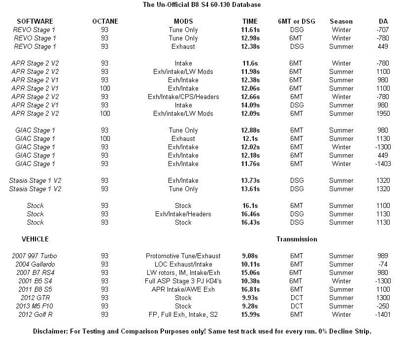

    Anyways... We have seen some acceleration data from my vbox thread that I have compiled with Auditude. Basically all three tunes are fairly even when it comes to 60-130 times with these cold temps (11.6-11.76 secs). Starting at lower speeds than 50-60 mph show that the APR stage 2 definitely has some advantage, at least in recent data collection.
    http://www.audizine.com/forum/showth...box-list/page6
    These vbox tests are very different from the quarter mile tests/list that is compiled up top and are a very different view of the tunes.
    If you extrapolate from the vbox/pbox or whatever you want to call it-- the data for 60-130 the APR stage 2 car has a very slight advantage. This is clearly also seen when doing side by side pulls on our test track.
    Any higher RPMs pull between the two cars is very close with the advantage going slightly to the APR car. Personally from what I can pull from the vbox data, and keeping shift times out of equation in the two manual cars... I think 3rd gear is more powerful in the APR stage 2 car and 4th is more powerful in the GIAC car. I have vag com'd, vboxed, dynoed... both cars. Argue what u want. The pulley is exceptional down low. Up top... the benefits are not so clear. IATs rise very quickly with my max achieved 17-18 psi of boost here at sea level/ -1400 DA nights...and timing hovering at around 16-17 degrees. Conservative.. yes. I prefer that. Virtually no timing pull in my car in these temps. Very Little. Log the GIAC car in same conditions.. and the timing pull is very different and very busy. Same goes for the REVO car. They are making their power moreso with timing (~19-20 degrees of timing advance (GIAC) and ~24-25 degrees of timing advance (REVO). 25 degrees is what I peak at when I am on Race gas. Revo runs this on pump.
    Peak boost for both those cars (GIAC, Revo) is standard stage 1...low to mid 14 psi. I recorded those values when I was stage 1 also.
    Now take a 40-130 with same lower rpm/gear start.. forget it...the APR car now has almost a 0.3 second advantage. It pulls ahead much quicker as 15 psi is seen very quickly. 30-130 is even worse.
    The clear advantage of the APR pulley is down low. If we did a 15 mph pull in first gear.. you will clearly see the APR car pulling away early on. I really can't wait to see what the GIAC pulley does. Just as excited as Pete lol. I love this stuff.
    REVO/GIAC stage 1 use their timing advantage and the APR Stage 2 car uses it's boost advantage. We are talking pump vs pump runs here. Up top, especially at cruising speeds... the benefits of timing outweigh the benefits of boost. This is at least how it is for us. Things get hot really quickly with high boost and without a CPS (me)..it might be costing me some hp. That'll be fixed soon though. I can't see the APR stage 1 setup keeping up with those two tunes though. We have a few fellas around here that are interested in logging and running vbox so we can see what's going on there also.
    But back to our initial comparison and to further prove what we are seeing.. we did a back to back dyno session in the summer between the APR stage 2 car and the GIAC stage 1 car and you can see the exact same thing happening. I will leave peak dyno numbers out of it.. they mean squat. People get do obsessed with them and honestly for me have become the last thing i look at. But from dyno below... the pulley has ~10-15 whp advantage and ~15-20 wtq advantage up until ~4600 rpms. Then they are identical until redline. Would CPS help the top end? Sure. The curves definitely look off up top for both cars.
    We will go and video the results one night and show you the 30 roll and 50 roll results. And stay tuned for a true stage 2 session.

    Didnt you just 60-130 your car? That isnt on that sheet above?

    Here is the updated vbox list:
    He accidentally posted the wrong sheet.

    I Posted wrong sheet.. it is corrected. Sorry I was tired and these posts take hours to gather/create. Info didn't change inside (11.6-11.76 are fastest time range for all 3 tunes in this weather). That is - on our test track with a 0% decline.
    Here is what I see .... And please feel free to chime in and give us ur insights on the data you have collected or on what you see. I have all three tunes at my disposal at any time of day and I probably have logged them along with Pete more than anyone on these forums. When we get our hands on a pulley for the GIAC car - I will report back with unbiased results.
    ... APR is protecting the engine timing wise, GIAC is in the middle, and REVO is throwing caution to the wind. I imagine APR could step that up a little and stay safe as long as you're using really good gas or have ideal atmospheric conditions and temps like I have. Not everyone has -2000 DA nights or -1500 DA days. Our air is ripe for power.
    ... GIAC cars are pulling loads of timing (even in great cold conditions, and I don't honestly believe the entire blame is on ghe bad gas theory) and they are still a good bit lower than REVO...but the REVO cars are not pulling nearly as much timing even though they are mapped for WAY more. Knock sensor sensitivity adjustments most certainly can be an explanation for that and that's been hinted by a few. I have logged the same Revo car post Stasis merge and some updated file and it magically started pulling some timing after almost 6 months of practically zero timing pull in all 6 cylinders. APR has said they don't touch stock knock sensitivity which is interesting. Looks like GIAC doesn't. Looks like REVO allegedly does. But 25-26 degrees of timing on pump? Meh no thanks. At least not without some Shell URT or MS109 race gas for me.

    I just need a damn GIAC pulley, an ASP car, and some more winter testing of those Stasis cars we have run in summer.
    Seeing APR S1 car added to the list would be great as well! All APR representation on the list is Stage 2. There's got to be someone in your vicinity who hasn't stepped up yet!!

    I can volunteer for APR stage 1 v2 testing if Tsivas needs more data. Haven't been out to Mexico in a while lol

    Quote Originally Posted by dave329 View Post
    Dave text me- we'd love to log your car and vbox..

    Tsivas, if possible, could you please log stock DSG B8.5 60-130! Really interesting to see how longer gearing and short-shifting affected this. I afraid to see times like 18+ :(
