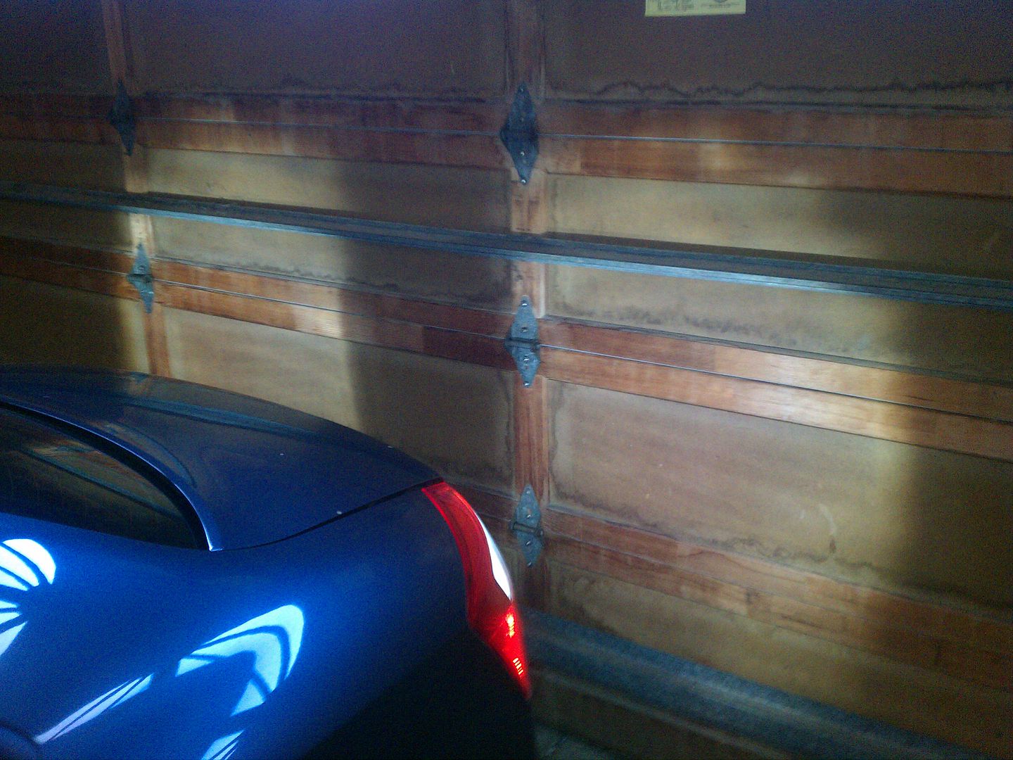

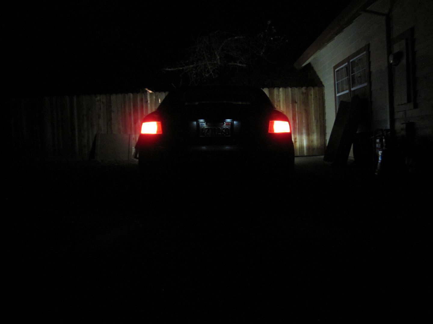

    I picked up a set of License Plate LEDs from a guy on Vortex last year, been working fine ever since.
    Just bought a set of 1156 Ba15S CREE Leds from this seller on eBay
    http://myworld.ebay.com/wx_led
    This was shot in my garage while there was still daylight coming in. Sweet.

    i just checked the link you posted on the other thread these look to be the exact same bulbs with same wattage
