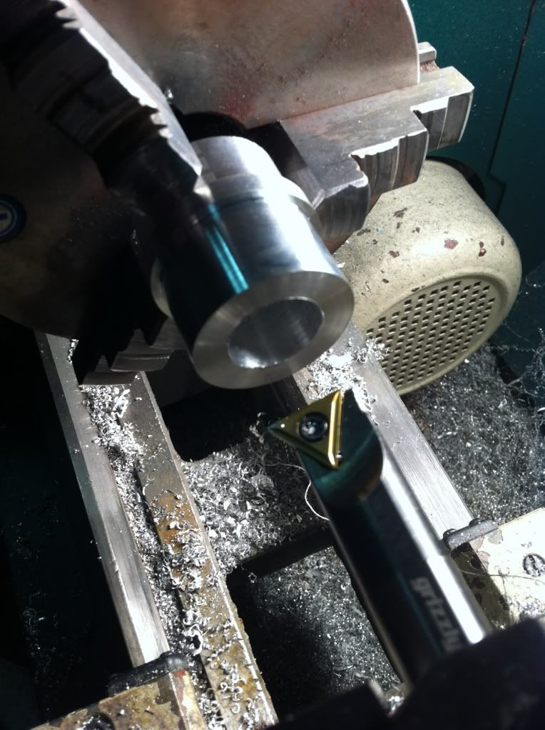

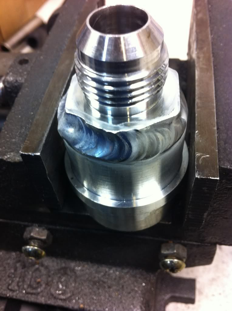

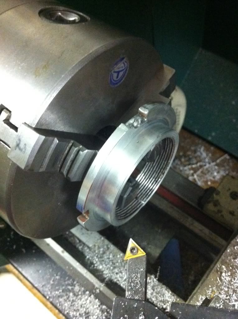

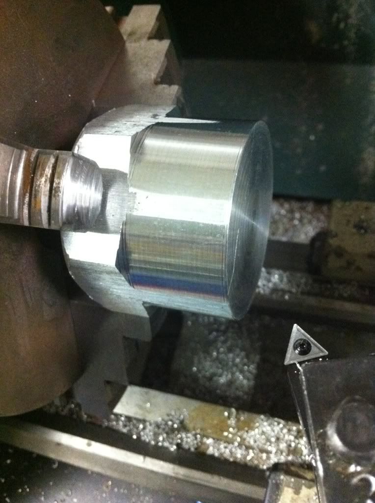

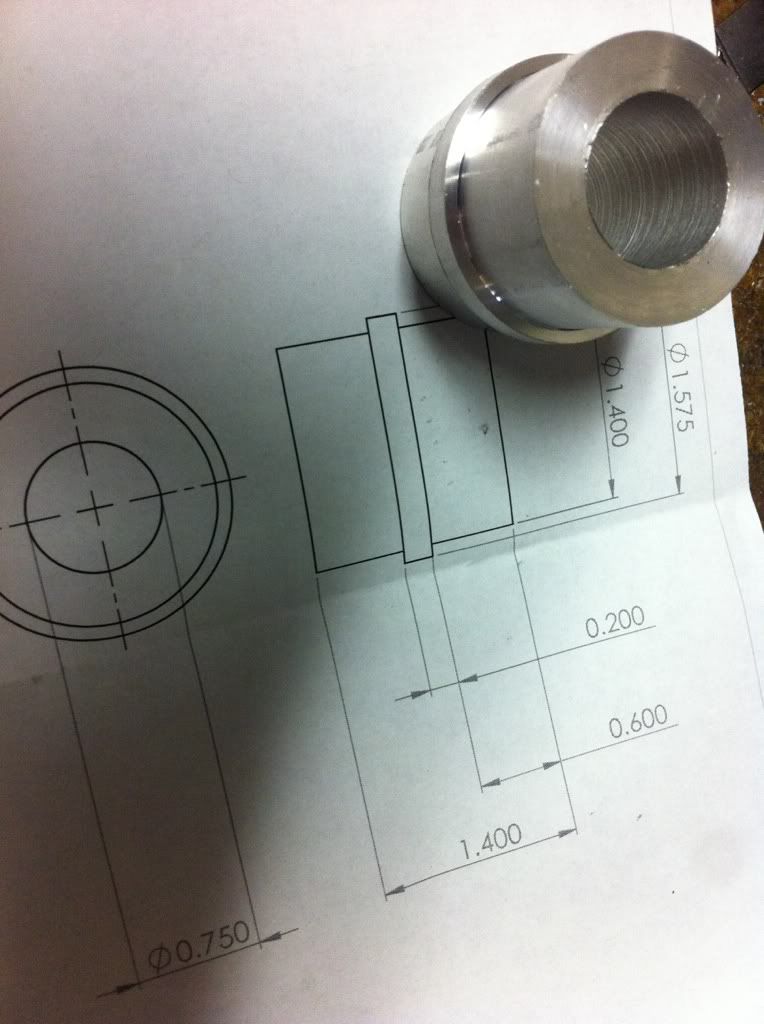

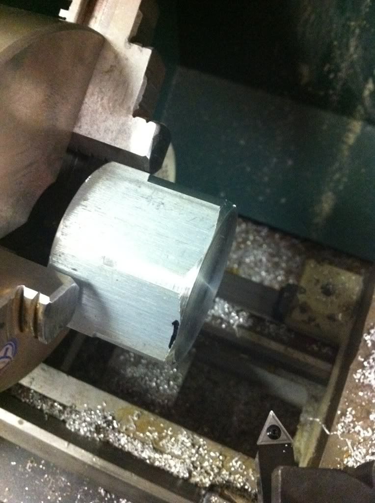

    machined a block breather adapter. then welded on an -10 AN fitting thats getting run to a catch can.

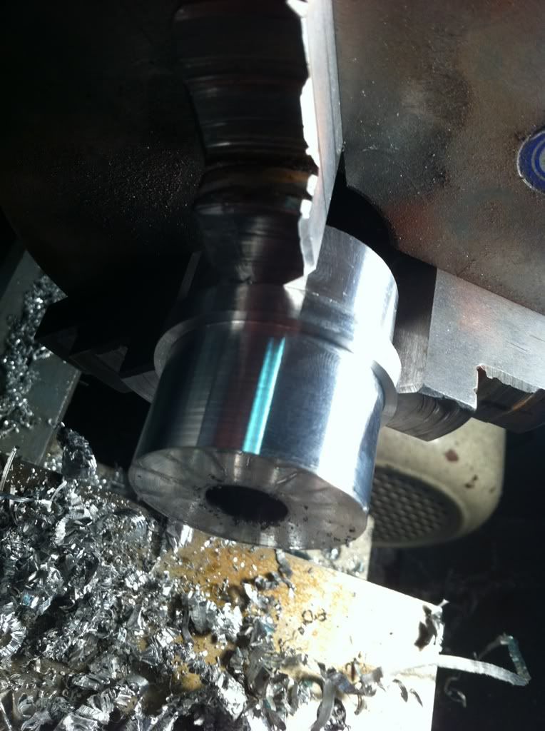

    -started out as some hex stock i had laying around
    -turned to down to a round piece
    -getting the flange part going
    drilled and starting to bore out the hole a little bit

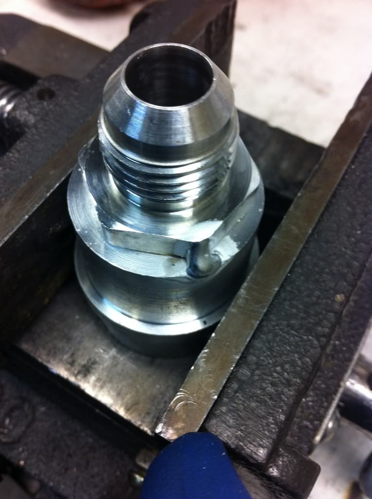

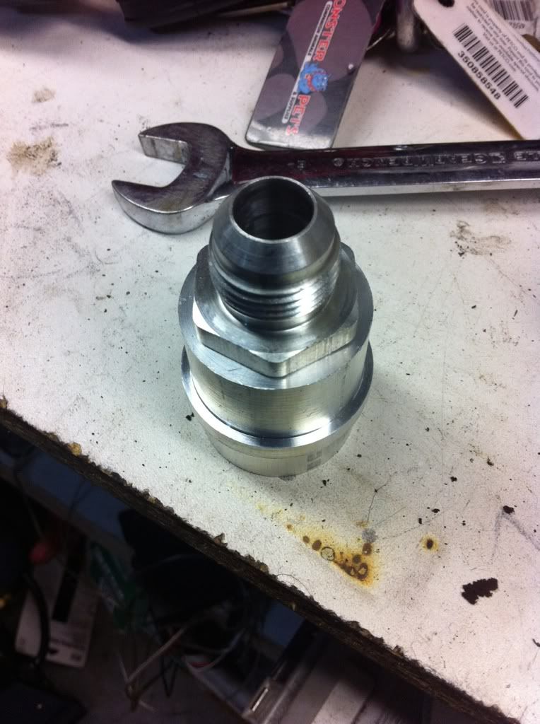

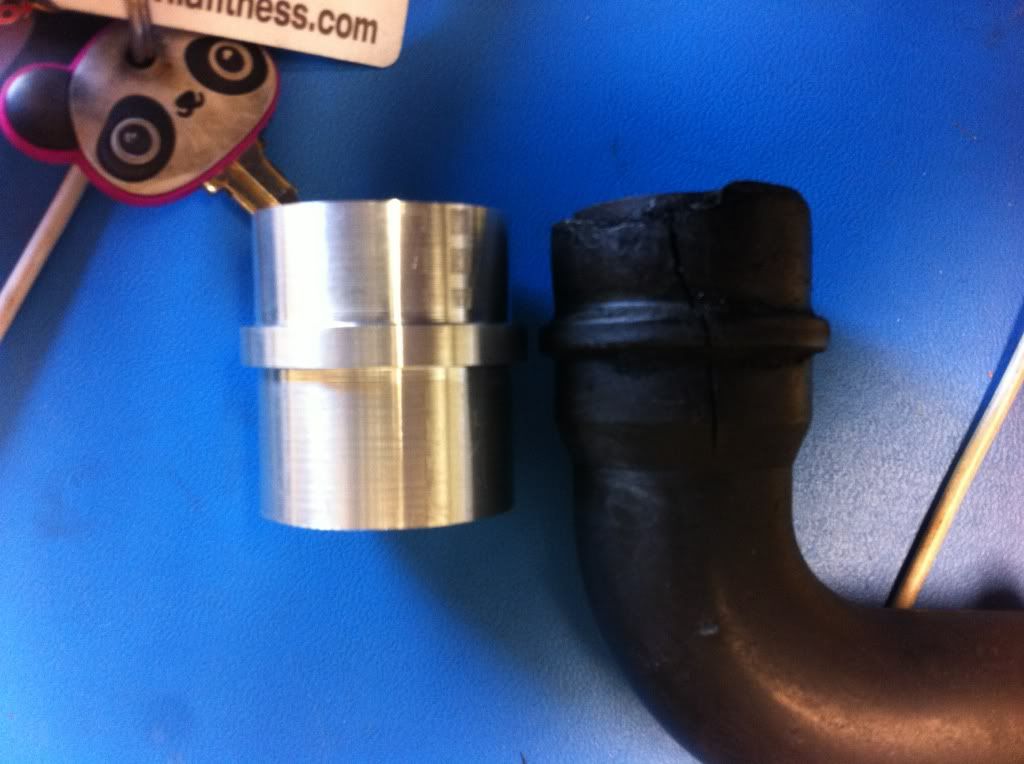

    -comparison to the old cracked guy
    -welding on the -10 fitting
    -tigged up ready to go

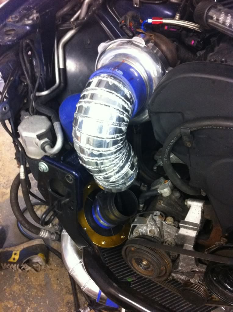

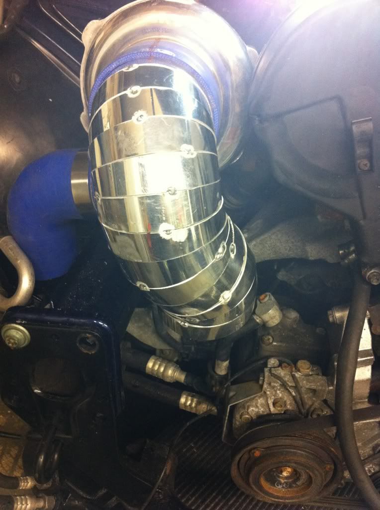

    started the intake for the turbo set up since i decided to run a MAF/DV for the maestro tune. i'm started to regret it. my last set up i had a 90 degree silicone elbow and it was terrible and flexed. I thought since i started tigging aluminum i would try a make a nice one out of aluminum.
    -this beautiful tube is gonna get hacked up into millions of 15 degree pie cuts
    -million pie cuts turned into this all tacked up
    need to wait for air filter to come in and a tt 225 maf.
    let me know what you think.

    oh boy thats alot of tig welding you got left. kudos to people who can fab up their own parts.

    Nice. I don't have skills like that, and need to either buy parts that thread/clamp/bolt together or pay someone to make it for me.

    Seerlah , it ain't that hard, just takes time.

    Holy shit never knew you had such fabrication skills. All the parts looks great. I'm gonna hit you up to make me an inlet like that when I'm ready for my turbo setup :)

    thanks for the replies. yes lots of time went into it the intake. the crank case vent took like 30 minutes. I'll also post of the catch can i fabricated with some spare 2.5" aluminum ic piping and some caps i made with a hole saw and some aluminum plate. the time spent making these things i probably could have saved my time and bought something to make it work. but i think the intake will serve me well since i hated my last set up. I guess i take a lot of pride in craftsmanship and learning the tricks of the trade.

    Do you plan on smoothing the inside of your intake?
    Feb 27 2005
    5482
    North Wales, PA
    probably not. I'll get a shot of the inside of the intake. its pretty smooth

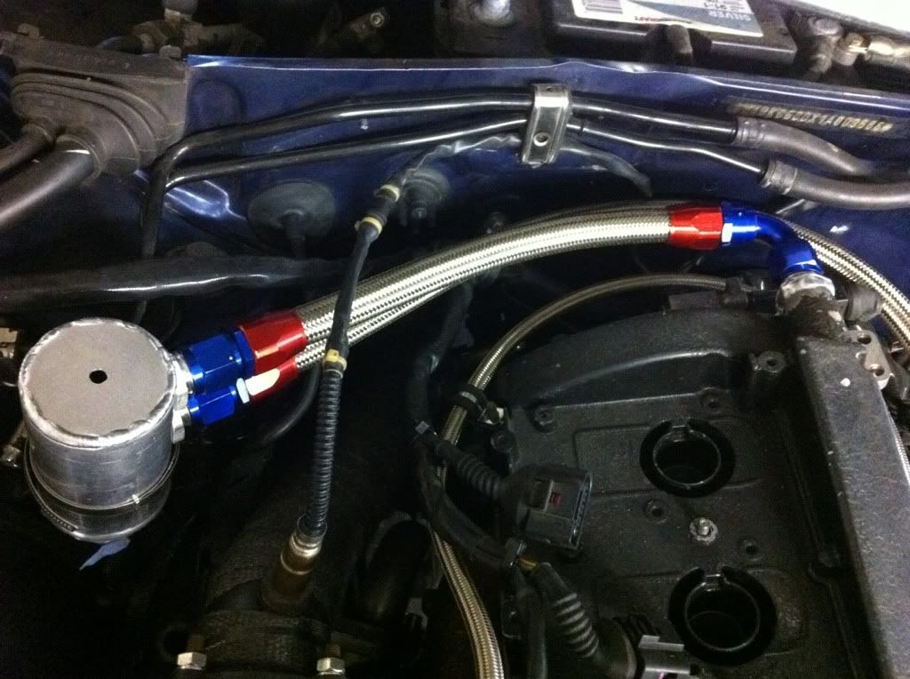

    Finished up all the welding

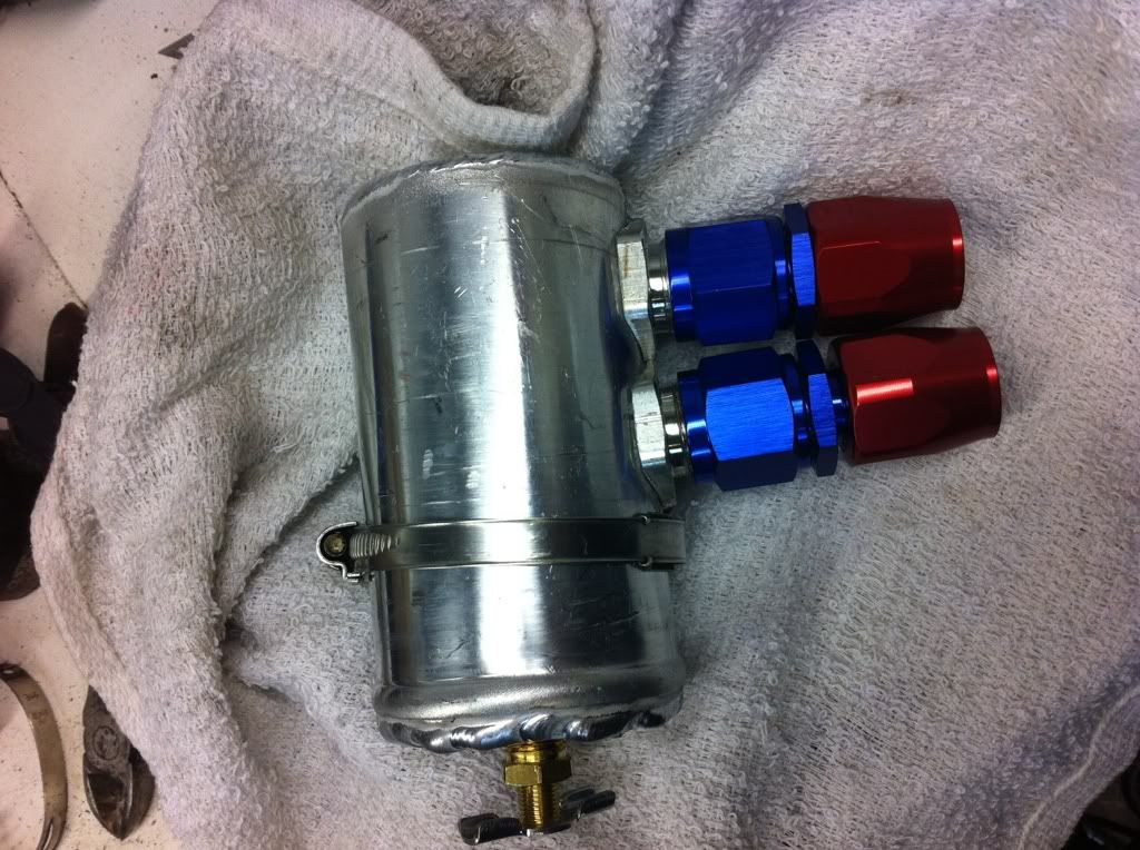

    here is the homebrew oil catch can. total cost was about $12 for the -AN weld in bungs. those -AN fittings are about $10 each. Got to add a nipple and breather filter and a mount.

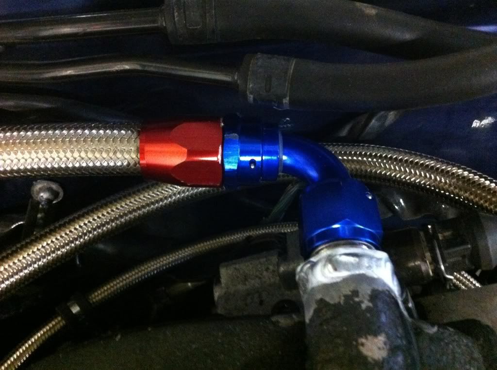

    block breather adapter installed
    -AN fitting welded to the valve cover
    Catch can with the -AN lines fitted up
