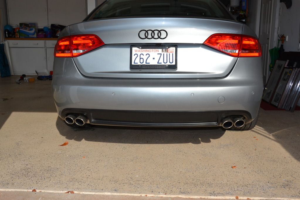

When I started, my rear valence was a "modification" of my existing dual exit to take in my APR Quads I put in this summer. That looked something like this (meh):
