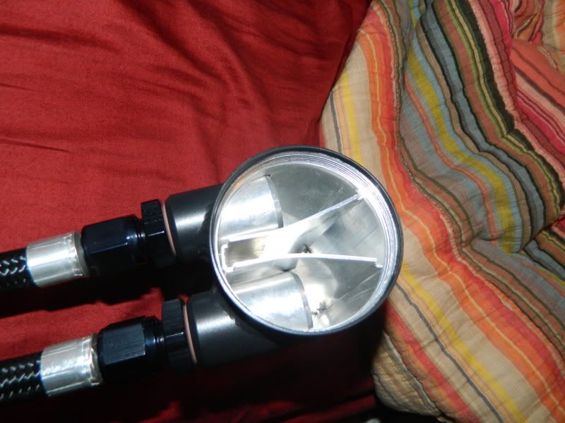

    catch can if anyone is interested

    I am glad that you took a picture of the new CC. Interesting design. Looks like a good idea. I definitely think you should toss in a check valve, specially if you didnt do anything special on the rear PCV
    For the rear PCV I was thinking about the euro jet tube, it is basically a tube with a check valve LOL
