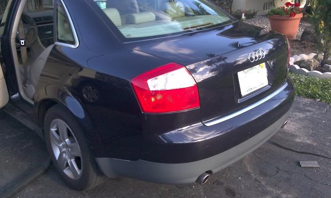

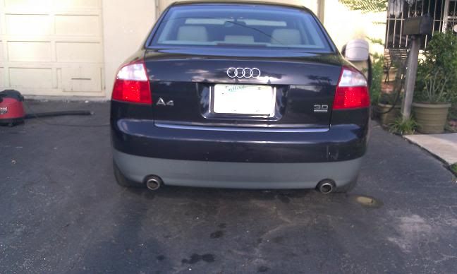

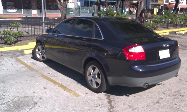

    This Audi A4 V6 3.0 6-speed i must say it is a very nice car with lots of potential. It has a clean title and 140k miles. I live in miami and this car was a Boston car for all of its life the owner drove down here to live and sold it to me recently. It has alot of rust underneath the car but i am slowly alleviating all of the oxidation and grime from the car as to me this is the only way to learn by taking apart cleaning and putting things back together. Ok on to the fun stuff.
    Pic of stock form:
    Removed emblems:
    18% tints:
    Badgeless grill:

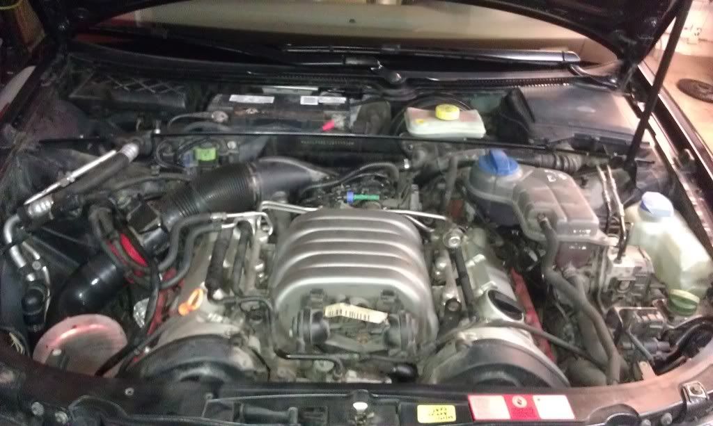

    Pic of temporary intake & engine bay:

    need painted lowers. what kind of intake is that?? i'm not sure if you are aware but you are missing several covers and seals in the engine bay
    yea i know i took that pic when i was workin on the engine so i removed all of that stuff but i do have all the stock pieces, the intake is just some spare parts i had layin around, its a blox 3 inch velocity stack with pantyhose covering it

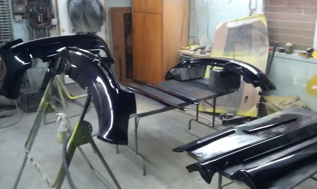

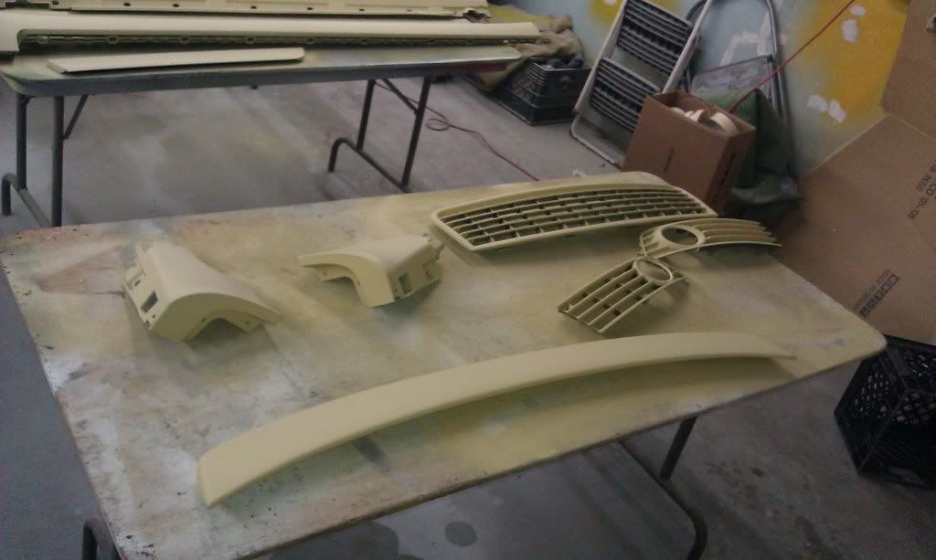

    more updates! puttin the parts in for paint this week, my days of multi color are over cant wait for the new look here are some disassembly pics, its my fathers business so gettin it done quick and for the right price

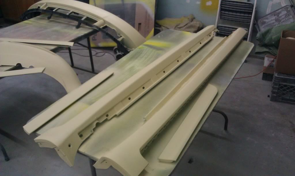

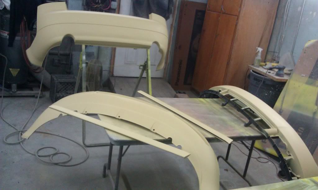

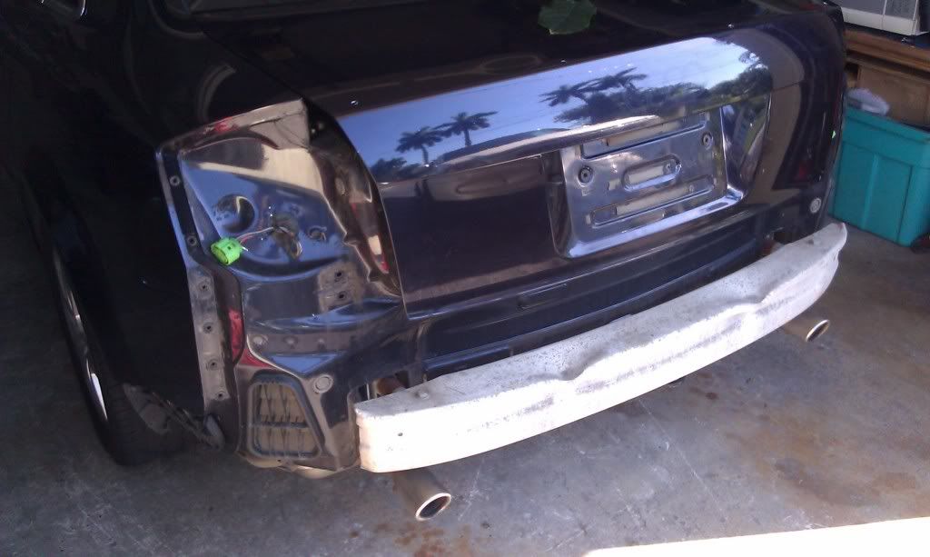

    Finally got around to stripping the rear end
    parts in gettin prepped in the shop!

    parts primed and ready for paint tommorow! gotta love the family business work gets done quick and done right

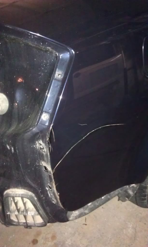

    Well i hope so i still hav to get my rear right hand quarter panel fixed, ill picture that later, it has a nasty bondo crack from a poor repair that has allowed the metal underneath to Rust

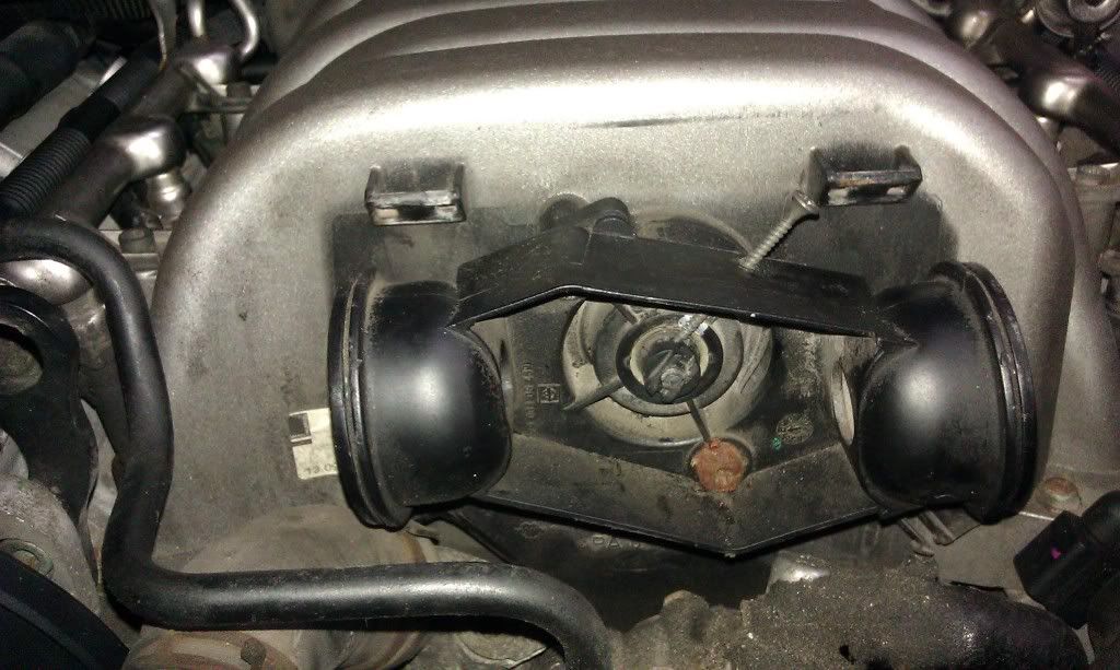

    i have been meaning to add a couple examples of "Real World" results:
    I noticed when i bought the car that the intake manifold butterfly was broken so i had decided that i would do a couple tests just to see if they really helped as much as they r "supposed" to. First i removed all the dashpots and vaccuum hoses out of the way so i could create something that i could lock the butterflies in place to do the testing, now i learned that initially when the car is started that these cars pull vacuum and lock the butterflies to what i believe is the longer runners because theoretically the longer runners create more velocity and improve torque however they are not ideal for top end power, so given this i first wanted to lock the runners to the long runners first and run some tests. I first did some normal driving to see how the "seat of the pants feel" would be so i could have a basis for the short runner test. Next with the longer runners still locked open i decided to do some timed runs leaving the car in second gear from 20mph to 55mph and i went to find a flat open road. The times i came up with from the average of 3 - 5 pulls was 6.4seconds the lowest being 6.2s and the highest 6.7s. I live in miami so the weather right now is a bit cooler than normal i would say high 50s low 60s rite now and this was the weather when i did the testing and it was at night.
    So i stopped and checked to make sure my locking system had not been moved and the runners were still in place and sure enuf they were. So i proceeded to change the runners to the short runner position and lock it in. Ran the same tests again and what do you know there was no change at all to the results the times were very similar. So i stopped to check to make sure the runners were still locked in the short position and yes they were. I even successfully locked the runners in the middle position and ran the test and still no changes in time and feel.
    Well you may say ok the times arent accurate well possibly becuz there is a such thing as human error, but i was looking for a bigger change. So you might say well a dyno would show a change for sure. Well not quite....when i dynoed that 156awhp/182awtq i changed the butterflies around several times looking for a change and still not even a miniscule change in the numbers or curves.
    I dont know much but i can tell you after these tests i will next be trying to remove the butterflies entirely to get them out of the way so there is some more airflow within the manifold cuz it seems they do nothing other than give a "better seat of pants feel" if that, and just get in the way.
    I will try to get some pics of the manifold and how i locked it in. Granted its just a screw that holds the butterfly shaft so its really nothing, looks crappy but hey it works.
    a quick shot of how i locked the butterflies in dont mind my professional mastery lol j/k
    Thoughts?

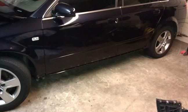

    oh and got the parts finished lookin fresh paint and glossy!! Install coming soon just gotta give it some overnight flash time,

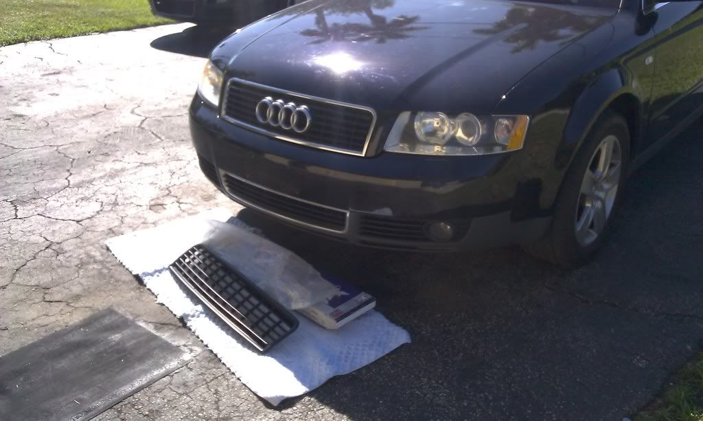

    cant tell in the pic, did you paint the grille body color?
