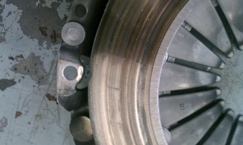

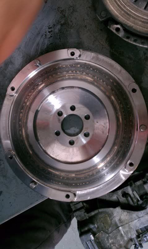

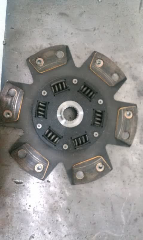

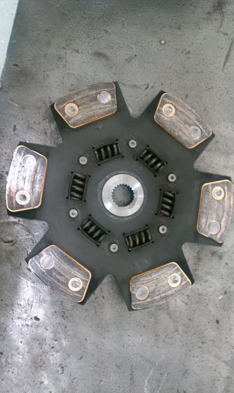

    verdict is: fused.... pictures tomorrow when i have time along with what CM and i discuss on the phone. any words of wisdom besides good luck in dealing with CM?

    its already broken apart, i have one that was sent to me while the friction disk was stuck to the flywheel. all shitty phone pics, but you'll get the idea. going to pick up the parts and ship them, and picking up my E30 3 series loaner...not stoked haha! pics later tonight possibly.

    it doesnt necessarily mean its the line of clutch or the manufacturer, it could just be a fluke, a flaw, a mistake in manufacturing. i still think these clutches are badass, and i will be getting another. the only thing im interested in is how CM handles this. i believe i have done nothing abusive or wrong or outside of what this clutch can handle as far as this situation goes. all the tapering of the friction material is gone meaning the friction disk was in full contact with the flywheel and pressure plate, according to what m hood explained earlier.

    here's some photo's i snapped before i shipped it to cali. just a little heads up, in CM's warranty they clearly state that they do not cover and non material charges, including: shipping, labor and towing fee's. tear down and reassembly upon the arrival of either a repaired or new clutch will cost me about 450 total, cost me 70 to tow it and its costed me 220 to ship it to CM ontop of them holding me responsible to pay for the shipping back to me. in the end this is going to end up costing me ~$960. the labor and the towing i dont mind so much, but if this is infact a warranty case, you can be sure we will be discussing some sort of compromise on this shipping. i believe someone else has had CM compensate them for shipping or some other non material cost before in another thread i've read...anyway enjoy the carnage...

    just heard from Jose at CM. apparently the friction disk pads were impregnated with oil (indicating i have a bad oil leak problem somewhere), so it looks like i have an oil leak to find. in any case it was a non warranty issue so my charges are as follows: 125 to resurface the flywheel and pressure plate, and replace the friction pucks on the friction disk. another 138.95 to 2 day air ship it back to me bringing my subtotal to 263.95. so my total cost so far without my mechanics labor is $481.13. still looking at 850-900 total for this. great service from CM, no complaints here.

    you should have just bought a new one for another 100 bucks.
    Damnnnn you got that thing sooooo hot! Look at your FW.
