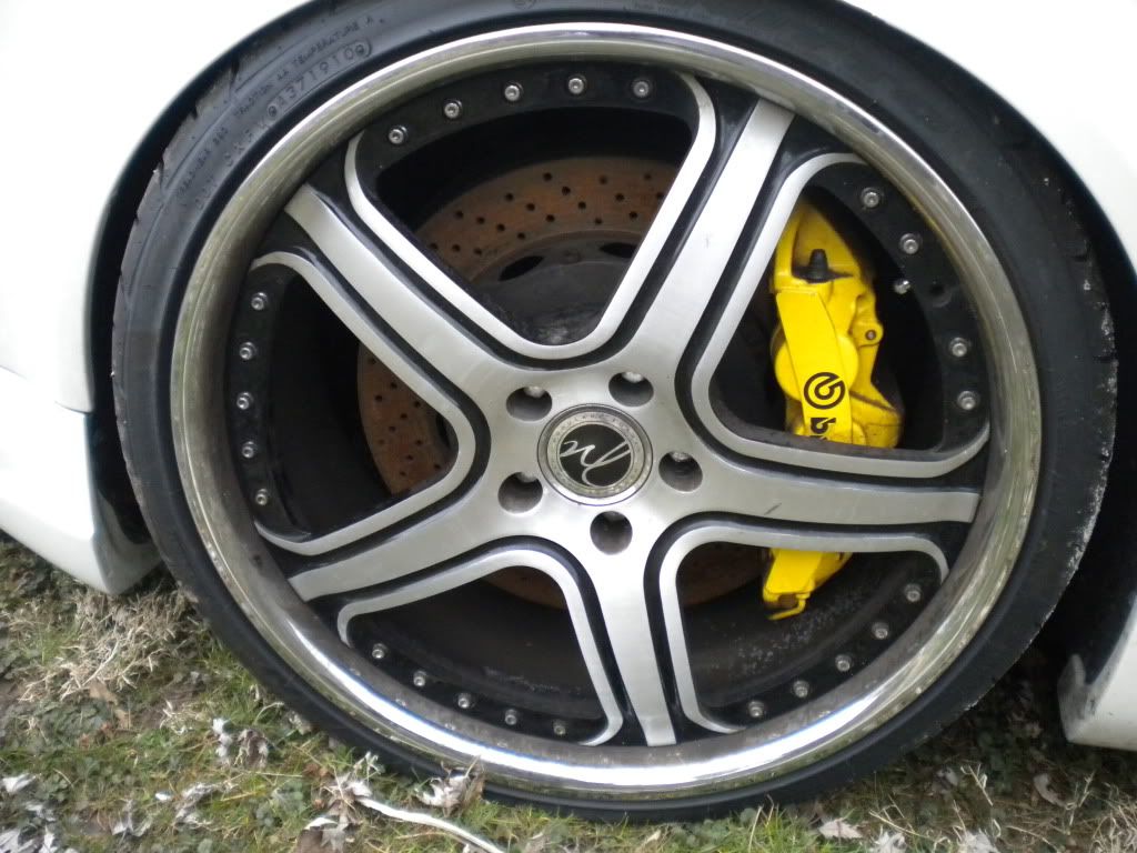

    The 355s need 19" or bigger. Also, the B6s look better with 19s. Everything is listed in post 1
    nahh.. i run 18" wheels over my 355mm Alcons with plenty of extra space. i could probably fit 370mm's. you just need to get the right wheel.
