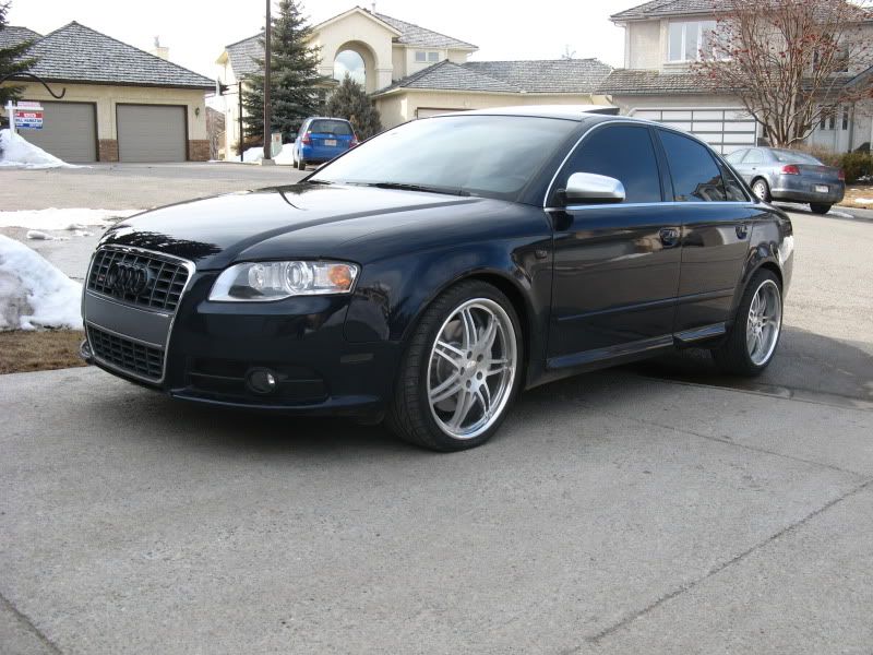

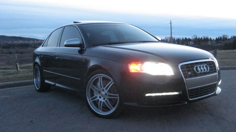

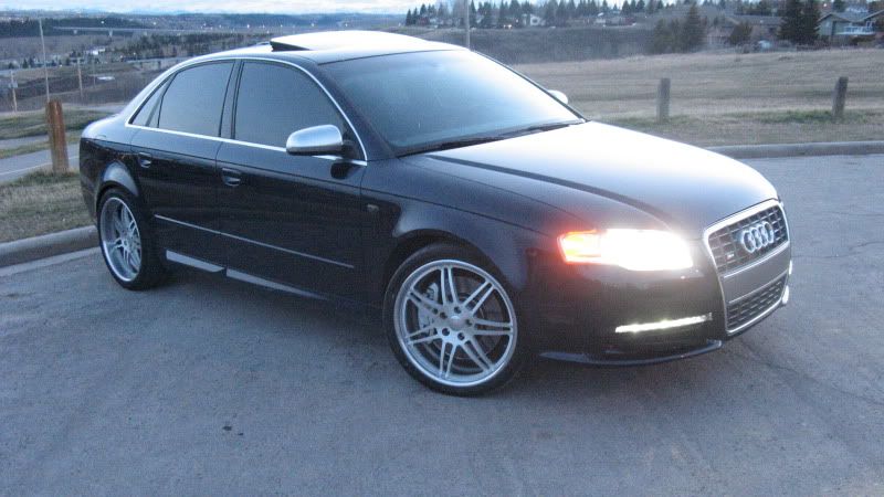

    so recently finished up installing my oem audi s6 fog lights on my b7 s4
    This was not a very easy job and required ALOT of patience
    I want to start off by giving mad props to the following:
    nnnick: http://nickscarblog.com/diy/b7-audi-...d-retrofit-diy
    tgt: http://www.audizine.com/forum/showth...tall-with-Pics
    enigma1406: http://www.audizine.com/forum/showth...D-DRLs-on-a-B7
    without you guys, I would be hunched over my mangled bumper in tears
    I did read/see a few others with similar mods so props to you too...
    I tried to really take my time on this so my baby sat in my garage for about a week with no front bumper on her but I am quite pleased with the way it turned out...definitley worth the long hours and TONS of frustration
    now I dont have alot of body experience (at all!) but if you are thinking of doing this mod be forewarned....this is no easy task if you ask me but with some time and patience it is definitley possible
    as you can see I havent put the fog grills back on. I used the s4 oem grills and rebuilt them with fiberglass but wasnt fully satisfied with the way they turned out (I'm a bit of a perfectionist) so I took them to a guy in Calgary who does custom hot rod work to finish them for me
    more pictures will be added as soon as i get the grills back (my apologies for picture quality: I am no profesional photographer and I dont have a fancy camera)
    anyhow, here are some pics. If anyone has any comments/suggestions on the car or ideas where to go next with it...please share! I'm always open to ideas! (someone also tell me if they liked the black or silver emblems more please)
    quick picture before
    another
    I will be adding more pics soon if requested before I get the fog grills back (should be soon) or once they are back in
