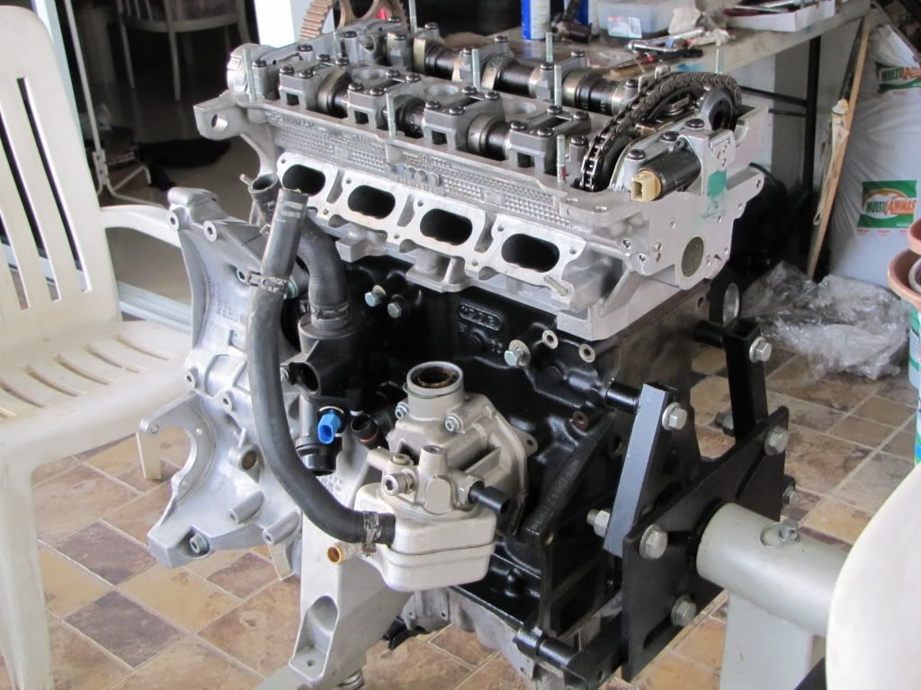

    Veteran Member Three Rings pape's Avatar
    Nov 30 2008
    35811
    MIA
    Ok let me help you out here I did a swap from AVJ to a BFB car and there are some difrences.
    the USA AMB is Identical to the BFB
    but the AVJ is difrent to the BFB and AMB.
    difrences between AVJ and AMB:
    1. TIP (the rubber pipe that is the inlet to the turbo) they are difrent because of the mounting locations of the pancake valve
    2. the pipes that go to the comby valve (the one in the back of the head) are difrent and routed difrently through the engine but the valve still mounts in the exact location
    3. alternators the avj has the pulley pinned to the altarnator shaft anf the BFB has the pulley mounted on a oneway bearing
    4. vacuum lines under the intake manifold. there is less lines and check valves on the avj than on the bfb,amb
    as for the block and head:
    all avj , bfb , amb they are all the same internals (exept the crank) they are al 19mm pin 1.8t small port heads
    the crank shaft on all BFB and AVJ are the same used on the 5speed AMB
    here is a BFB block with a AEB head

    The BFB came in '03 in europe, mines a '02
    Quote Originally Posted by pape View Post
    Thanks, i was wondering about the internals. theres very few people BTing the 1.8t's over here, and the few who does, claims the stock block handles 300chp. Reading on here the word is 300whp on stock blocks, thats why im confused.
