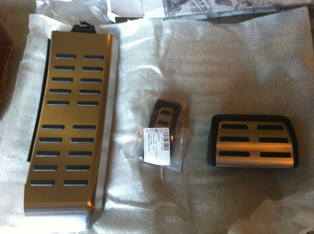

    I ordered the RS5 pedals from Europrice few weeks ago and got it this week. Decided to install it today after reading various forums on tips and instructions as to how to remove the old ones and install the new ones, I thought I was ready to get it done. I started around 6pm today... (Photos maybe crappy in some cases due to the iphone's flash)
    Here's the pedals:

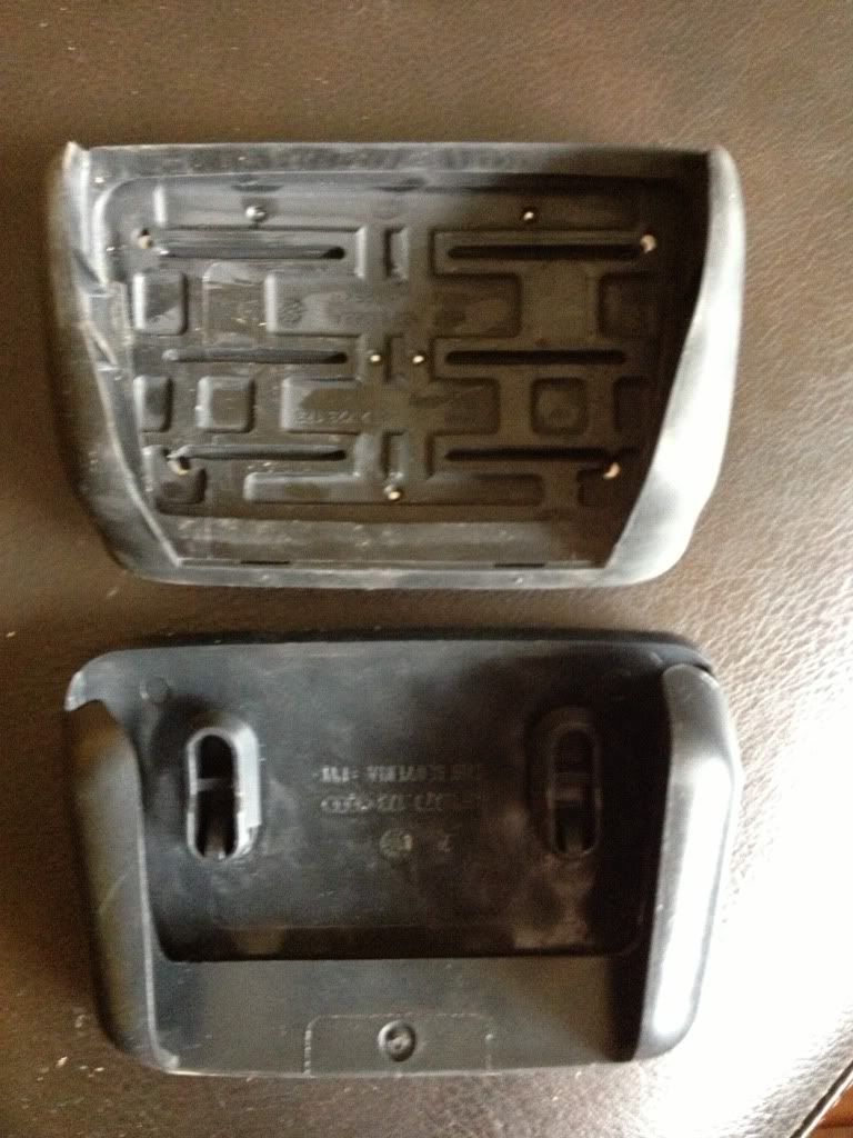

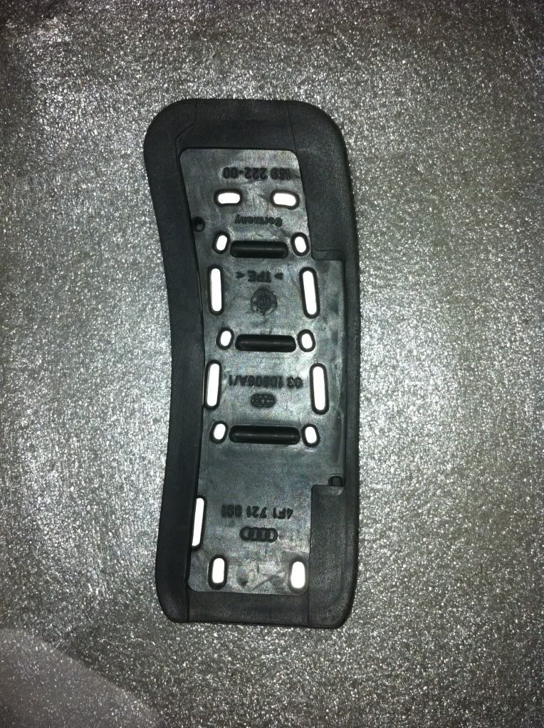

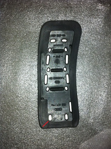

    First, I thought for sure the gas pedal would be the easiest. Everywhere I have read, it tells me the gas pedal is just a slide on, but for the life of me, I cannot get it to work. I must have spend 30 min and I STILL cannot get it on fully.
    Here's a picture of the back of the gas pedal:
    The picture is actually reversed, but basically, the bottom right corner would end up covering the top right corner of your gas pedal. But I can only get the long (full side) side and the bottom of the pedal to go into place. I gave up after 30 min since it seems to hold it's place pretty well and until I can come up with a better way of getting it on, I am leaving it for now.

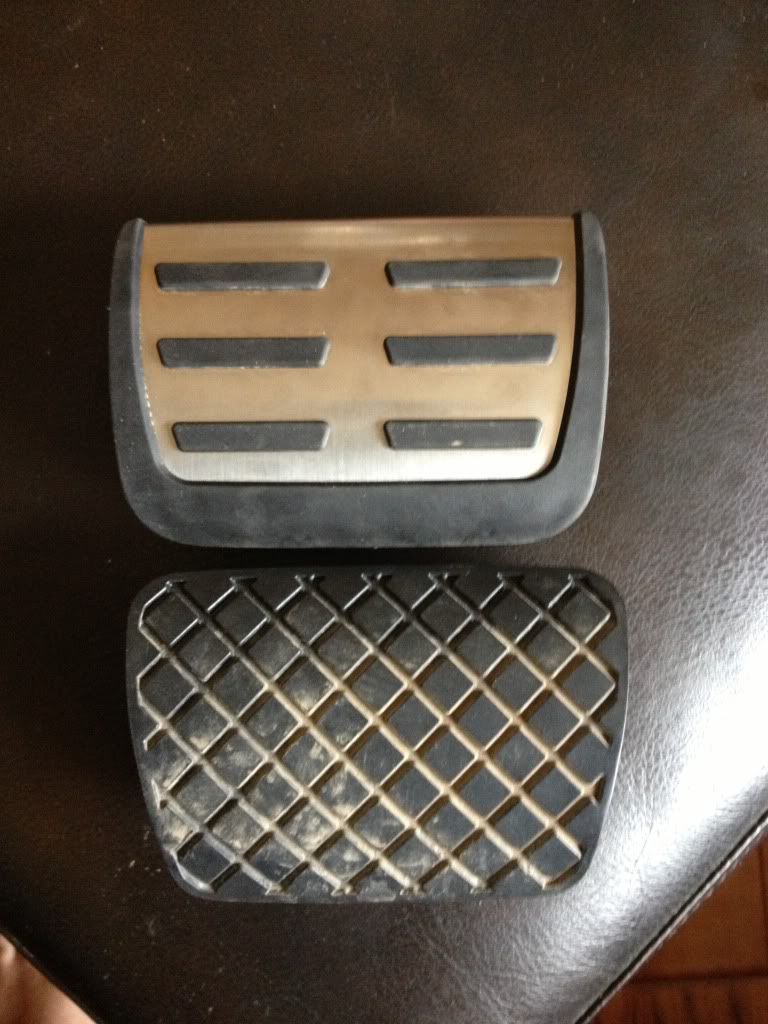

    I had less trouble with the brake pedal thankfully, I sort of worked the rubber a bit to make it looser and easier to work with. It's actually easier to install than the S4 one that came with the car. Just make sure the metal plate slides into the gap on the left side (when facing you) and also at the bottom of the pedal, then just put the two plugs into the slot. You can only really feel the left one since the right one is where the pedal is attached to the car, you can stick you figure through the hole to feel and make sure the plug is in properly but I didn't have any problem with that one. I had a problem with the left plug as it didn't seem to want to go in and it kept bending in a way that I cannot push it in. Eventually, I got it to work around 10-15 min from removing old to installing new.

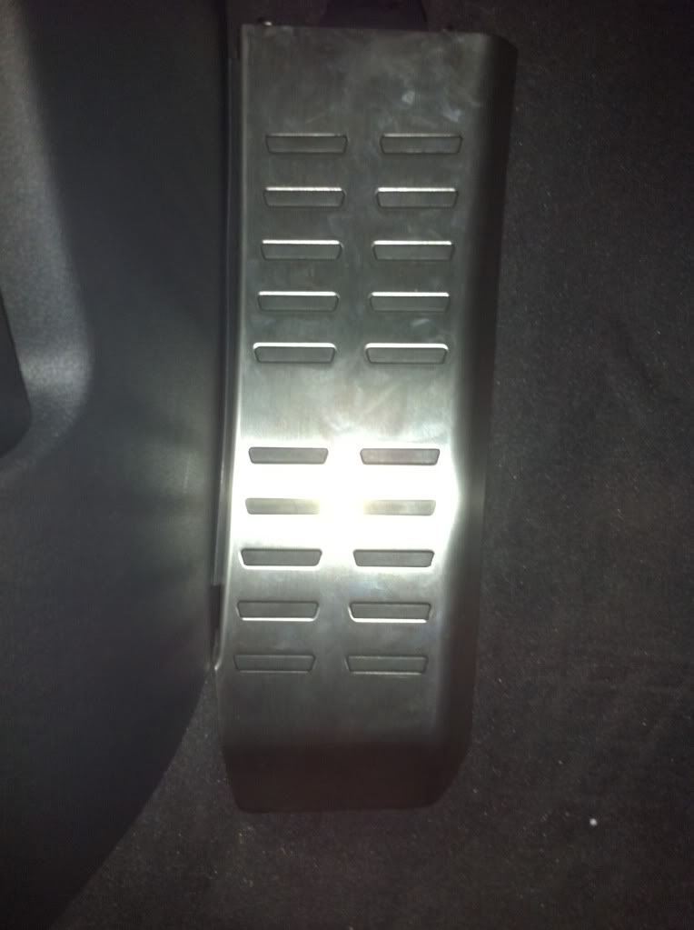

    Then on to the dead pedal. I wasn't sure what to do with the hooks that goes behind the kick panel on the side. At this time, I had to decide between trying to pop and loosen the panel up to install it properly or just putting the dead pedal in without rehooking it under the side panel. At the end, I chose the easier route because I see no harm in it. It will hold in place since it still has the 5 clips that attach to the floor of the car and the clip that attaches near the VAG Com cable and the light. At my next service, I might try talking the dealer into fixing it for me.

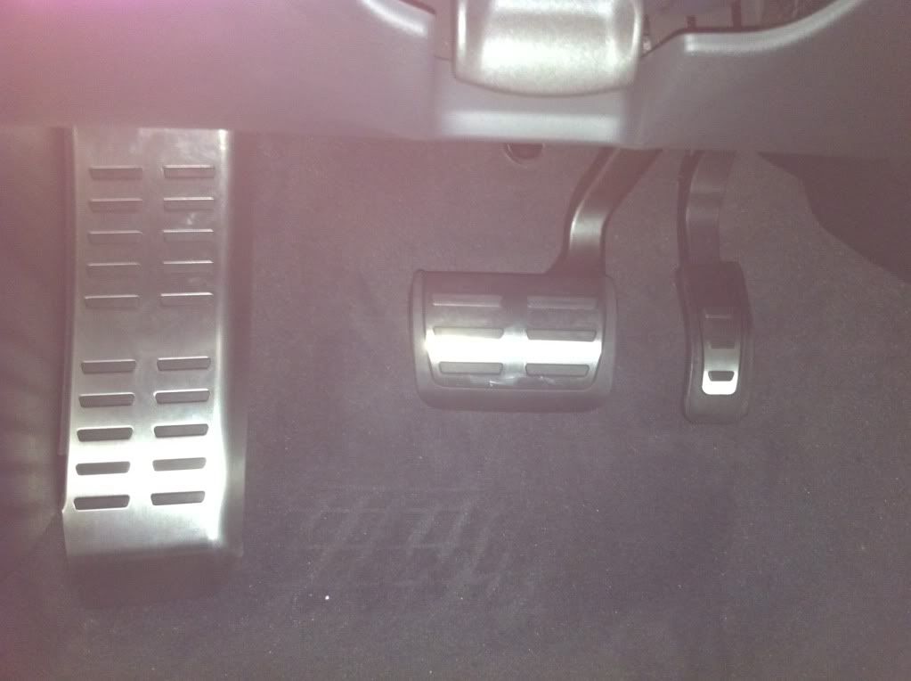

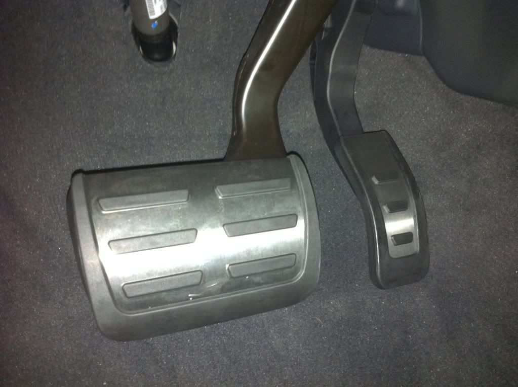

    Here's how it looks after all it done.
    You can see a small gap to the left of the dead pedal, that part is where the side panel is suppose to go into to lock it into place.
    When all was set and done, it was 8pm. So it took me a full 2 hours, both knees and elbows were red from kneeling and installing the stuff and still wasn't fully done. I will admit, I am not much of a handy person, and hopefully you guys will have a much easier time installing yours. If you do, please tell me how exactly can I install the damn gas pedal properly?
    Was it worth it? I guess so. The brake pedal feels better (could be imaginary) can't really tell the difference on the gas pedal but the dead pedal, you can feel the grip. It looks better than stock for sure though. Anyhow, bed time.

    Putting the RS5 dead pedal in was a breeze. Whomever gave the tip to slide the side panel in first at the bottom and then push it up sliding it along upwards is a damn genius.
    Also I'm sure the gas pedal would have been a bitch had it not been for the small incision on the top corner flap to allow it to snap into place. Whomever thought of that, thank you.
    I should note that nobody has previously mentioned that the gas pedal is a cover that fits on top of the existing stock pedal, no cover to remove unlike the brake pedal. Took me a bit to understand that as I was hunting for something to remove there a well.
    All done and boy, do they sharpen up the interior quite a bit in comparison to the dull rubber stock pedals which had no place in an S4.

    I just finished the 3 pedal install on my 2010 S5 Prestige. 20 minutes of reading this thread + 25 minutes of actual work = a GREAT looking DIY upgrade!
    Here is what helped me: a small mirror to make sure that all tabs were in place as they should be. Brake pedal was laughably easy, gas pedal was more of a challenge - the dreaded upper tab was off - saw it in the mirror after checking the job - manipulated in place with strong finger pressure. The LF kick panel - DEFINITLY pull it inward (VERY flexible) engage it in dead pedal slot and slide up. All rubber was pliable as it was in the 80's today!
    Next up - RS5 shifter when I have the time/nerve to grab a heat gun and twist the teflon (?) shaft 90 degrees.

    Yep, genius! Thanks for the tip. With everyone's advice, I was able to install the pedals today. It was definitely easier with all the tips from everyone. For lubricant, I used hand sanitizer because it's just as slimy as the other stuff but dries quicker. I use the same stuff to replace my Oakley rubber stops on the arms. It definitely helps with the replacements. Thanks again everyone especially ahcow for starting the thread and being that "early adopter"!

    Thanks for the helpful thread! The warm, soapy water and the mirror are what made it happen for me. Thanks to this thread I got them installed under 30 mins. Otherwise I'd still be out there!
    Wish I could have gotten the old dead pedal without it breaking though. Not only did 2 clips break, but it snapped in the middle. Oh well, I don't plan to switch back. Thanks again!

    30 minutes, left the pedals in the car on a warm day... the dead pedal was probably my most annoying piece... the brake pedal i just grabbed and spread it like i was trying to turn the side pieces into wings.
    The gas pedal sucked but i used my small boney fingers to pull on the plastic edges and roll it out essentially.
