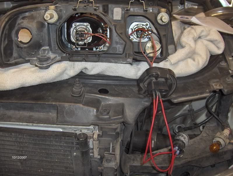

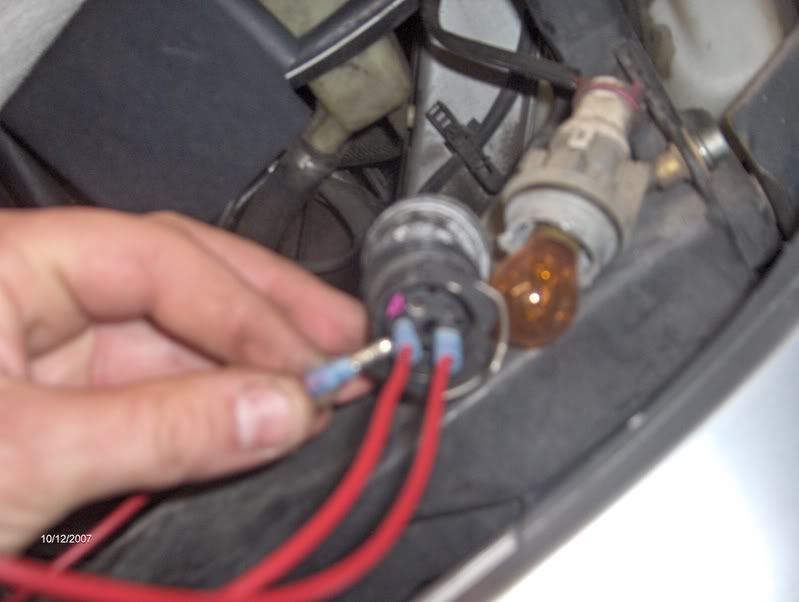

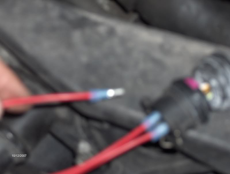

    The second modification: Setting up wires and connectors to go from your old plug to the new plug. You will need to cut 6 pieces of wire. One side of the wire will need a female plug to plug into the headlight housing and you will need to use heat shrinkable tubing to place around the connector because the connectors are placed very close together, I also cut half of the connector to ensure they did not make contact with each other. The other side of the wire will need a round male connector to fit into the cars stock headlight plug. Check out the picture I have of the connectors I used, they worked perfectly.

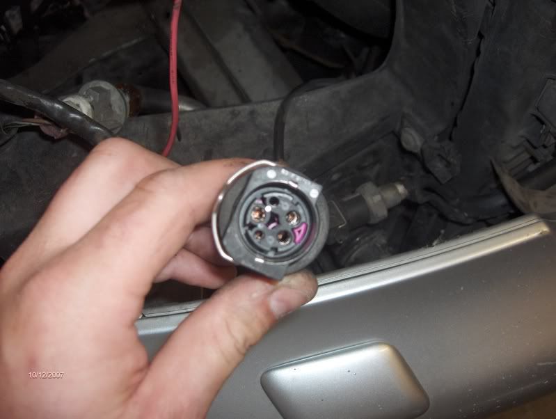

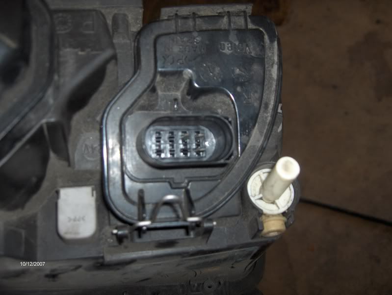

    The cars stock headlight plug

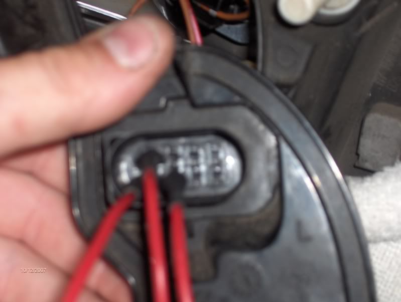

    The new headlight housings plug

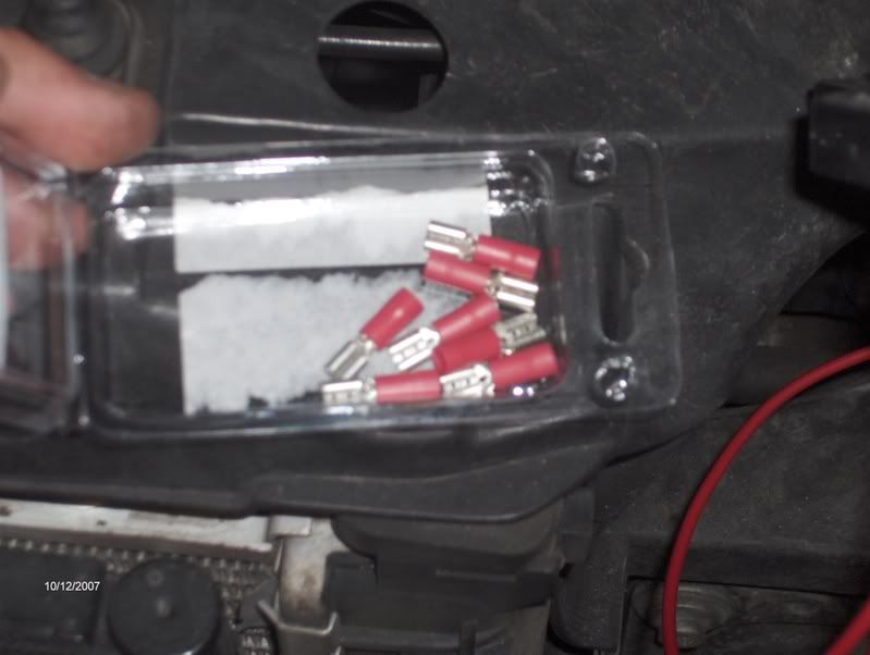

    The female connectors used on the new headlight housing
    And after a job well done.

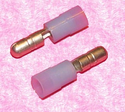

    Pardon the bump, but the connectors he used in the prefacelift socket, were those amp snap connectors?

    I'm not sure what amp snap connectors are, but here is a picture of the electrical connectors I used, purchased from Home Depot
    Veteran Member Three Rings Artiemas's Avatar
    May 30 2012
    94375
    North Branford, CT
    Yeah, those are what are I was talking about.
    1998.5 Cactus Green A4
    30v AHAQM Bone stock
    Veteran Member Four Rings prizmatik's Avatar
    Dec 15 2009
    52125
    Hell hole
    Those work perfect. You can even expand them a little to make a snug fit if necessary.
