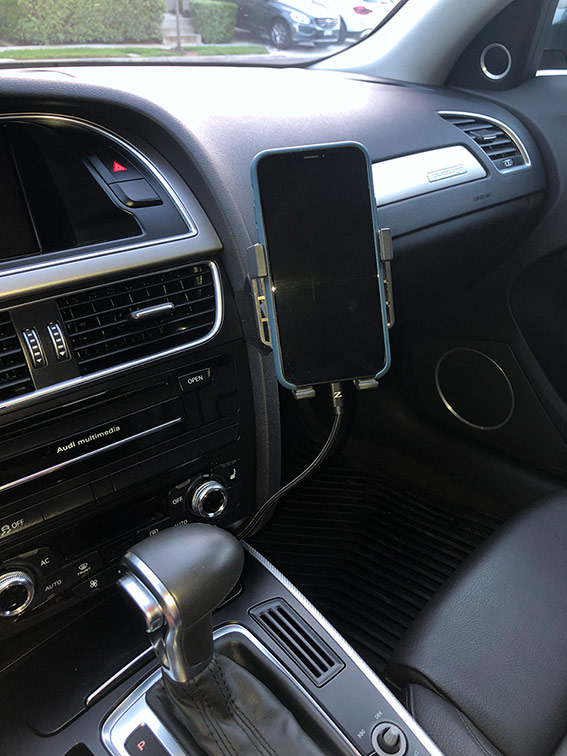

    First...the finished product

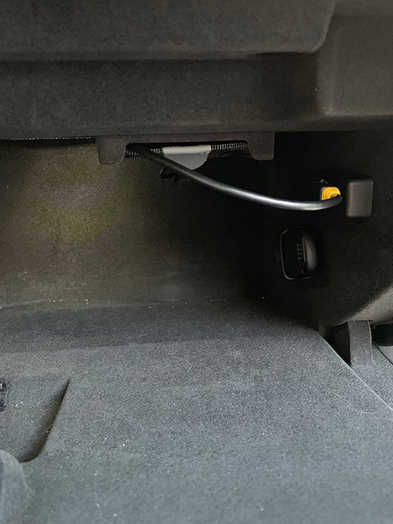

    Route the male end of the extension cable through the top right exit hole of the glovebox

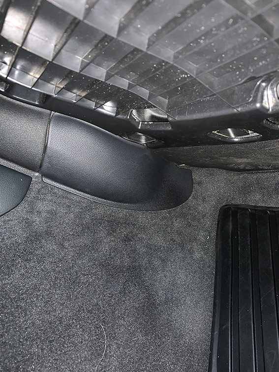

    Remove the panel in the left passenger footwell, closest to the front of the car. This is held on by a few clips. Start pulling from the right side, closest to the front of the car.

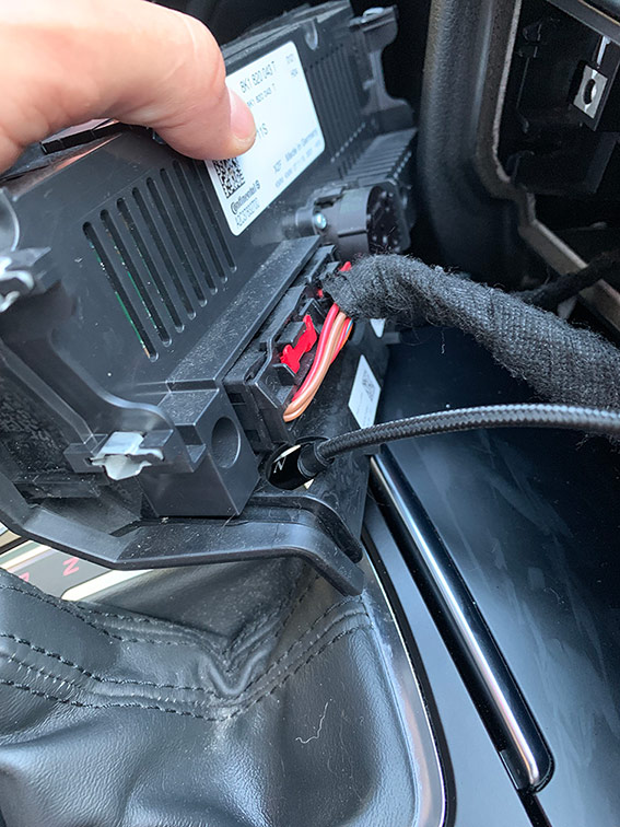

    Remove the climate control. I used the first part of this thread
    Step 5

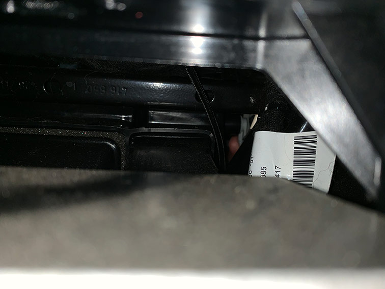

    At this point, if you look into the space where the climate control goes, you should be able to see some light from the passenger footwell. Reach into this hole with your left hand and with your right hand, feed in the lightning cable from the opening in step 3. You can see my finger poking through from the back.
    Step 6
    Feed the lightning cable through the hole in the top right corner on the underside of the climate control unit
    Step 7
    Re-install climate control and glovebox, but don't re-attach the foam cover under the glovebox. Your lightning cable should now be poking out the bottom of the climate control.

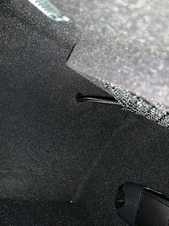

    Step 8

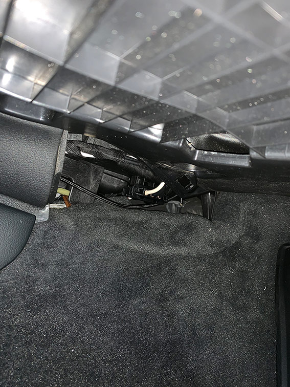

    Hide the lightning cable above the foam piece at the back of the footwell and behind the panel on the left (from step 3)

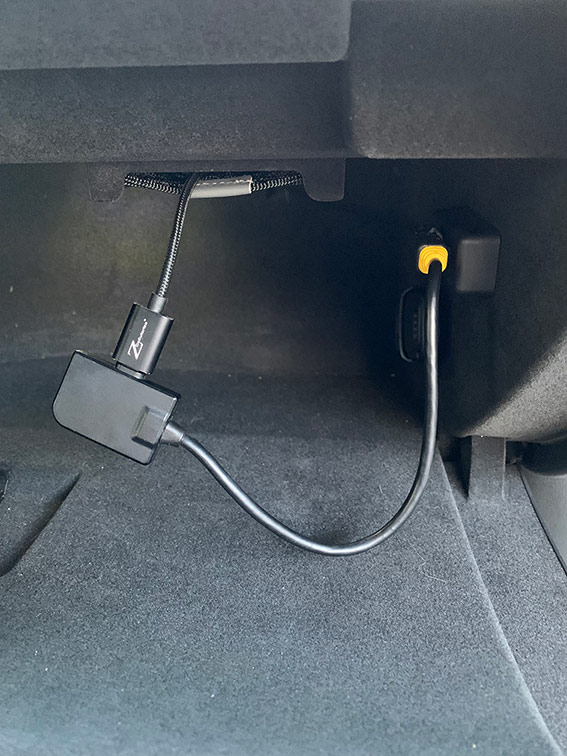

    Go back to the glovebox and route the female end of the lightning extension through the netting and plug into the male end of the AMI cable. Push it back into the netting to keep it out of the way

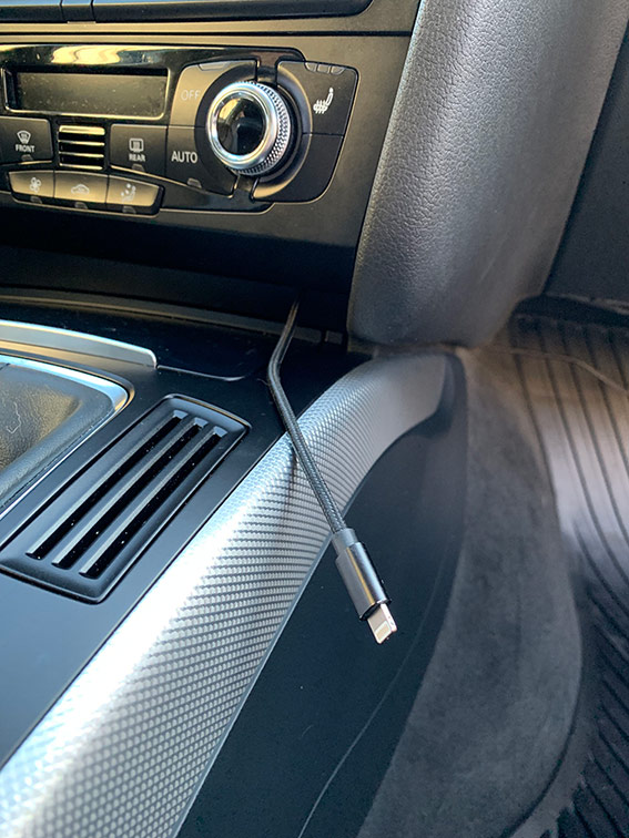

    Step 10
    Re-install the footwell panel and foam piece under the glovebox. Congrats...You now have access to your phone while it charges from the AMI port
