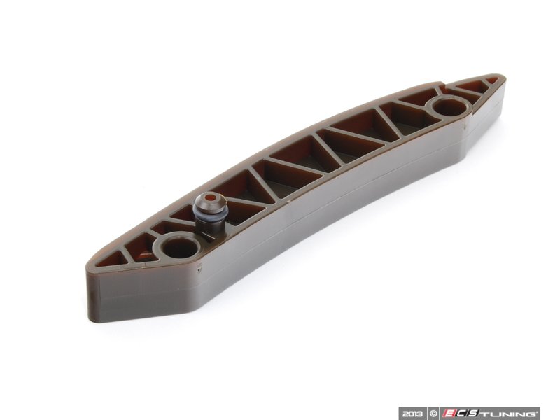

    Quote Originally Posted by Terry.Reese View Post
    Pics for reference on the upgraded RS4 guides
    1 Engine Timing Chain Guide 059109469F RS4 upgraded (lower)
    059109469E RS4 upgrade
    replaces:
    VIN below 200000 uses 079109469AC if they do not want to have the upgrade (some say the RS4 upgrade doesnt work) others say it does.)
    Notice the oil nipple that goes into the block. this was states as not essential before since hole goes no where.
    2000001 matches exactly to the stock 079109469AD
    You can check for these parts too....
    https://www.europaparts.com/timing-c...59109469f.html
    https://www.europaparts.com/timing-c...59109469e.html
