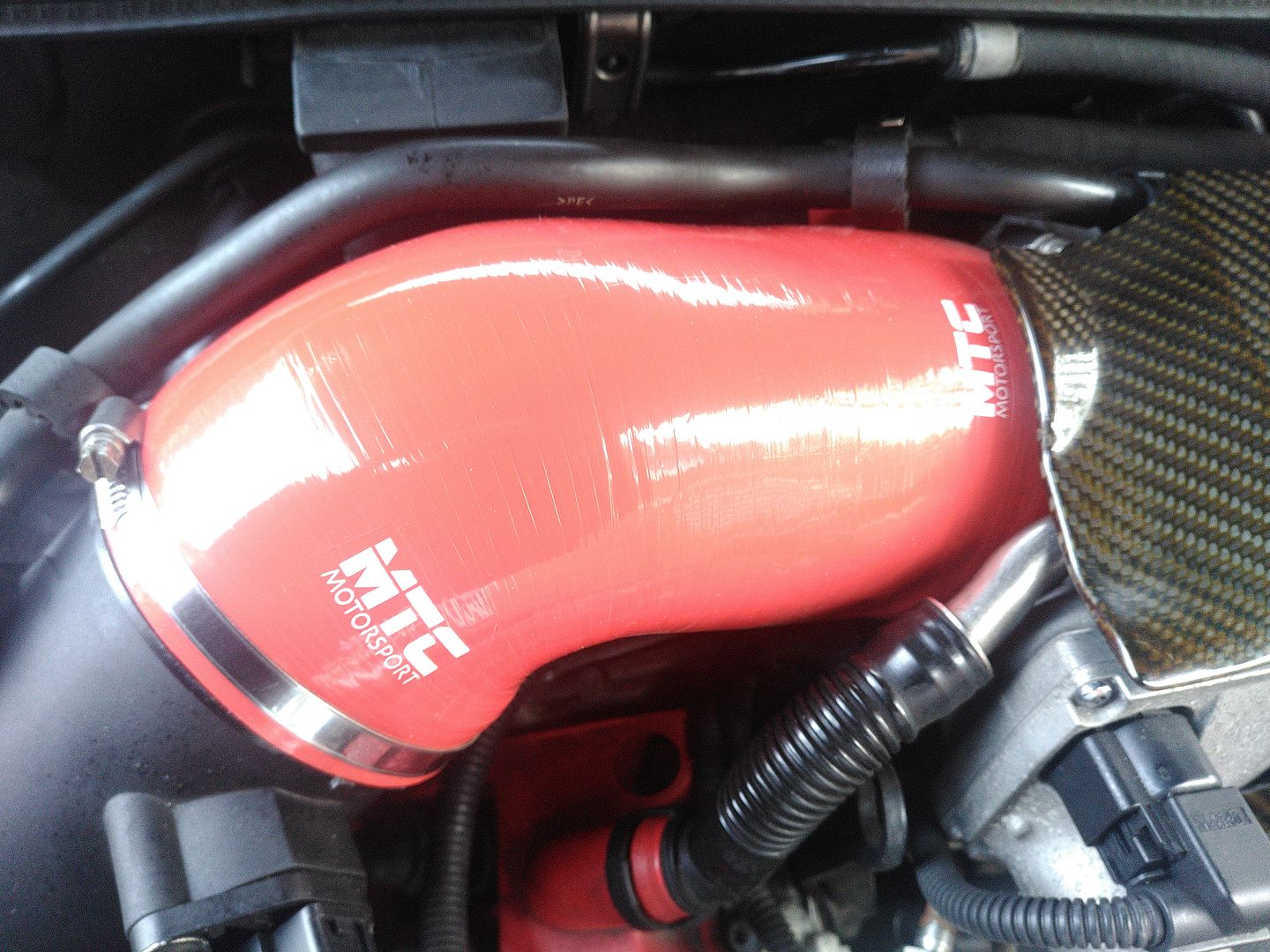

  14. #134
    Veteran Member Three Rings Fourpoint282's Avatar
    Oct 11 2015
    361428
    Atlanta, Georgia
    Quote Originally Posted by Terry.Reese View Post
    What MAF? Have a link? Thanks
    Sent from my XT1650 using Audizine mobile app
    034...it's a one piece silicone hose like the one pictured above
  15. #135
    Forum Moderator Four Rings docurley's Avatar
    94
    UK London
    It sounds like a silicon intake pipe not a maf housing change, something like mine.
    Sent from my Moto G (5) Plus using Audizine mobile app

    Quote Originally Posted by docurley View Post
    Correct, I used the wrong verbiage
