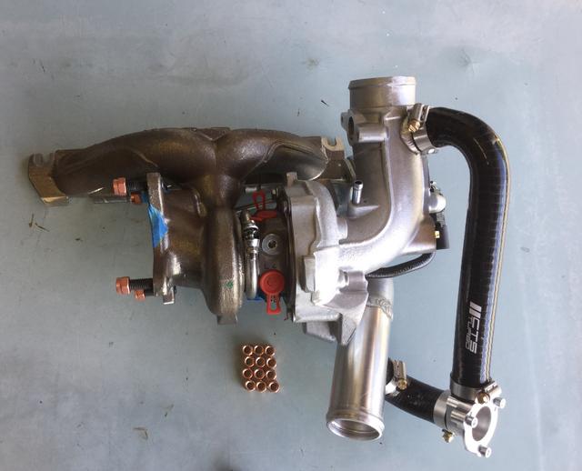

    The outlet looks exactly the same as perry’s Cts k04

    Quote Originally Posted by Traptalk View Post
    Isn't that the cts from 2 generations ago before they Incorporated the dv adapter?

    the lobo looks to still be using 2 1/4" where as the cts i think was a tig welded 2.5", which was why they recommended using their intercooler kit with it. but dont quote me on that. either way... 2.25-2.5, i mean im not sure whether theres a huge difference there anyway.

    Quote Originally Posted by bb-tt View Post
    Yes, it is.
    Quote Originally Posted by Spawne32 View Post
    I’m pretty sure it’s 2.5” tig welding on the CTS K04. I had it ported and polished before installation. The Wagner silicone piping fit nicely.

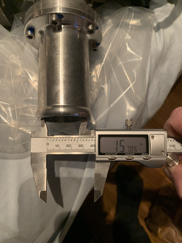

    Ok so measured the eurocode muffler delete and it is 2 1/4 inch.
    When I put the cts ko4 on I had to buy new charge pipe as the eurocode pipe was to large for the flange cts welded on.

    Some measurements from the loba comp. outlet

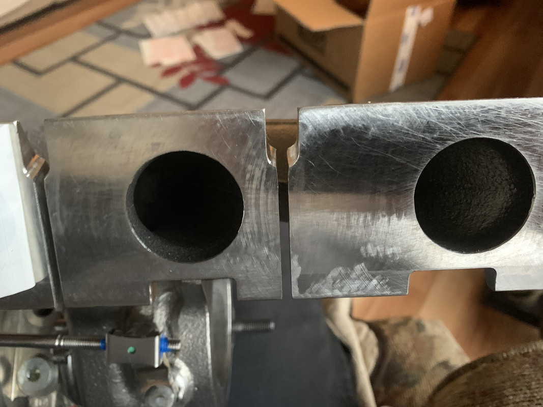

    They shipped it on a Friday from Hamburg Germany and it arrived on Monday in New York. No duties or import taxes!
    Nice shot of the clipped turbine
    Can see a drop of like ink and uneven shaving on the turbine nut. I imagine these are balancing tricks.
    Spins very nice. My turbo has no shaft play but this installation sheet they include says that “it is normal to feel some up and down movement on the wheels”
    Looks like they recommend new oil lines too if yours have any dents or imperfections. So guess going to pick up new oil supply and return lines and to be sure it’s getting good flow on first start.
    Was a little bummed that the exhaust manifold wasn’t port and polished like they do on some of their other models like the LO500
