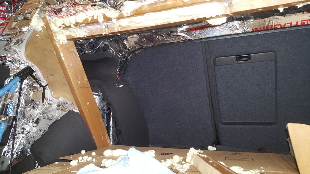

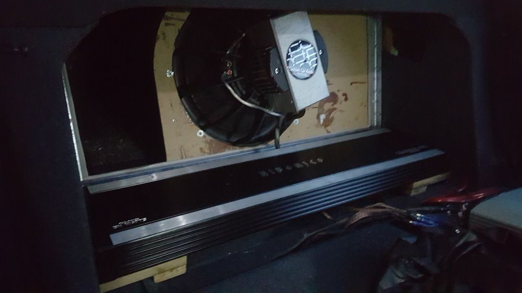

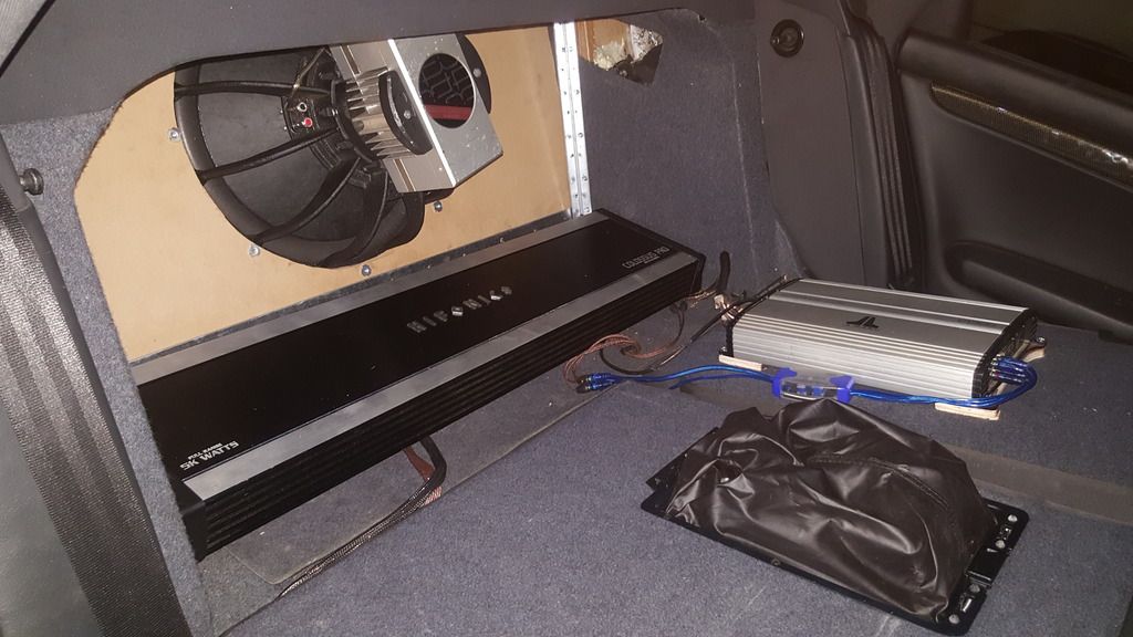

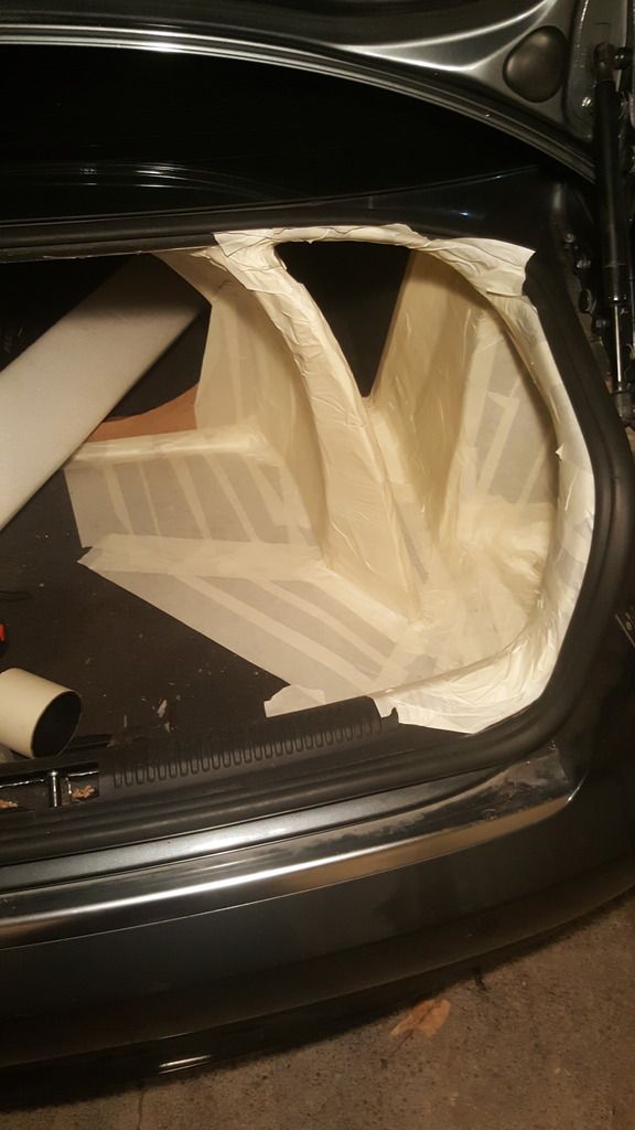

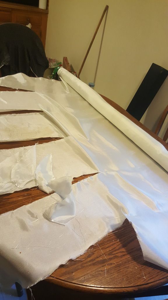

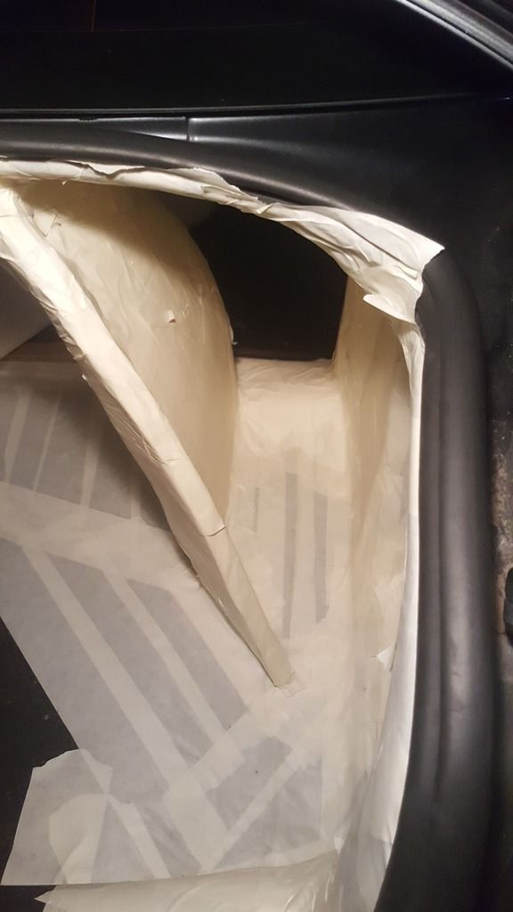

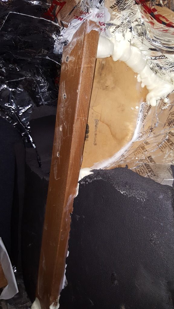

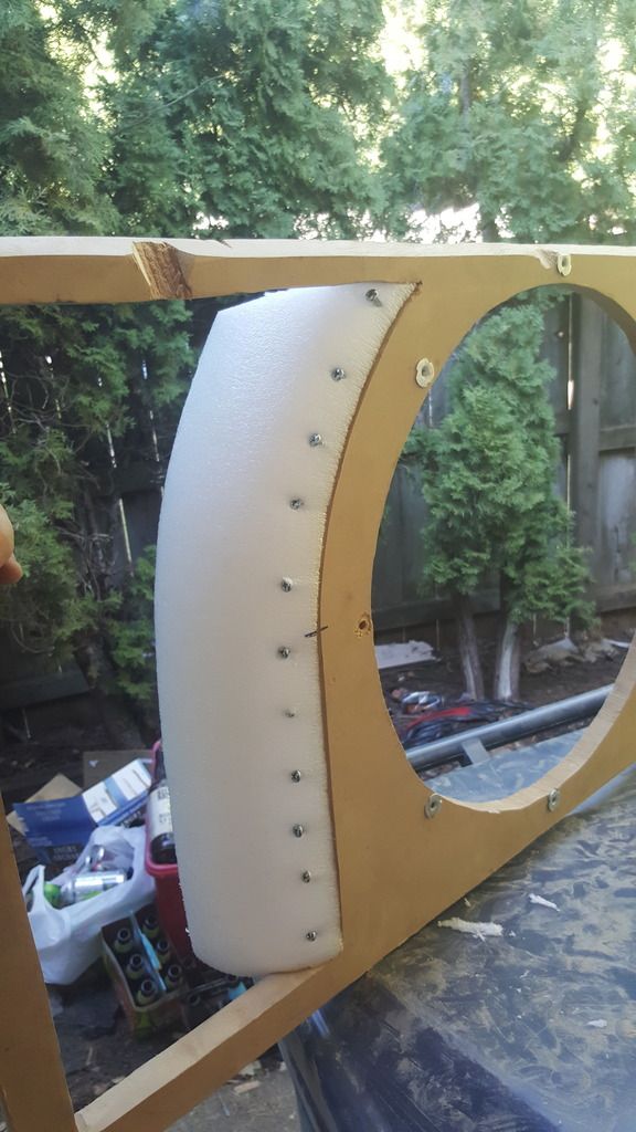

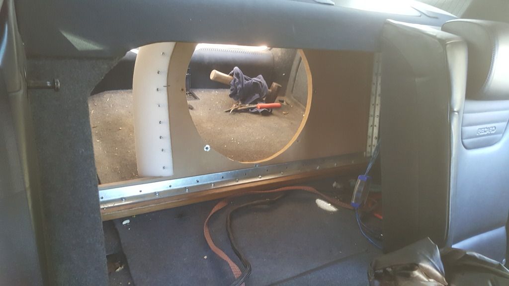

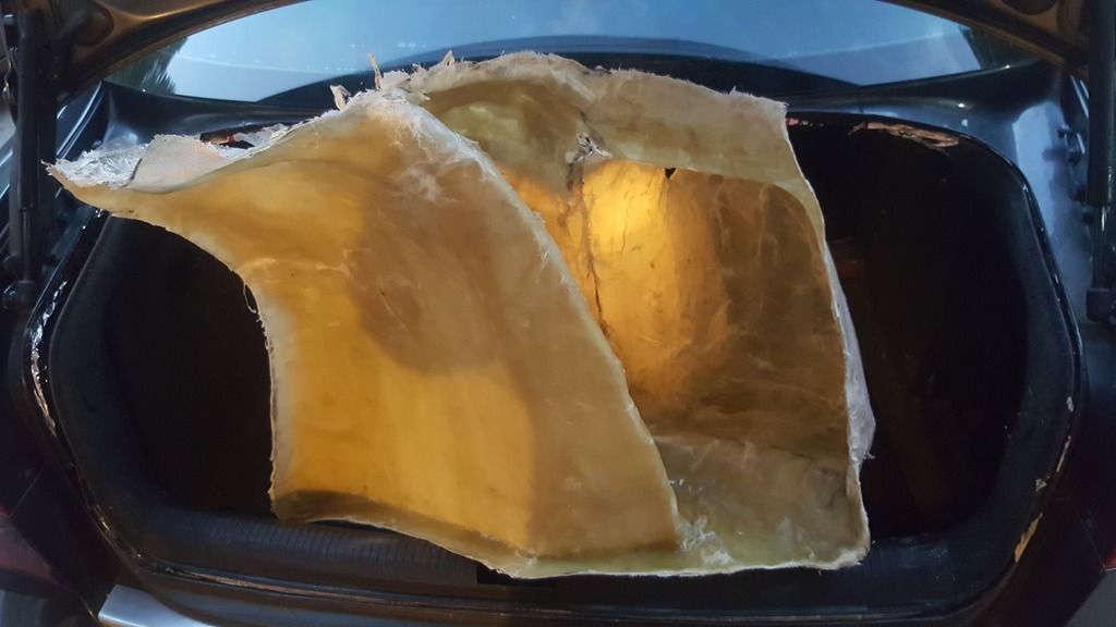

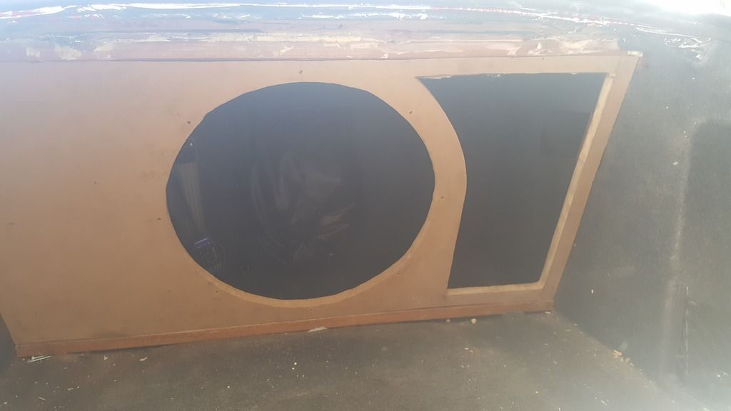

    hello Audizine. It has been ages since i have posted anything here. Life got SUPER crazy there for a while. Lots has happened since i last posted. I'll try to remember it all and update as i go.
    So i posted on a stereo forum a while back asking for advice. I wanted a daily setup with the subwoofer i have and i want it to be light weight and removable for long trips when i need my trunk. I was told to sell it and buy something that fits. LOL so i set out on a mission to accomplish just that. Lightweight is a pretty relative term, and everyone might have their own ideas as to what that means for them. For me, i just didn't want to add an extra 150 LBS for a speaker box to hold the sub in. So i decided to do a hybrid Ported/infinite baffle setup. The subwoofer i have is a Fi BTL N2 18". it needs at least 6 cubic feet of airspace to sound decent. So i did a lot of math and used a Giant bag of packing peanuts (seriously haha) to measure the volume of the trunk. i decided to basically "wall" the trunk off as its called and use the remaining trunk space as the subwoofer enclosure. i don't like everyone else's approach of just throwing a pair of subs in a small box and tossing it into the trunk. Tho it is a LOT easier, less crazy, and less expensive than my approach...lol... its just not for me.

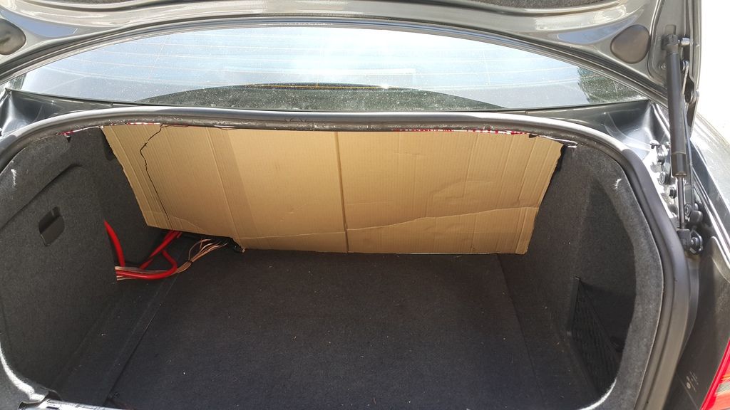

    I decided to seal the front half of the trunk from the rear, behind the trunk liner/carpet. I took some 1" closed cell foam used in industrial sound deadening applications and lined pretty much every inch of sheet metal behind the trunk liner to help with noise. I started mocking it all up with cardboard before making any cuts to make sure it would all fit. i cut some MDF inserts and glued them to the dynamat on the sheet metal. that way i can always remove it at a later time when i get bored with it or sell the car. I cut a piece of wood that fits on the under side of the rear shelf. i glued and screwed it into place using the factory screws that hold the rear sunshade in.

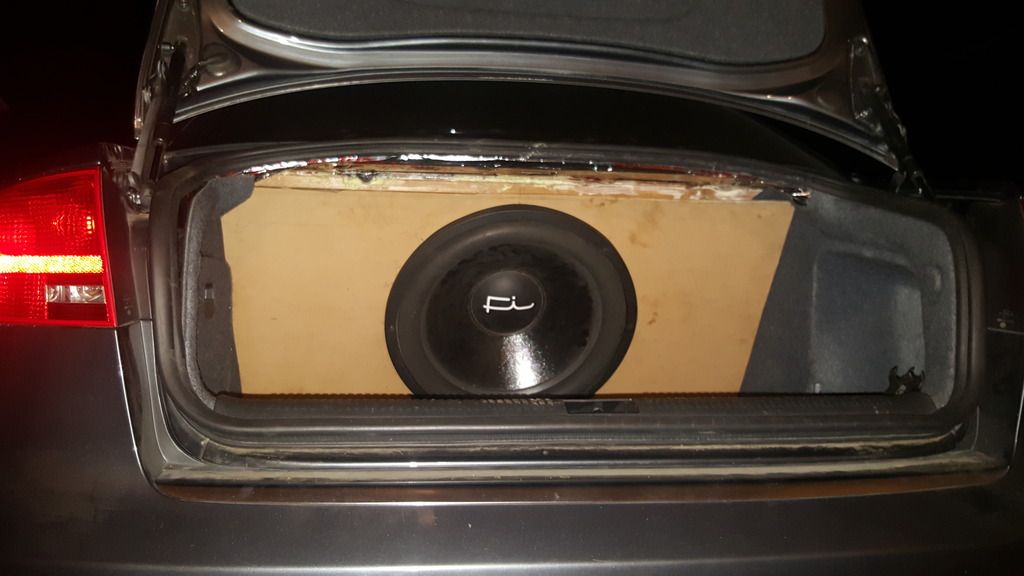

    My idea was to mount a Baffle board to the inside of the trunk at the same angle as the rear seats so i would lose as little trunk space as possible. I decided to mount the subwoofer inverted and facing into the "enclosure" aka trunk for a few reasons. 1. with the seats folded down, it looks bad ass. lol 2. if i get a little crazy with the volume, i will be able to smell the coils WAY before if the motor structure was inside the enclosure and 3. i'm going to make a grill to cover the woofer so it will be less noticeable when i pop the trunk. Its a lot easier to hide the cone than the magnet, and with the seats up, you wouldn't have a clue what lies behind them.

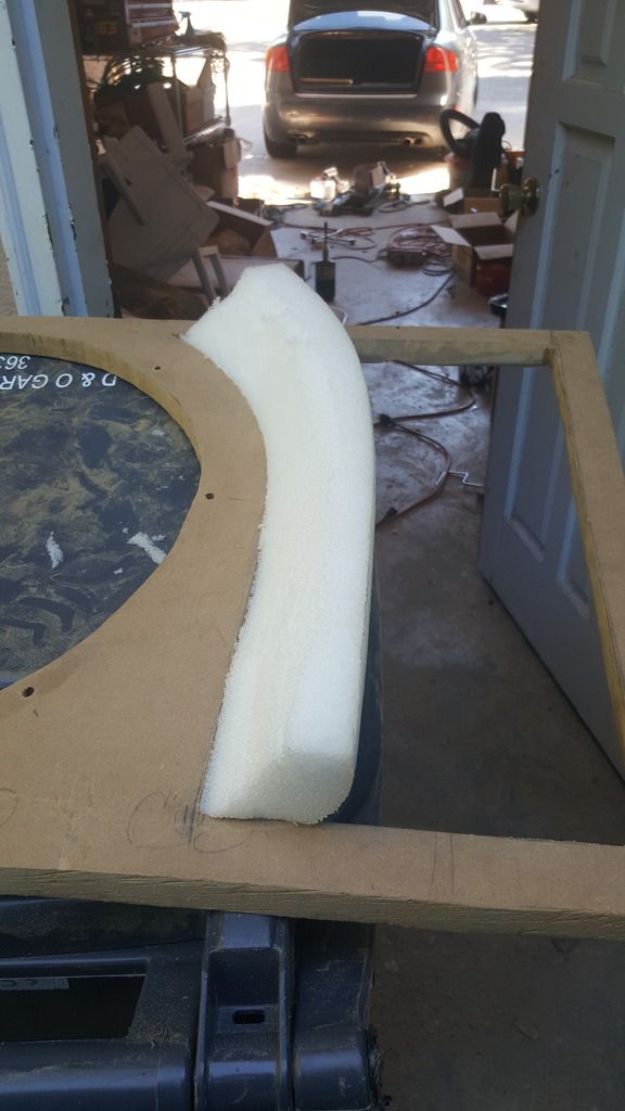

    Part of my crazy last few months was a career shift. I'm now a sheet metal worker and have access to all sorts of equipment. So i decided to make some angle brackets for the baffle board to mount to.
    I wanted to get as much output as possible so i did a rolled port. i taped the trunk off, molded some foam into the approximate shape i wanted and threw a few layers of fiberglass over it. I haven't ever done this before so don't laugh too hard at the outcome. LOL its a learning experience :) It is getting covered in carpet anyways, so i don't care if its a little rough.

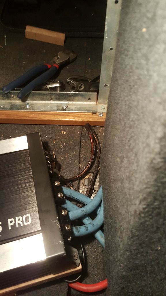

    I made a mounting bracket for my extra battery and built a bus bar to transfer the power to my amps, and built a quick amp rack to mount my Sub amp. I should have known better that buying such a big amp would come back to hinder me. lol. this thing is huge and took some finessing to get it to fit.
    Stay tuned...more to come....

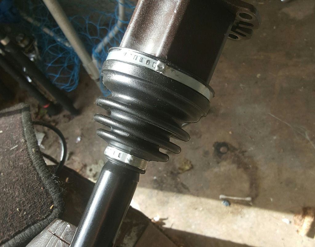

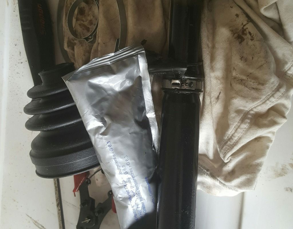

    Hello hello. It's been a minute since I've posted anything, figured I'd bring some eye candy along with some woes. Sadly, I have had to park my baby and drive something else. She is in dire need of repairs and I can't daily her any more until she goes under the knife. More about that later. Now, onto the good stuff..

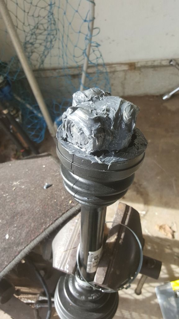

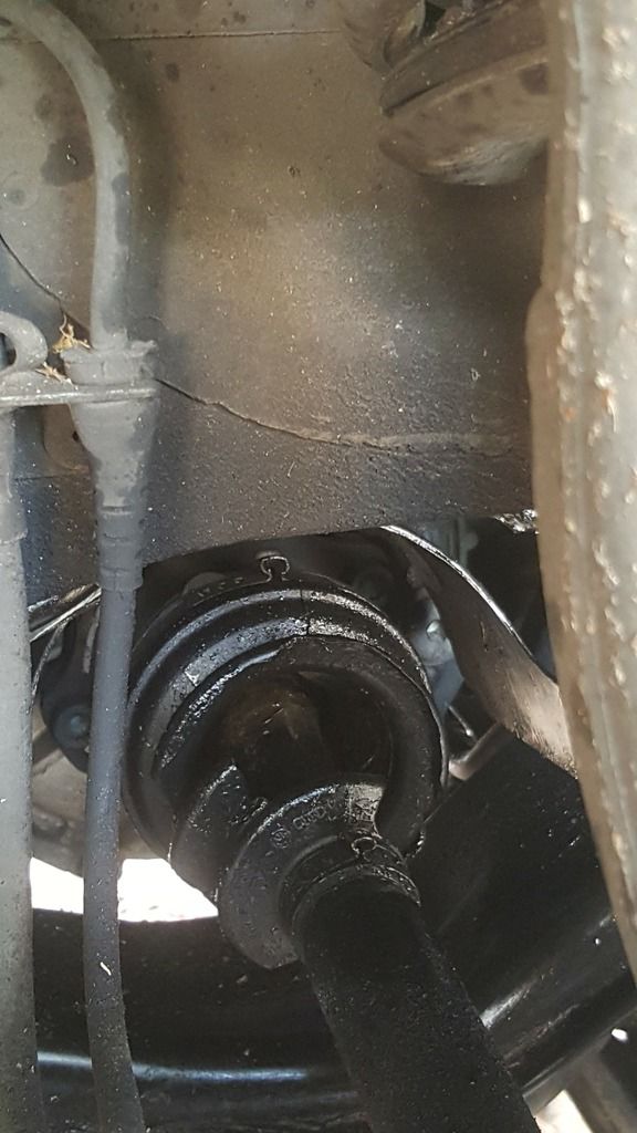

    After lowering my car, the front tires now had more camber than stock due to non adjustable front control arms. I ate through a set of tires pretty quickly so I bought these..
    I'm not sure what is going on in my passenger front suspension, but every time I turn my heels or hit any bump, I get a loud "rubber squealing " super embarrassing lid a** noise. I have looked At The suspension and my guess is a bad shock body. I know the shocks will fail due to being lowered. I disconnected the tie rod an the car still does it at ride height. If i Jack the car up, it goes away. I'm going to be pulling the suspension and doing a thorough looking over. Coil overs might be in my near future.
    <a href="http://s1383.photobucket.com/user/vinnybabroni/media/20161007_105230_zps4wawqrkl.jpg.html" target="_blank"><img src="http://i1383.photobucket.com/albums/ah301/vinnybabroni/20161007_105230_zps4wawqrkl.jpg" border="0" alt=" photo 20161007_105230_zps4wawqrkl.jpg"/></a>

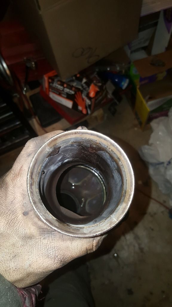

    Pulled the downpipes and gutted the front cats. I feel like it woke her up a bit, however, it brought with it a resonant sound right at the floor of the car. Not to pleased with it so I'm going to make some downpipes soon. More to come with that.
    Driving home from the mountain and had a bad slapping sound. Found this
    Soo....

    With respect to the downpipes, just order the SS Autochrome ones. I've had mine in for about a year now and I've had no issues with them (knock on wood). Trust me, having fabricated my own downpipes on my V6, it's way cheaper and far easier to just shell out $300 and be done with it.
    Contrary to what all the ignorant naysayers think, the SS Autochrome catless downpipes are every bit as good as the JHM ones and can be had at a fraction of the price.
    *****One thing to note, YOU HAVE TO CHANGE YOUR CAM TIMING IF YOU GO CATLESS!!!****** In a nutshell, you have to separate the lobe angles way more with catless downpipes. Otherwise you'll get a big dip in torque. I've documented it all when I did my downpipes. I suspect the issue has to do with the fact that the S4 exhaust manifolds have those hydroformed internal sections. Basically, what happens is you have the exhaust pulse exiting this tiny high pressure section, then once it hits the open 2.5 in area where the cat used to be, you get a counter-pulse which causes a reversion before the exhaust valve even gets a chance to close.
    I know it seems counter-intuitive, but I have tons of logging data that shows a loss of power with the amount of overlap that the stock ECU demands early on in the RPM band.
    If you want, PM me if you go catless and I can send you a .bin with my own revised cam timing tables.
    Also, make sure that you have an H-pipe or an X-pipe as well. Again, you loose power if you go catless and the cylinder banks can't equalize pressure.
    **********PS: also MAKE SURE THAT WHEN YOU BOLT THE 6 SPEED TO YOUR TIP EQUIPPED BLOCK THAT YOU INSTALL THE SPACER!!!!******* I made the mistake of bolting a 6 speed to a tiptronic equipped block without the spacer and ended up with a 10 inch crack all around the bellhousing

    Hey Vinny, where'd you get the axle boots? I need to do that myself.

    Quote Originally Posted by q_dubz View Post
    If i remember correctly, I got them from eithet rockauto or ecs tuning. Ill be ordering a few more to make sure the ones going on my car will be good to go.
    Where is a good place to get valve guides and seals and headbolts?

    Here are just a few photos to get started...many many more to come!
    Why does audi think this is a good idea to flatten out the exhaust pipes? Lol this is deffinatey robbing the s4 of breathing properly
    This will be my work bench. It will be nice to be able to stand and work on stuff! Ignore the crap behind the table lol
