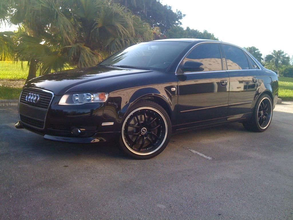

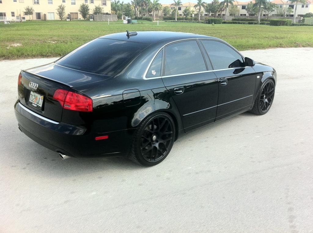

    Phase 1:
    There was a lot that was wrong in this phase lol, but you have to start somewhere. In the first couple of months of having her I had a proper 4x4 stance, Votex chin splits, clear side markers, eyelids,19” wheels (can’t remember the brand), trunk lip, smoked tails, and custom trunk with 2x 12 Kicker Comps. It wasn’t long before I couldn’t stand a look so phase 2 kicked in.

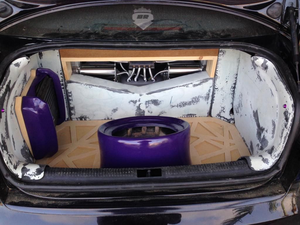

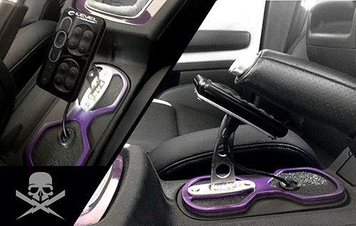

    Phase 2:
    This was a busy phase. I ditched the the tinted tails, the old wheels, and got the ever popular VMR V710's put on with Vogtland Sport Coilovers. The car also had an APR stage 2 with test pipe + turbo back exhaust, Forge DV, and Carbonio Intake.

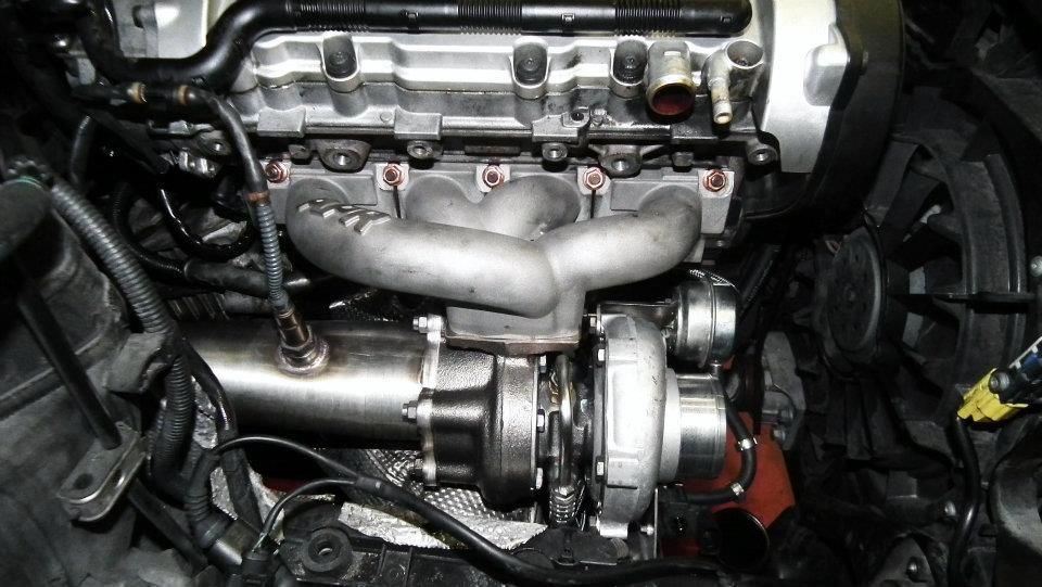

    Soon after that I felt the car need some more power so a few modifications were in order. My friends at Novitech Tuning did my install. I decided to go with the APR stage 3 (which was the best option IMO for a daily at the time), an AWE FMIC, and AWE Meth kit, stage 3 clutch and fly wheel, brake upgrades, 034 stage 2 catch can, 034 motor mounts + Apikol snub, and a few other things.
    After getting the power to a good place my thirst for the low kicked in so I tapped into Bag riders for and e-level kit with air lift struts. I planned out the trunk layout and my friends at Novitech helped me with my install.

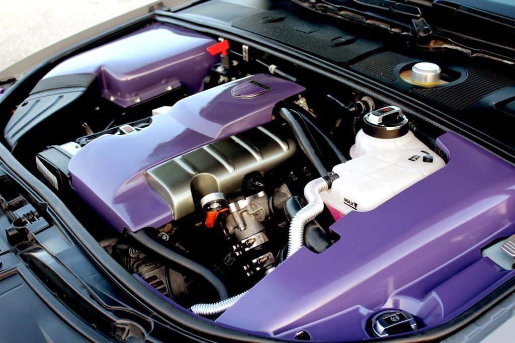

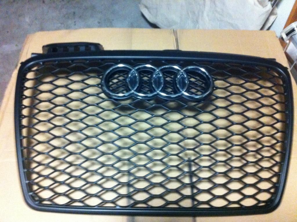

    Next I worked on a few cosmetic mods like my RS6 grill conversion, and engine part painting, and new set of wheels.
    This is my custom crash bar cover that goes behind the RS6 grill

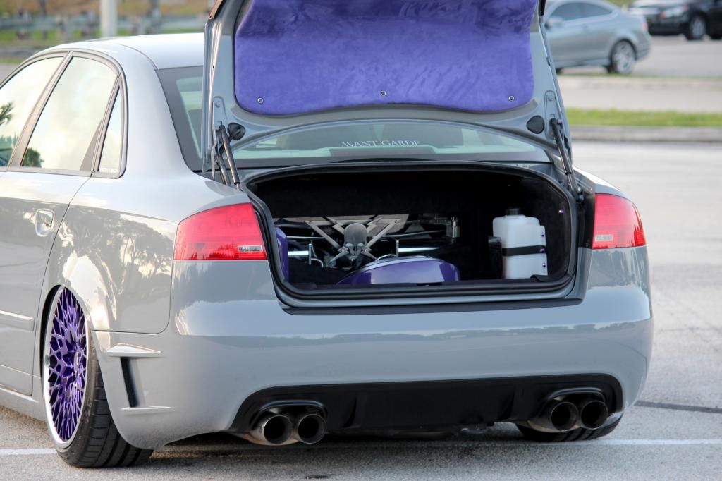

    Phase 3:

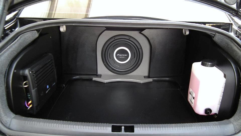

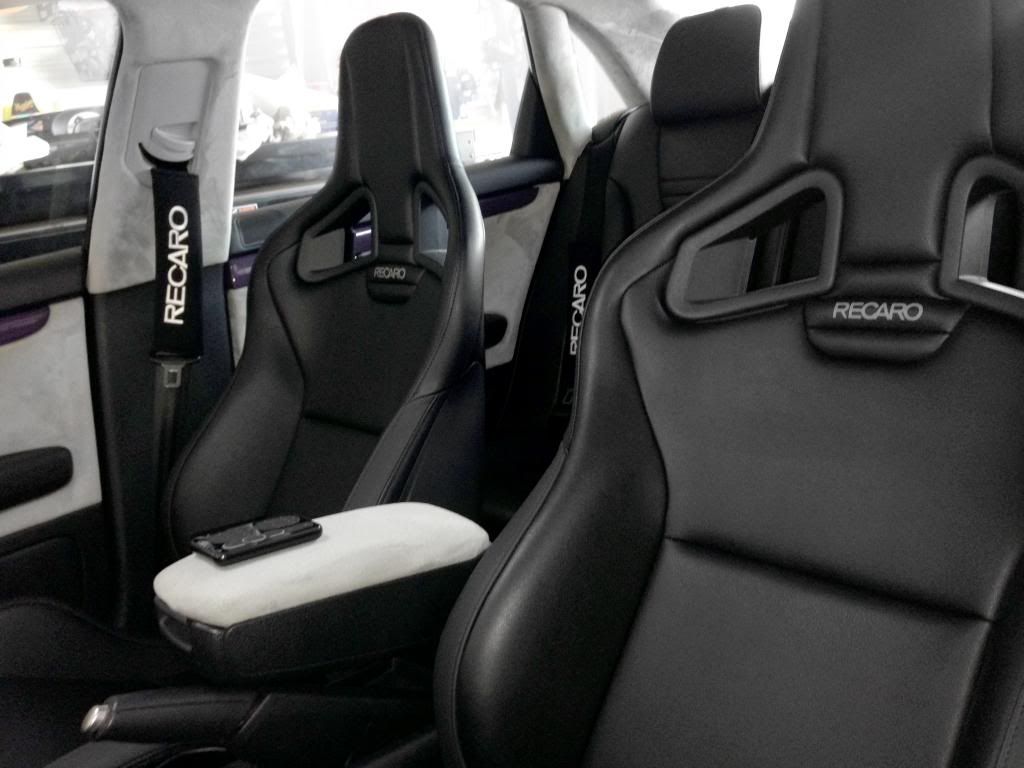

    In this phase I concentrated on the interior and new exterior scheme. I decided to do a full DTM conversion in Nardo Grey with a new set of wheels from AG wheels.
    When I concentrated on the interior. I got Recaro Sportster CS for the front and leather S4 seats for the rear. I redid all the door cards, pillars, headliner, sunroof, rear deck, arm rest, and shift boot in platinum suede. I painted the trim and made a few custom parts like a custom emblem to replace the quarto one on the dash, a custom e-level controller pedestal with cup holder delete, and a few other things.

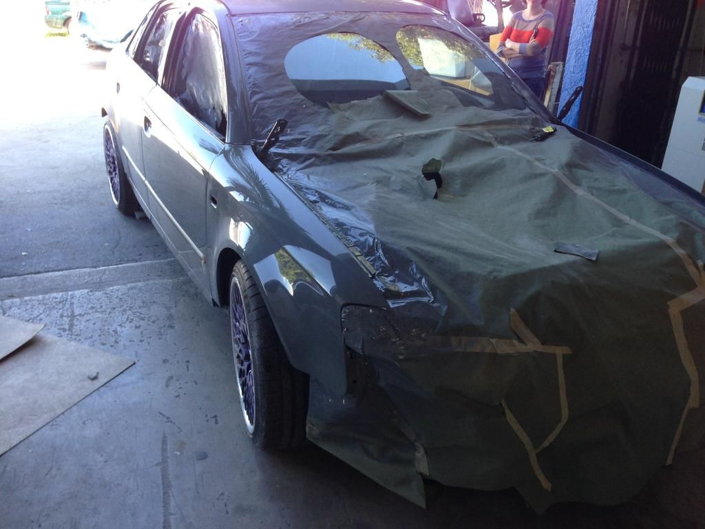

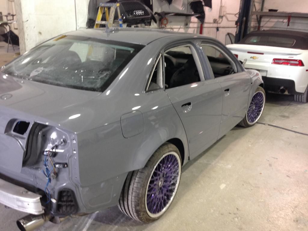

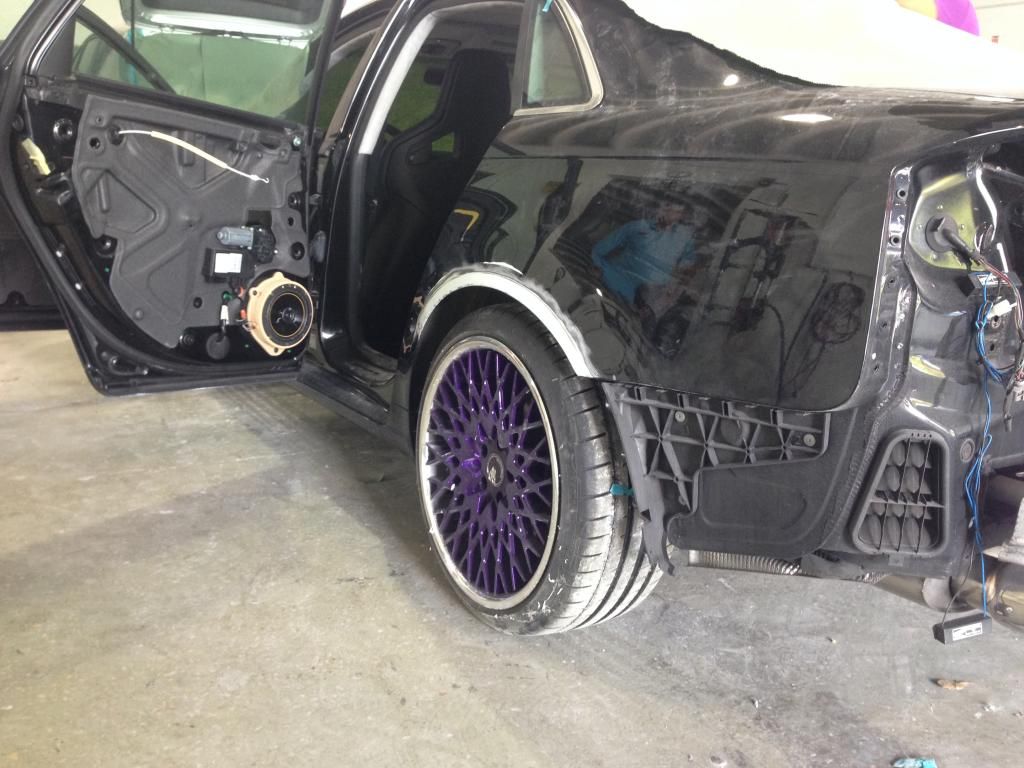

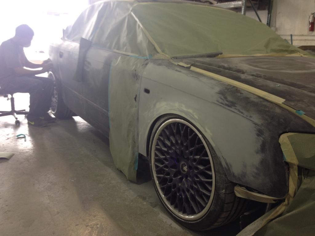

    Here are some shots of the car at the body shop getting it's color change and DTM refresh.

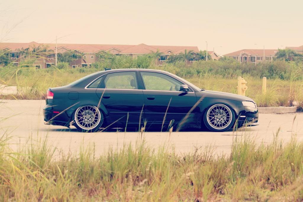

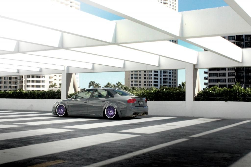

    Here are a few shots of her completed.
    I'll post some shots of the trunk build a little later.

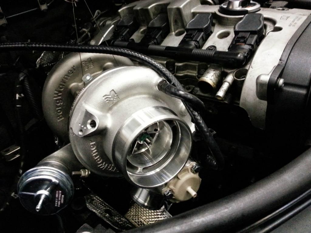

    Yeah after all the research I did and listen to others the 30R is the right size for our engines. Seal66 might be jumping on a an EFR 7163 so there is that option too. The shop that's putting on the 7670 damn!! That another monster turbo! Can you take any pictures because a B2 framed turbo is huge! For fueling my shop (Bluewater Performance) is going to use the APR in line pump on to LPFP and modify a TTRS LPFP and I'll be using RS4 injectors. Oh yeah and don't use Maestro there are plenty of other custom tuners out there that will do a better job.
    I found a pic of the 7670 on their Facebook page. I know they were modding a Maestro tune to have it run. They are aiming for 500 AWHP with moderate boost levels. The owner also went from front track 6MT to a Quattro swap which is nuts in itself. Now for fueling not sure what they are running I'd have to ask now I'm actually curious, I'd guess custom fuel rail but not sure. I know there are other B7's in SOFLO running 35's with moderate tunes. But I have to sit with my shop and discuss the different routes I can take.
    Veteran Member Four Rings Firefox250's Avatar
    Nov 17 2009
    50835
    BT B7 A4 Sedan Quattro & B7 A4 Avant Titanium 2.0T Quattro
    Aurora, Colorado
    (Noel's) Nardo Grey - Big Turbo - Bagged - Build Thread
    Quote Originally Posted by Noel Artiles View Post
    Thank you for the compliments guys.
    GD!!! That is nuts! There is no room in that engine bay. Good for that guy and the other B7's running 35R, but see that's the problem they all will be running mild tunes because they don't have the rev range to get the full use of that large of a turbo. Shit, I'll barely be able to with my 3073. The HPFP is only good till 8k and our transmissions are not supposed to shift passed 7.5k.

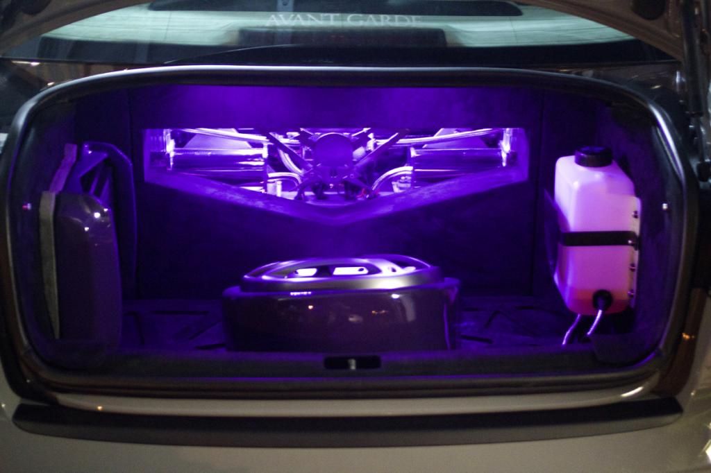

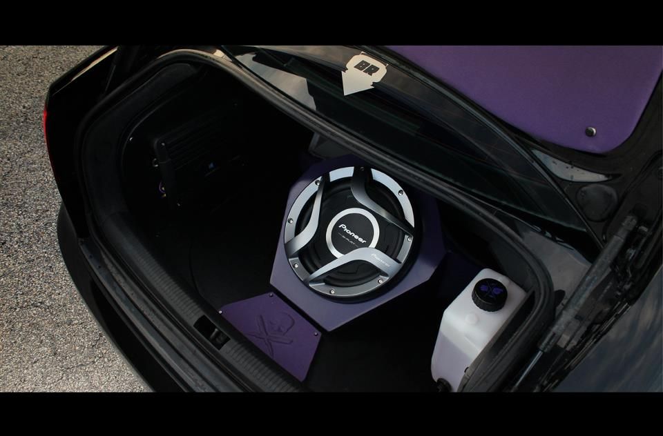

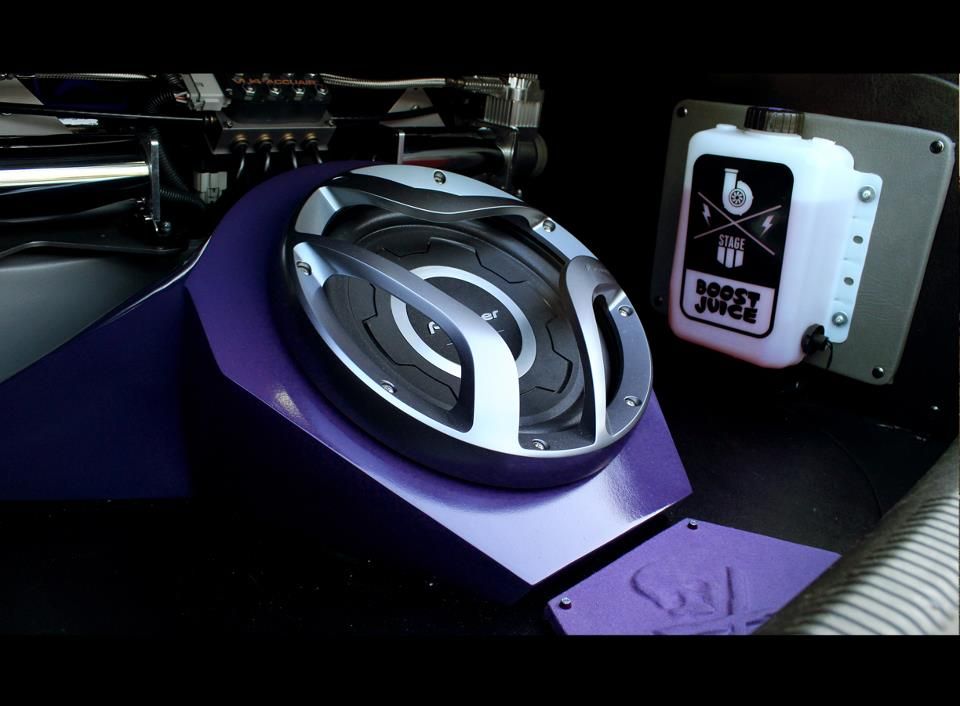

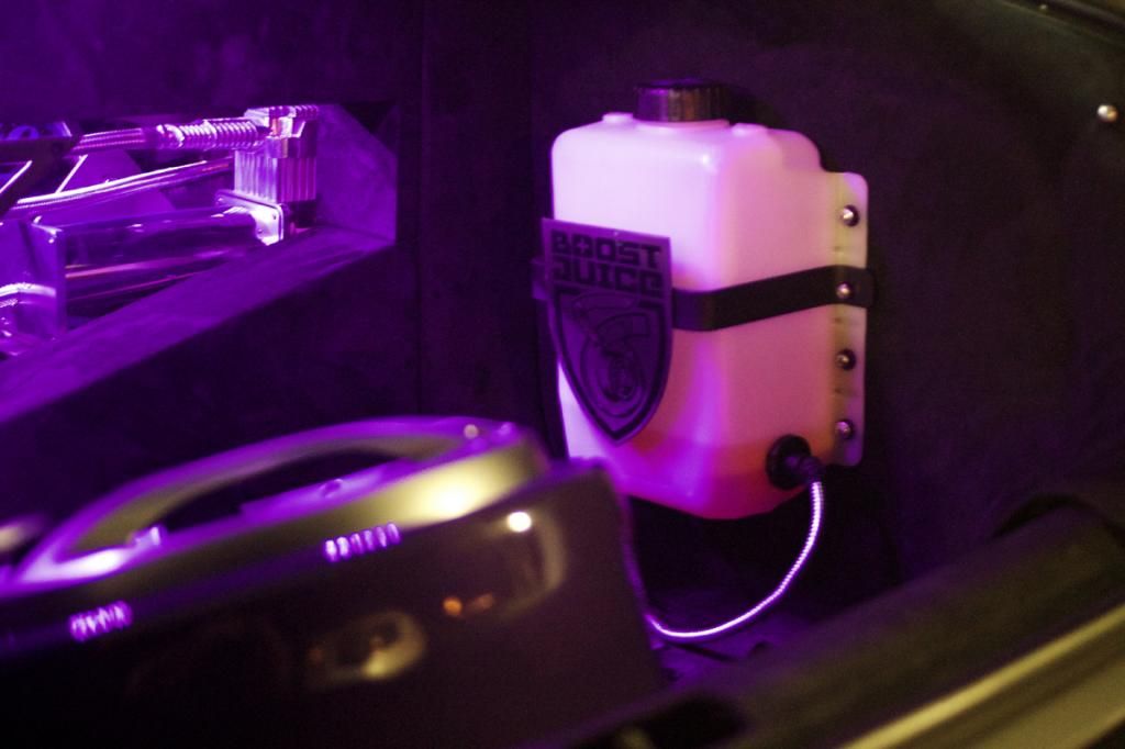

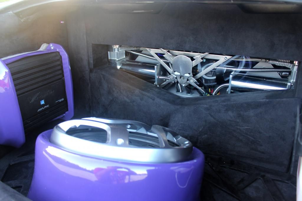

    Here are some shots of the trunk build.
    Dec 10 2011
    85071
    991 C2S, Stage 3 S4, E46 M3
    CLT | MKE
    I may not love the purple theme, but I certainly can't fault your execution!!
    Beautifully done!!

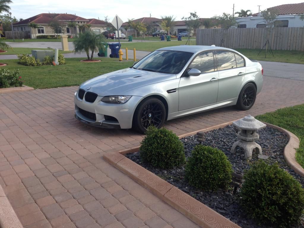

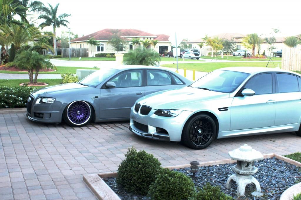

    Quote Originally Posted by drumnjuny View Post
    if this is how you treat your b7... i need to see your e90 haha
    She's not a bad looker, here's a few pics. I've kept her pretty stock other than some cosmetic upgrades (wheels, blacked out grills, painted emblems, carbon fiber lip & spoiler) since she's the daily. If I touch the engine I would have my balls cut off at home. Trust me if it was up to me the thing would have an Active stage 3 kit on it and slammed. I am going to get AG to cut me some aggressive 19's this coming year, do a moderate drop, and exhaust but nothing crazy.
    Big sis and the temperamental little sis.
    Jul 12 2010
    61335
    848 Corse, SQ5
    washington dc area
    [IMG]
    [IMG]
    [IMG]
    god, i absolutely fucking love e90's. that lip looks amazing.. what brand is it? my cousin is getting a lip on his e93 and i keep convincing him out of shitty ones. i will suggest this one.
