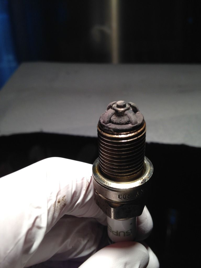

    Here's a shot of one of my driver's side front plugs during my oil consumption problem which has since been remedied. These plugs have around 38,000 miles on them.

    Yes, a plug that was fouled by oil consumption will need to be replaced. But a healthy engine doesn't need new plugs every year.

    I uploaded a photo in this thread and in another one. You can see it above. The plugs are fouled from an leaking valve seals which have since been replaced. Even though my plugs have only 38k on them I'm going to replace them and then decide on an interval somewhere between 50-75k after that. My coils aren't causing any misfires or other issues so I'm thinking they're okay for the time being.
