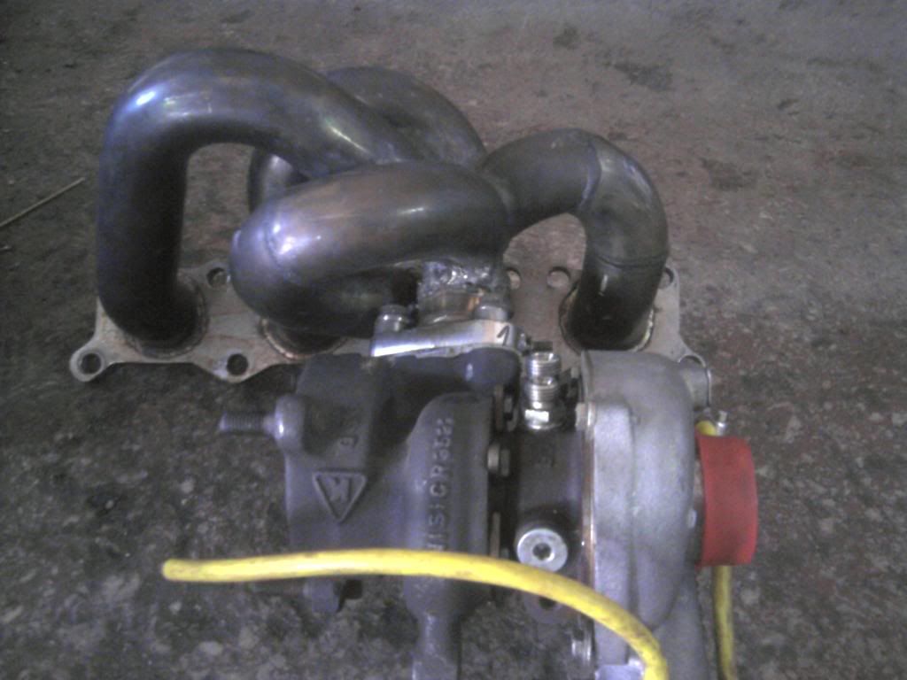

    i see that i've impress you .. this thing is built in greece from 2009. Just to get an idea of what greeks can do if they deside to work ...
    too bad i didn't mention about it earlier or going that root my self...

    You can't NOT use that FSI s3 manifold. Its integral to the turbo hotside.
    In other news, I've never seen this done. Thats awesome. The S3 K04 is a hell of a turbo. Nothing like the weaksauce K04-15 us 1.8t guys are used to.
    That S3 K04 has billet wheels and a much revised blade profile, etc. Its a totally different beast than the k04-15. Lots of the 2.0t guys make over 300awhp with it no problem. Just need some rods and you're good.

    Quote Originally Posted by texasboy21 View Post
    ^Even used the S3 manifold, well done.
    They use what people like to refer to as 'turbofolds.' The housing and manifold are 1 cast piece.
    Quote Originally Posted by vinny.dtw View Post
    Thats one hell of a efficient k04 if you ask me.
    I think it's incorrect to call them K04s.... K04 is just a model family. The last three digits or full part number denote the most important points. I.e. the K03-015 vs k03-073 & k04-015 vs k03-022. These ones are just minor differences, yet their is considerable difference in power potential.
    This is effectively what FT/Doug/aftermarket manufacturers do. They take a bigger KKK wheel and stick it in an existing housing for bolt on solution.
    -Still doesn't quite compare to whatever K04 they're using from factory in S3/TT-S etc. It is easily 25/28 sized turbo territory though and not some mismatched/machined contraption.

    Quote Originally Posted by Bische View Post
    If we still keep our bandwagon'ing to a reasonal level, the existing GTRS/71r kit is still cheaper with more potential.
    how much more power an 3071 elim could provide compared to that k04 on 1.4 bar ?the car is an AWD a4 b6 and 290whp means close to 340 crank.i'm really curious to know. As for powerband elim is too lagy comparing to my friends setup. if you see it cost wise of course this k04 setup could be more expensive but we are talking about a daily driven car and the benefits of power & torque level across the rpm range is unbeatable
    bythe way i don't think that a stage1 Sti or a 335 have any chance to beat that A4...

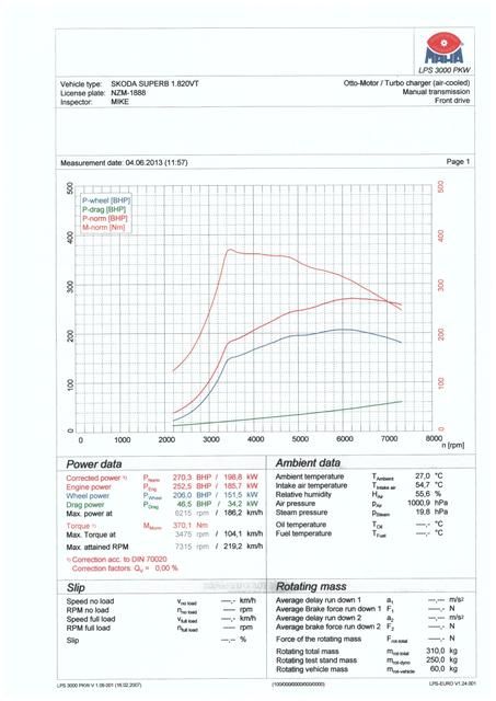

    i have one last proposal to our friend , a cheaper one but with less power. This one uses the k04 -023 from the previous S3 8L . This setup of course doesn't need forged rods and is perfect for everyday use ,far better than the normal k04-015
    those are the dyno results at 1.5 bar
