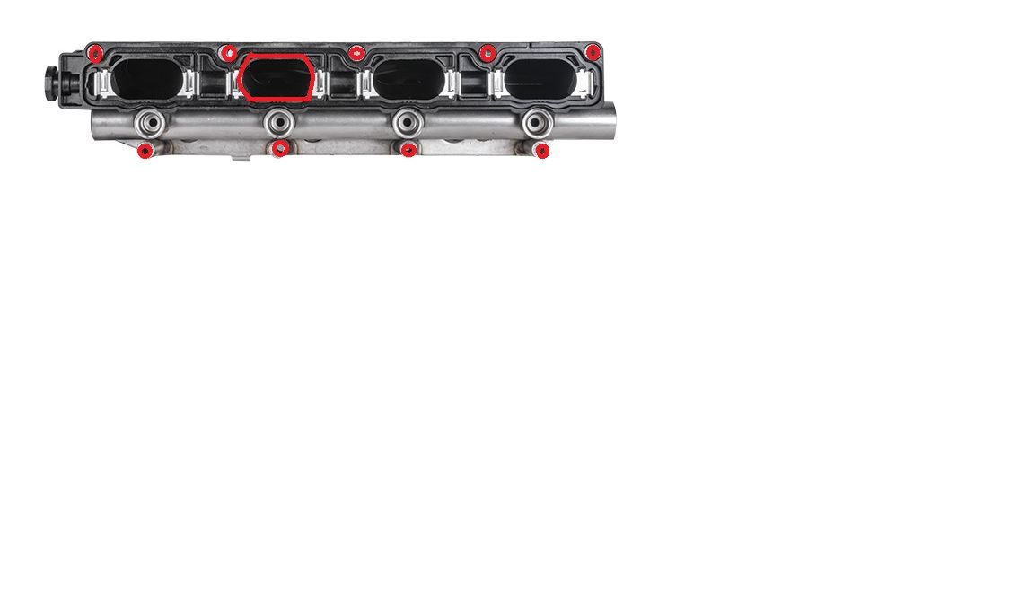

    Can someone map me the position of the intake manifold holes and as well as the port size
    I would greatly appreciate
    Phil

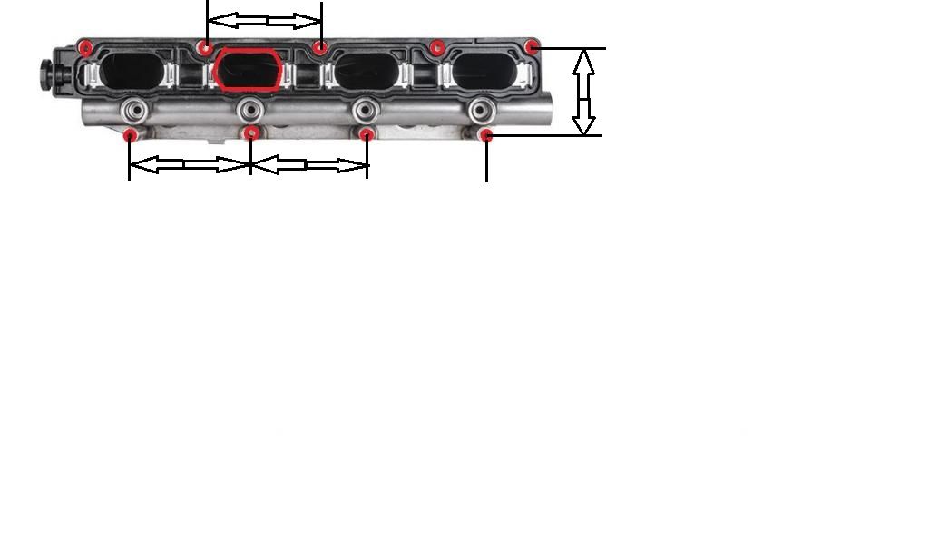

    Sorry for not being clear
    I am looking for the distance between each bolt, horizontally and vertically
    I am looking for the length and width of the port
    Phil

    Ya I got a spare one from Martin for doing melt repair :) I can measure it tonight!
    Epy

    Eric, looking forward to the data. If you caliper has milimeter capability, that will be even better
    Phil

    Nope, only measures in ft-s/fortnight :)
    Ah just kidding, I got a really nice mitutoyo caliper. Love the thing, had it since an engineering internship 15 years ago.
    Eric

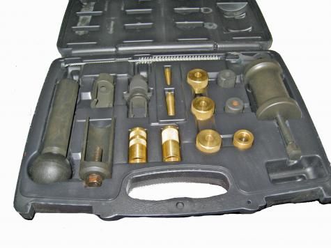

    And I just invested in the tool kit to remove the injectors and replace the Teflon rings.
    Once done, I might just rent the kit
    Phil

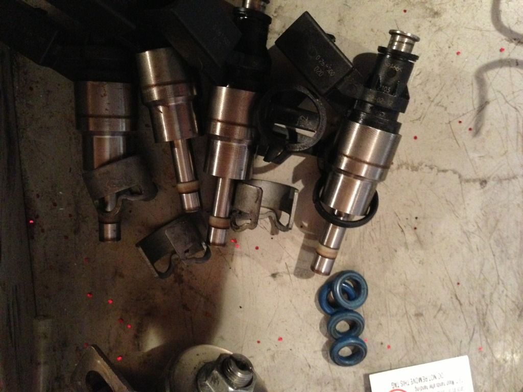

    Phil
    wow, I always just wiggle them out, cut off the old teflon ring with a razor, use a tapered punch to stretch and put the new ring on, and (this is the important part) wrap tightly with paper then tape to get the teflon compressed again, then re-install with a rubber mallet.
    Geeze I feel like an Oakie saying that. :/
    Epy

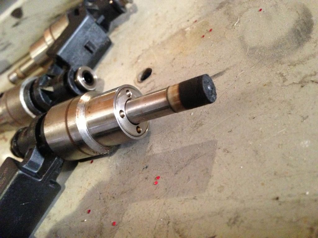

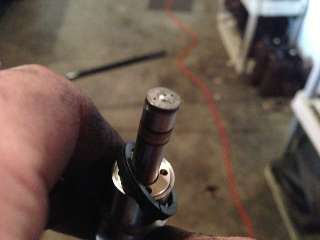

    Nice! Can you take a couple pics and explain that better?
    I just wiggle mine out by hand, clean the tips with a rag hit with brake clean, then reinstall. The teflon hasnt been an issue on mine.
    One came out with the manifold!
    All out
    Before (90k)
    After
    No leaks or anything after reinstall. Or before for that matter.

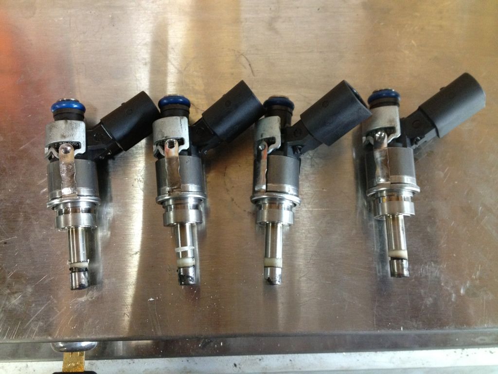

    Audi used to require (or recommend) that you replaced the teflon every time. Now that is changed to "change if needed". Bman was the one that pointed this out, and he can probably cite the change. I have only changed my teflon on 3 sets. One of those sets I didn't wrap and compress the seals and they ended up getting destroyed. Basically it looks like the teflon ring slipped up when being installed because it was too loose, and it got cut on the edge of the slot.
    Epy
    Jul 19 2011
    78443
    Northern Minneapolis, MN
    nice fancy metal clips! My plastic ones broke so I run without. They stay in and dont leak just from the pressure of the manifold/fuel rail.
