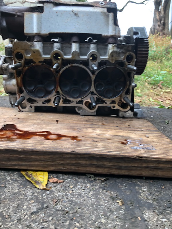

    On the hunt for 2.8 heads to swap all my valve train over too... These Lee CNC'd heads are going in the trash!
    Just about have my heads pulled....
    I am so glad that I did not buy a set of those and turned him down. That really sucks. Was the same spot that you fixed before?
    Yeah, he made the walls paper than... There was probably some porosity from the casting process and then thinning the walls up so much created the leak path (hole). I tried fixing it several times using epoxy recommended by the engine builders on the speedtalk forums, but the delta from the thermal expansion of the aluminum vs. the epoxy must be too much and keeps causing it to crack...
    Time to cut these cancerous parts out LOL.
    Any pics?

    Yeah, i posted them way back. I'm sure if you look through my photobucket you'll find them. Unfortunately photobucket killed all my hosted photos here on az...

    Here are my new to me 2.8 heads, next I need to swap valve train, then back to the fun stuff!!!

    Car is back on the road with the freshly built 2.8 heads, I seem to have picked up a few hundred RPM of spool now that me pass head is no longer leaking!
    Also picked a new toy a few weeks ago:
    The head swap from 2.7 Lee CNC ported (leaking) to 2.8 heads:

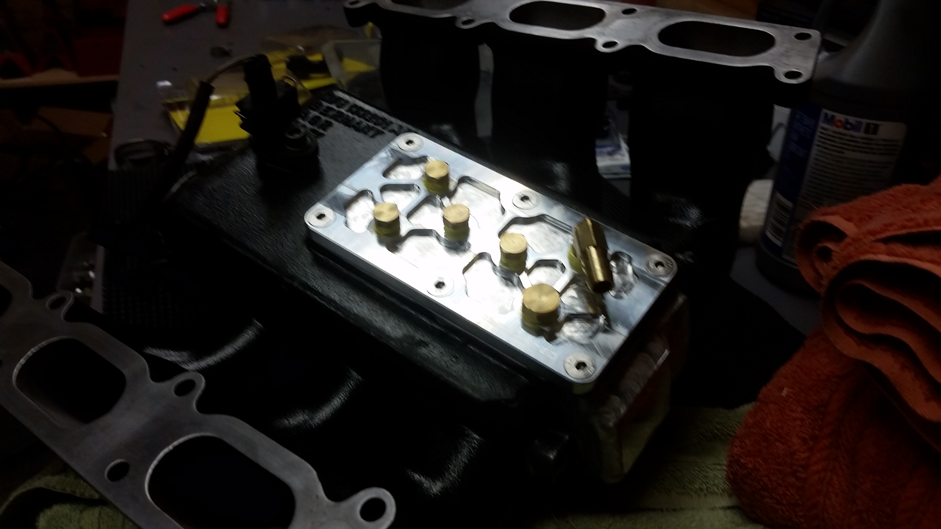

    I'm just capping off the original ports and I swithced my PCV to AN fittings and push lok hose.

    I see two different maf sensors... are you switching back to draw through?
    I like the new big filter too.
    Good luck with the new heads man!

    Blow thru maf is just a pipe plug. I didn't remake that section of pipe when I switched to draw thru.
