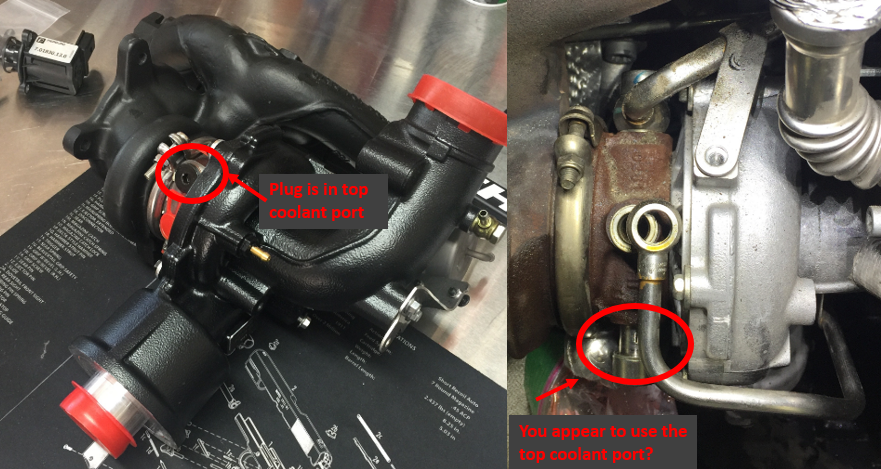

    So this guy shows the coolant plug moved to the bottom hole. Is this right or are you supposed to leave the plug where it is? The OP shows from what I see the plug left as it came but this is different.

    Quote Originally Posted by The Infiltrator View Post
    Use whichever plug hole your stock turbo uses.

    It depends on how things fit for you but they're supposed to be interchangeable. I believe most people I've read end up having to move it.
    I moved mine and now it's pissing out and I think it's the swedge since it was on tight as hell. It looks like it pulled it out from the tube a little since it was so tight against the plug below it. The plug was in the top position and I moved it to the lower.
    I'll have to check it out again and leak check one more time to pin point.
    Edit: I fixed it and it's on page 18 of my build thread.

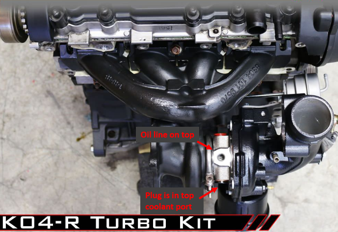

    All:
    I just did the K04-R swap on my 2012 A4 Avant.
    I did not have to swap any plugs at all. Repeat: I did not have to move or swap positions of any of the plugs on the JHM K04-R that I put in my Avant.
    Please do not think that this needs to happen. The lines will fit and if they are rotated from what "appears" correct then its gonna be ok, at least that is my experience.
    Look at where the line is on the picture above^
    Now look at the red plastic plug below:
    Again look at the line that mounts here:
    Didn't have to do anything funny at all. Please just transfer the lines.

    ^ In the last picture you can see three (3) distinct lines.
    The center one is an oil line.

    Take a look at the finished product:
    Line is exactly where the other one was on the K03
    SO look at the picture from the JHM website and its what I had when I installed mine:
    And look how lovely the ceramic coating looks after a month of hard use!
    MMMMMMM!!
    Two comparisons of turbos that look totally different to me?
    I don't know what is going on in that picture, but its nothing like what I went through.
    Can you provide some close ups?

    @ A4 Centaur
    I am straight up confused. Regarding the passenger side coolant ports, please see my screenshots of your pics below. Everyone in this thread has said that our cars use the top coolant port.
  34. #114

    Quote Originally Posted by A4x View Post
    @ A4 Centaur
    It all depends on what the other side plug is. If one is on top the other is on bottom and vise versa

    Quote Originally Posted by Alex1188 View Post
    Really? I thought it didn't matter which port to use on either side. Whichever lines up with the lines on the car.
    Technically it doesn't matter, but you'll get the most cooling with cross directional ports being used due to the coolant being in the turbo longer.
    @ A4 Centaur
    For me I had to swap the top coolant plug to the bottom.

    All:
    I did not remove any plugs and placed the lines exactly where the plastic shipping plugs are located.
    Where the crazy large sized XYZ bolt sits next to the frame rail is where I placed the coolant line.
    I did not remove any plugs.
