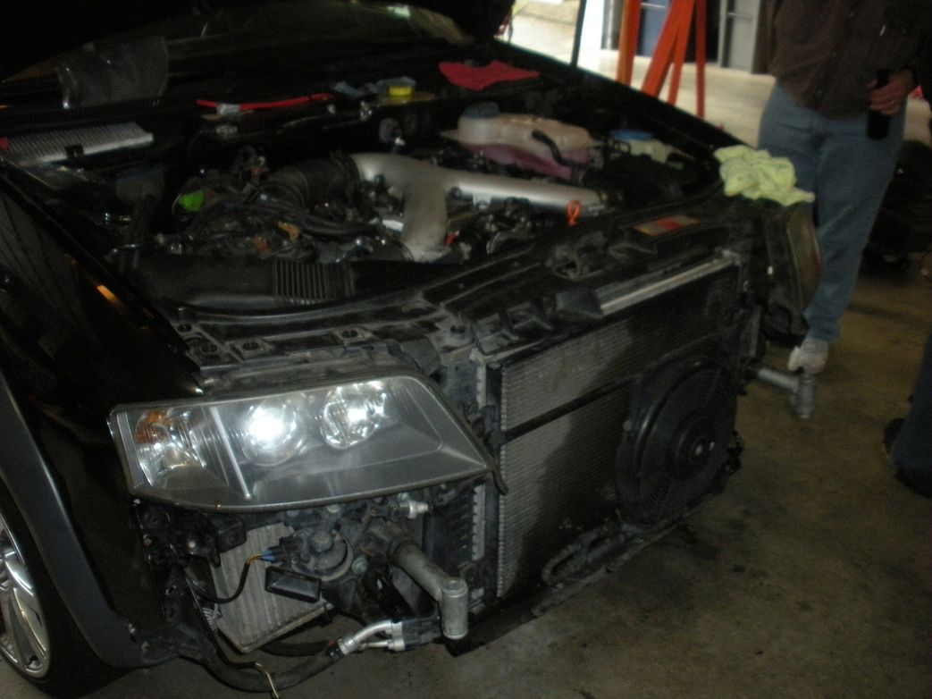

    1. Remove headlights - see my other write uphere.

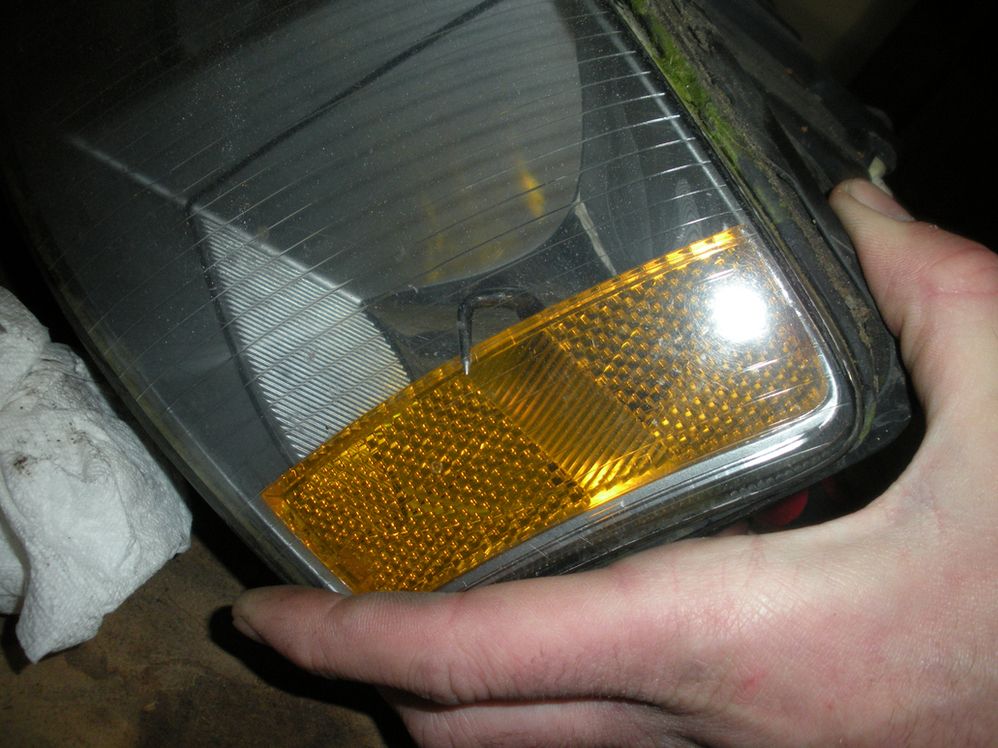

    2. Insert 90degree or hook pick through turn signal opening and hook on to the center of the amber lens.

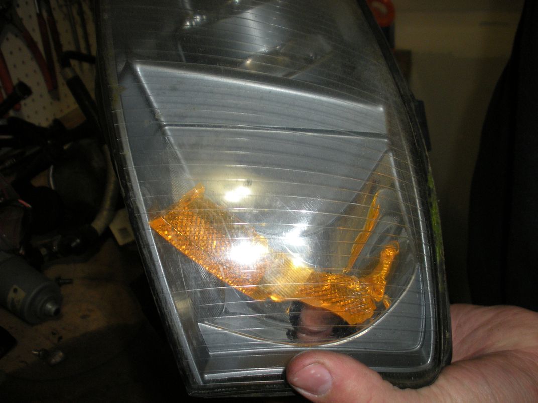

    3. Pull towards you firmly until the lens either snaps in half (ideal) or comes out of its slot (not so ideal). In the next picture as you can see, the second headlight Jason and I did wasn't very cooperative.
