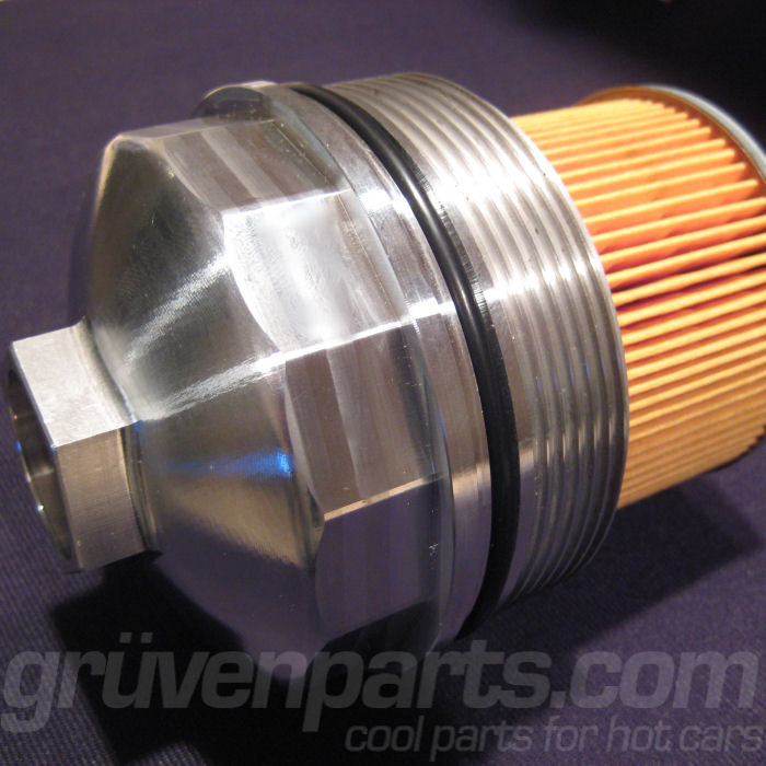

    A couple questions: Are you thinking some sort of quick connect fitting screwed into this cap, such that you could unhook the accusump hose to spin off the filter cap during oil changes? Under normal circumstances, does the oil drain out of the filter with the engine off? If so, does air pressure build up in the filter prior to oil filling it up? And if that happens, what are the odds that you'd fill up the accusump with air rather than oil, rendering it rather useless?
    Jan 28 2013
    108449
    North Branford/CT
    Our adapter will most likely have a 1/2 NPT fitting to make it easier to plumb fittings instead of having a 17mm drain plug. We will try to source some sort of quick disconnect fitting to go with them or to offer as an option. From what I understand of the way the motors are setup the oil does not drain out of the filters after they are shut off. In this setup all you would be doing is increasing the amount of oil being held in and after the oil filter. When the car is shut off it would hold that oil. To ensure that the Accusump doesn't overcome this pressure and discharge after you shut the engine off you would have to close the valve on the Accusump before shutting the car off.

    Quote Originally Posted by Canton Racing View Post
    Canton Racing,
    If you end up finding a good quick disconnect, Id be interested in getting it. I assume it will have to retain the 1/2" or even 3/8" inside diamter, something close to the hose ID. I can tap my new aluminum top for any size fitting. And FYI, you may want to look at 90 degree fittings.

    0000 V8, have you found a valve yet? Are you going to have it be manual or automatic?

    I'm probably wearing out my welcome, but... In looking at the complexity of this, and how we're gonna end up getting a 1 quart shot of oil out of the deal, I'm wondering if a pump such as
    http://www.ebay.com/itm/NEW-Heavy-Du...0f353e&vxp=mtr might not be a better option? It can pull oil from 5 feet down, so it doesnt need to be down low. Only downside (that I can see) is that you''d have to make two oil connections instead of one. Throw a pressure (low=on) activated switch on it, and it will shut off automatically once your main oil pump gets up to speed. Thoughts?
    Veteran Member Three Rings IslandHydro's Avatar
    Nov 29 2008
    35790
    WA State
    Fleshing out the pre-oiler (pump version) concept:
    Pump: http://www.ebay.com/itm/NEW-Heavy-Du...0f353e&vxp=mtr
    Pressure Switch: http://www.omega.com/Pressure/pdf/PSW-190.pdf
    Check Valve: http://www.northerntool.com/shop/too...5615_200335615
    I'd envision a feed from the oil pan to the pump, then check valve, then pressure switch, then feed to the oil filter. The system could be totally automatic, with the pressure switch engaging the pump whenever the pressure dropped below a set pressure (eg 30 psi). I know this is not a new concept, but I wonder how it compares operationally (and ease of install) to the accusump. All said I think it's more compact than the accusump, and would provide a steady oil pressure / feed rather than a single shot. Thoughts?

    Just get an Accusump and dont waste your time on this. They are proven in racing applications and have become the standard.

    they make top grade parts.
    the accusump is absolutely not a gimmick; it's very, very legit and some version of it is used basically universally in nearly all racing.
    second, the chain guides are engineered to have the chains slide/roll around them, not slap upon them, creating stress risers (the place the first break will begin).
    think about the amount of energy it takes to make that much noise so clearly audible through the cam covers, thru the hood, insulation, etc.
    (slap your wife half that hard and see if she minds.)
    the obvious take away here is that having oil psi built up prior to start, through anecdotal evidence supplied by several posters here, tells you that the a'sump eliminates the chain rattle by pretensioning the chains, thus removing impact damage, thus greatly reducing the chance of premature catastrophic guide failure.
    does that mean the guides won't wear out in the long term?
    no it does not; eventually, sooner or later, i reckon they will.
    as well, by not having the tensioner itself flopping about until charged with oil it too should last notably longer, or forever if it doesn't clog - it's designed to apply a steady force, not bang around.
    third - guys....for crissakes, help yourselves out - these internet forums aren't the source of all wisdom - it's clear just from this thread there's a whole lot of clueless and misinfo going around.
    if you have product questions, go to the manufacturers' sites (or, god forbid, call them on the phone) and learn for yourself what a product does and how it works; you'll be able to make much more informed decisions.
    fourth - as for canton, be grateful a big player took an interest in a relatively microscopic sales opportunity, not to mention a thread on a relatively obscure forum.
    fifth - disclaimer - i have zero experience with these engines myself - i've been looking for the right S4 for about a year, my brother found and grabbed me what will hopefully be a great one, an 04 w/ 78k that isn't in my hands just yet and i haven't laid eyes on as it's well out of state.
    anyway, a part doesn't know what name is on the valve covers, a motor's a motor when it comes to stuff like this - it's my belief that killing the rattle will enable the guides and likely the tensioners to live to and beyond their DIL.
    fwiw, especially since i happen to have an accusump still laying around (i'm essentially retired) it'll be one of my first modifications to the car.
    HTH someone, no offense intended.

    I have to agree with Speedshopmike. I've been emailing Canton about this product and I appreciate their interest in our platform. This is something I'll be purchasing.

    +1. I have added my info to the buyers list. I think the math is simple; here no sound equals a significant decrease or elimination of damage to the components from the chain.

    BUT.
    You still have to worry about the adjusters failing, which accounts for about half of the timing failures.
    Heat cycles still make the nylon guides dry and brittle.

    Quote Originally Posted by B6JoeS4 View Post
    BUT.
    So, if I have this right the chain rattle is primarily due to the adjusters not being in proper position until oil pressure moves them there. Lets imagine that for some reason they (the adjusters) get stuck in the disengaged position, and the chain just continues it's loose rattling around with the engine running. Don't you think that would lead to rapid deterioration of all the parts the chain is smacking against, including the guides and non-engaged adjusters? If so, why do you think it's not a problem during the short time that the oil pressure hasn't come up to speed and the adjusters are out of position (start up rattle)? Why do you continue to say this can't be a fix, or at least an aid in reducing the issue?
    BUT.
    By your own admission, you're ripping on something that can reduce the risk by 50% (33% if you include your heat theory).
    BUT.
    if the adjusters aren't banging around they're far less likely to break, as i mentioned.
    we can't help heat cycling; it goes with being an engine...but we can keep the chains from beating the crap out of the guides.
